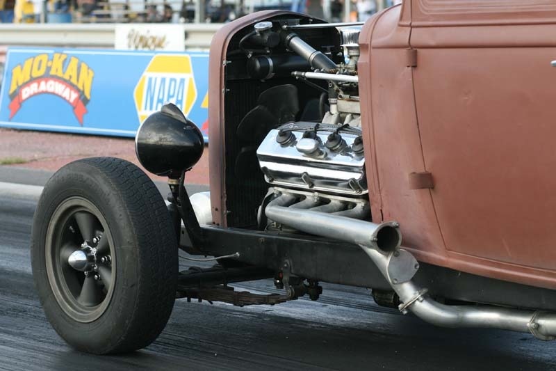

  15. Pics From our hamb brother Kerry.
    From your description it sounds like yours is opposite - 4 leafs on top of the axle.
    Maybe you can get out of the box a little - put some arch back into the spring and then put the axle on top.
    I really wish you'd post a picture of your set up. If A deeper drop will give you a scrub line issue how low is it now that you want it even lower.
  16. Gusaroo
    Joined: Dec 19, 2006
    Posts: 285
    Gusaroo
