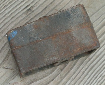

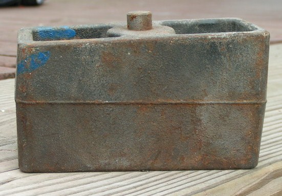

  23. 40chev
    Joined: May 28, 2002
    Posts: 209
    40chev
    Yes and I have a set LOL....I bought these about 15 plus years ago, they are steel and are angled to correct the driveshaft geometry......Below is a couple of pics of the blocks I have.....I purchased them from a 4X4 shop for trucks but they work for cars just as well...
