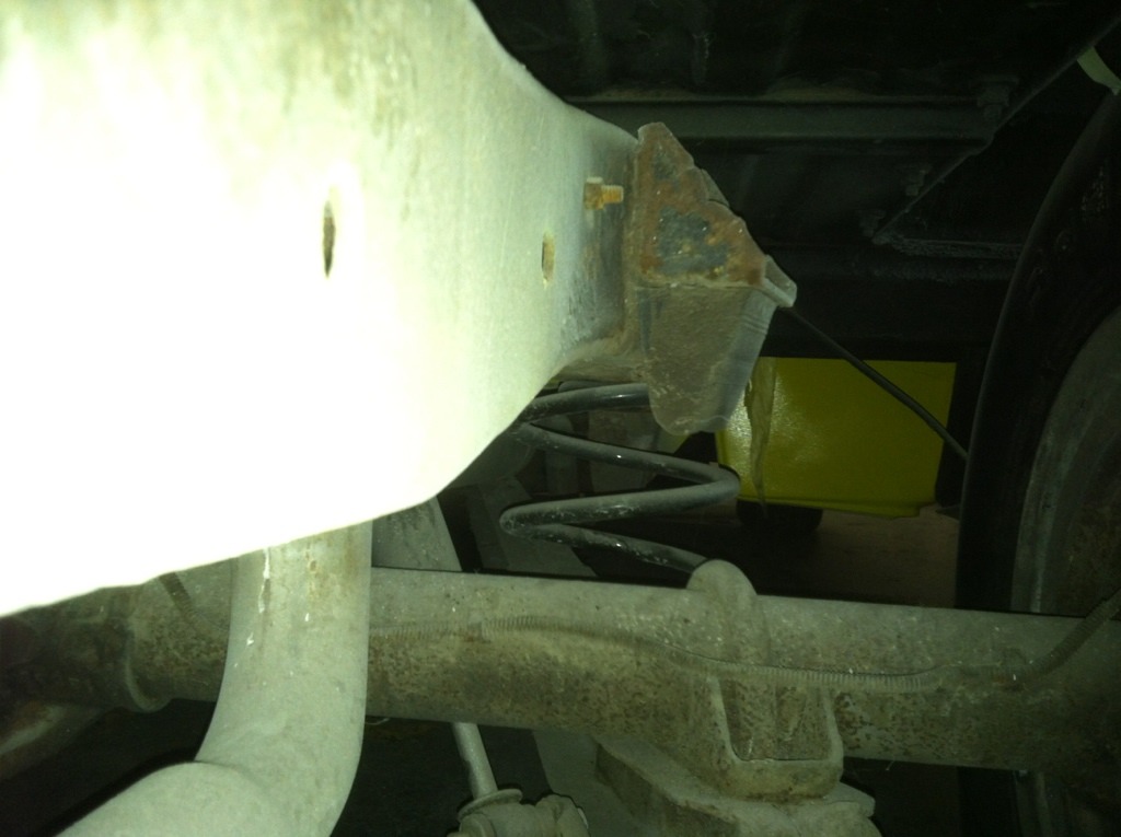

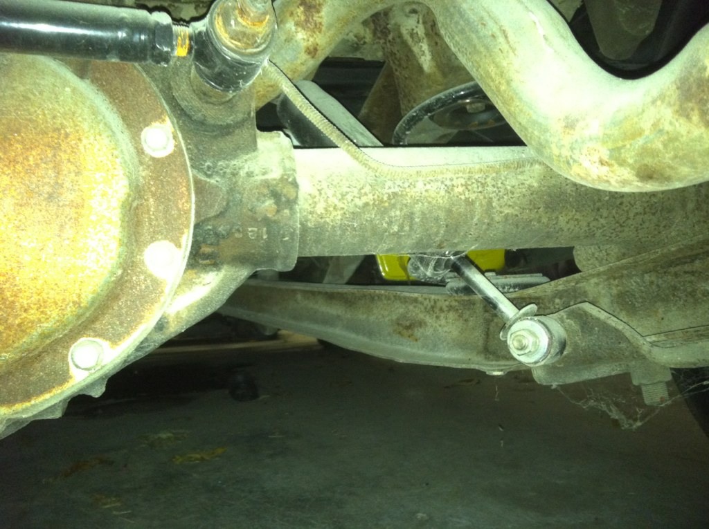

  4. i've had many 67 to 72 c10s. same rear suspension for the most part. the yj jeep coils are tempting because they are cheap at about any 4x4 shop, but, if your planning on putting anything but sailboat fuel in the bed of your truck, it's a bad idea. if you go with the 4" spring as planned your going to need an adjustable track arm to move your rear end back into place. your also going to need a shock relocater kit. when you lower the rear the shocks are at a hard angle. all this stuff is pretty cheap. i'll post pics from my phone in a sec.
    1Nimrod likes this.
  5. This my current 72. No 7 so far. This has 4 in springs does not bottom out. I've got the adjustable track relocater but no shock relocater kit. If you look hard you can see how much of an angle they are at. Rides bouncy in the rear because the shocks can't do they're job ImageUploadedByTJJ1348020270.649067.jpg ImageUploadedByTJJ1348020288.260228.jpg ImageUploadedByTJJ1348020308.710536.jpg

  7. by the way those are lowering shocks that came with the kit. cut one coil off the front and you'll be about 2" lower and your stock shocks will be fine.

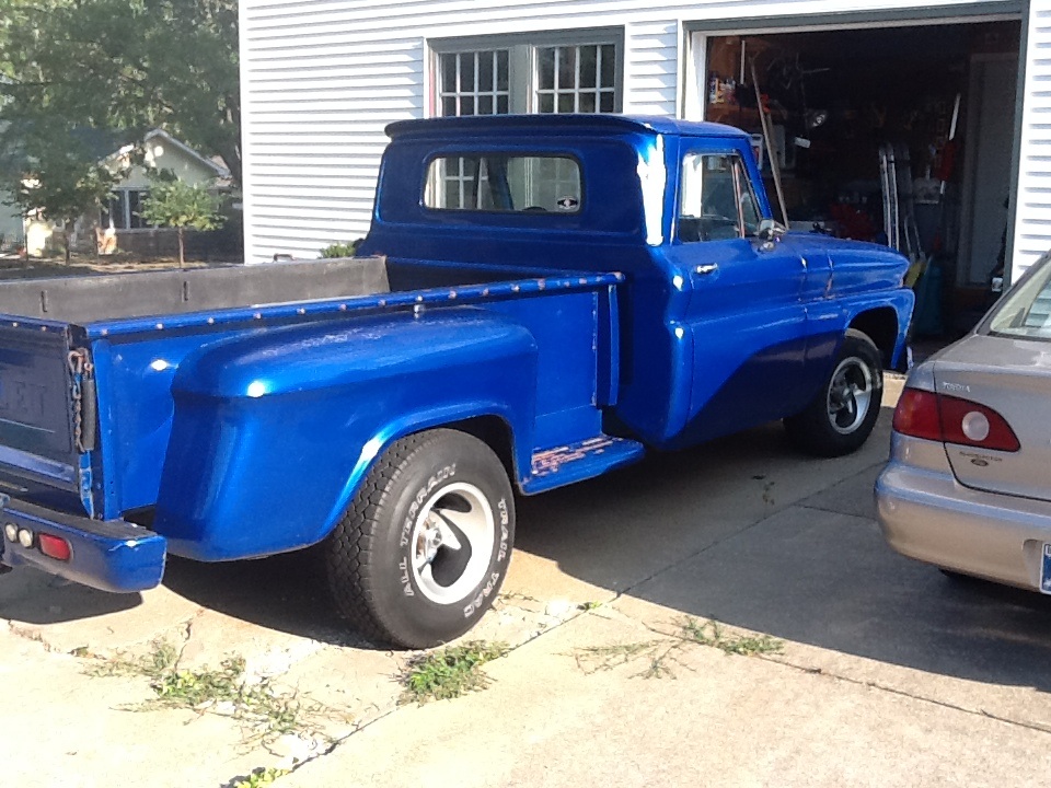

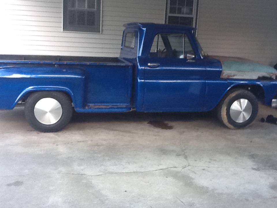

    Just finished lowering the truck! Went super smooth only had to cut one bolt off! 4" drop springs in the rear, and cut about coil and a half from the front, rides better than it did! Fender to ground in rear went from32" from ground to about 26 1/2 , front went from 31 to 26', love it! And went and picked up a new fridge so I can still haul stuff. Will get some pics on In the morning! Next stop body work! Unwrapped the hammer kit tonight!

  13. EasyBake
    Joined: Jun 13, 2010
    Posts: 141
    EasyBake
    from Bedford IN
    Before and after
    1Nimrod likes this.
  14. EasyBake
    Posts: 141
    EasyBake
    from Bedford IN
    During just the rear lowered
    1Nimrod likes this.
