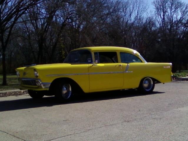

    im looking for a few different ways i could get my 56 to sit lower ,,, with just a static drop ,, no air ride for me ,,, ??
    i could use a little help ,,, heres a picture of what it sits like now ,,, and one of what i want it to sit like thank

    4 inch blocks in the rear
    jamco lowered coil springs for the front....
    I don't think you can get it as low as the pic and still drive it...meaning with out raising it up with bags before you drive it...
    I lowered by 55 Pontiac this way...and it's as low as you can go...my driveshaft hits the floor with 4 ppl in it...

    it has 3 inch bloks in the rear and cut coils up front ,, i guess i just want it a little lower in the front really ,, i would be happy with that

    You can install dropped spindles with your cut springs or lowering springs and you should get a lower drop.

    There it is. Cut the front coils some more.
    NOTE: cut a half a coil at a time.
    ENJOY!!!

    thanks i has cut srings up front now ,, and on a big bump it will bang up front a little ,,, i guess im going to have to go with the spindles and lowered springs ,,, i was just trying to save some money ,, it has disc brakes up front with 11 inch rotors and the spindles i found are for smaller rotors ,,, guess ill have to change thoose also ,,,

    Cut out another coil. May have to remove the bump stop, but at least it will look cool. I helped a buddy lower this one several years ago. We used a 4" block in the rear and cut 2 (maybe 2 1/2) coils out of the front. No drop spindles or anything like that were changed. I know the wheels aren't to your taste, but at least it gives an idea of the ride height.

    Step your lower control arms like this:[​IMG]
  13. Putting a front bumper on it should get it down a bit. If it's not enough just cut the coils untill is sit where you want it! 1/2 a ring at a time or you'll end with it sitting on the frame!

    I use to have, Wait! I still have my front bumper. The height is perfect, just needs wheels to give that, how do I say it? Like mine ;):D Lol. Like some others said, just cut 1/2 coils till you get it where you want it up front. Out back try pulling leafs out before going to a taller lowering block.

    What is the lowest point (inches from the ground) up front of your car? By lowering 2" more, that is how much less ground clearance you are left with. If your ride has one wrap cut from the coils (roughly 2" drop) adding another 2" via a stepped control arm or spindle drop is your option to maintain a civil ride. Has the shocks been changed to shorter ones? With the arm/spindle change, the length of shock is unaffected.

    [​IMG] Here is an A-arm finished. 2". I have driven my '61 for 3= years with this mod. Solid. A pro can have it done quickly. Do the bushing and such, if they are older, for a vastly improved ride.
