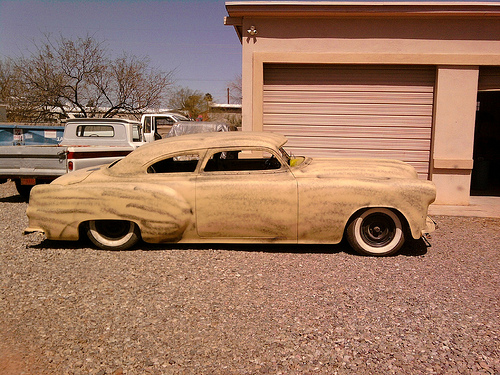

    hi i had a question for the suspension gurus, i have a 1954 pontiac and i wanted to lower the front end on it. it has already been lowered in the rear by the previous owner and had at one point a bag setup in the rear. my question is would it be possible to swap the uprights, as in flip them over and switch sides? i know it will affect camber and caster but i can correct that just curious if anyone has done it on a potiac and if they have pics possible. any info would help and sorry if this is posted in the wrong spot. Ray

    the whitewalls that were on it were radials i have since swapped them with g-78 15s.

    thanks man, the body and paint was done at bsg customs here in tucson. i got the car in trade for a 55 chevy i had, they had dumped the motor and tranny and pulled them so i made mounts for a sbc and auto to fit in there untill i can locate a pontiac mill to replace that. alot of stuff that i need to redo that previous owners fouled up.

    thanks oldsrocket, thats actually the car i have in those pics, its only low there cause it has some lower profile radials on it. i will check the diameter of the mounting bolts/bushings and see what they are and go from there. the new tires i have on it put it up way high in the front end, may have to modify the lower control arms and make it work that way until i have enough money to give fatmans for a set of uprights.
