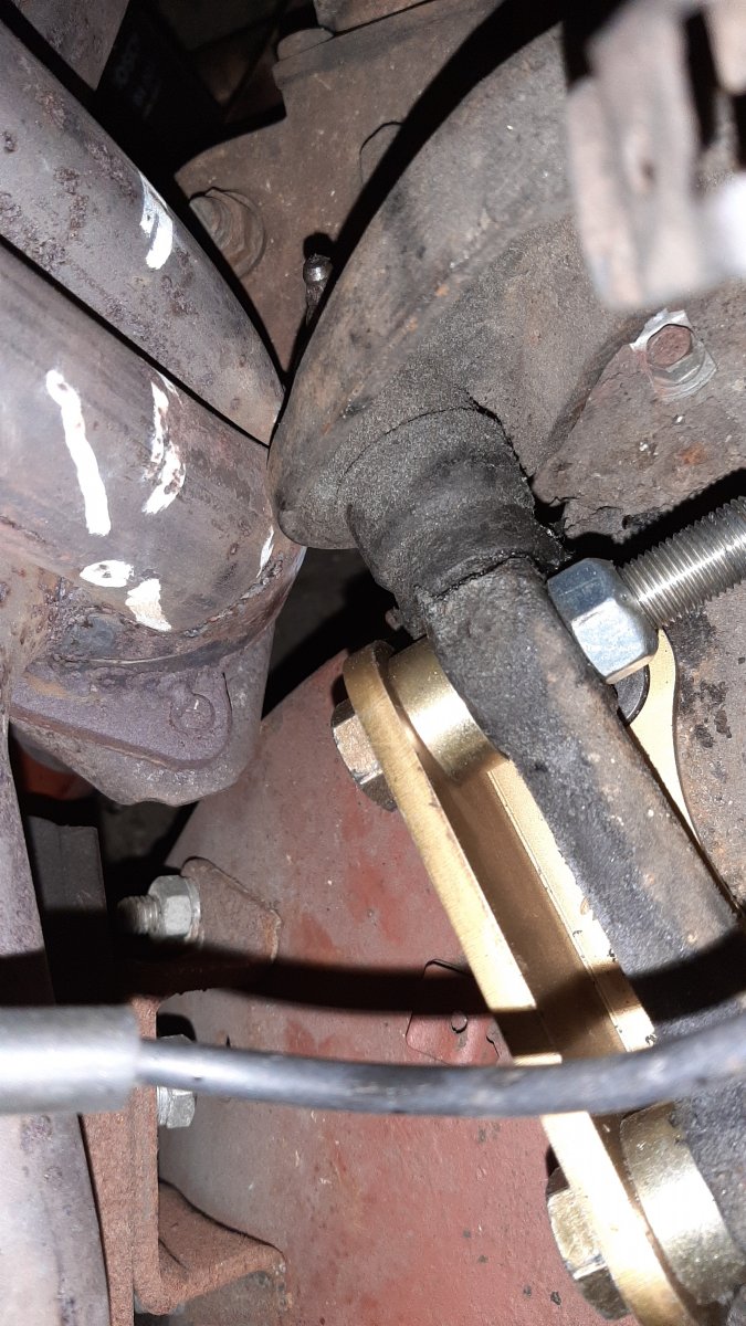

    I installed the lowered uprights from shoebox central, but now my exhaustmanifold hits the front end suspension. It has a 350 built in.
    I am planning to grinding off some metal from the suspension. Any better solutions?

    Lowered uprights should have nothing to do with exhaust hitting the suspension. The control arms don't move from their original position. I'd say you have something else going on or they hit before and this is the first time you noticed it.

    Thanks for the quick reply. My English is not that good. So maybe I am using the wrong words and hopefully these pictures make sense. Now you see whats hitting the manifold.

  8. I suspect you have a fractured control arm. It's moved back and it is up against your front pipe. Pull the upper arm out and closely examine it. In your picture it looks fractured but maybe I'm seeing shadows.

    It was a lot of work to get this engine in (and keeping the original steering in place). Not much room there. And I am glad it's finally in place and works excellent. I already drove it for a year of two.
    I just installed the lowered upright last week and I am happy with the looks. But there was too much vibration when I started the engine, especially on the steeringwheel. I thought I hit the steering arms somewere. but I didn't. I just noticed this thing hitting the manifold is the problem.
    Now I am wondering how much I can grind off of that without getting any (safety) problems

    I believe the control arm is in good shape. It's because of this camber correction kit that it raised a bit.

    It does look like the a arm bushings might be worn out. They are nowhere near being concentric with the trunnion.

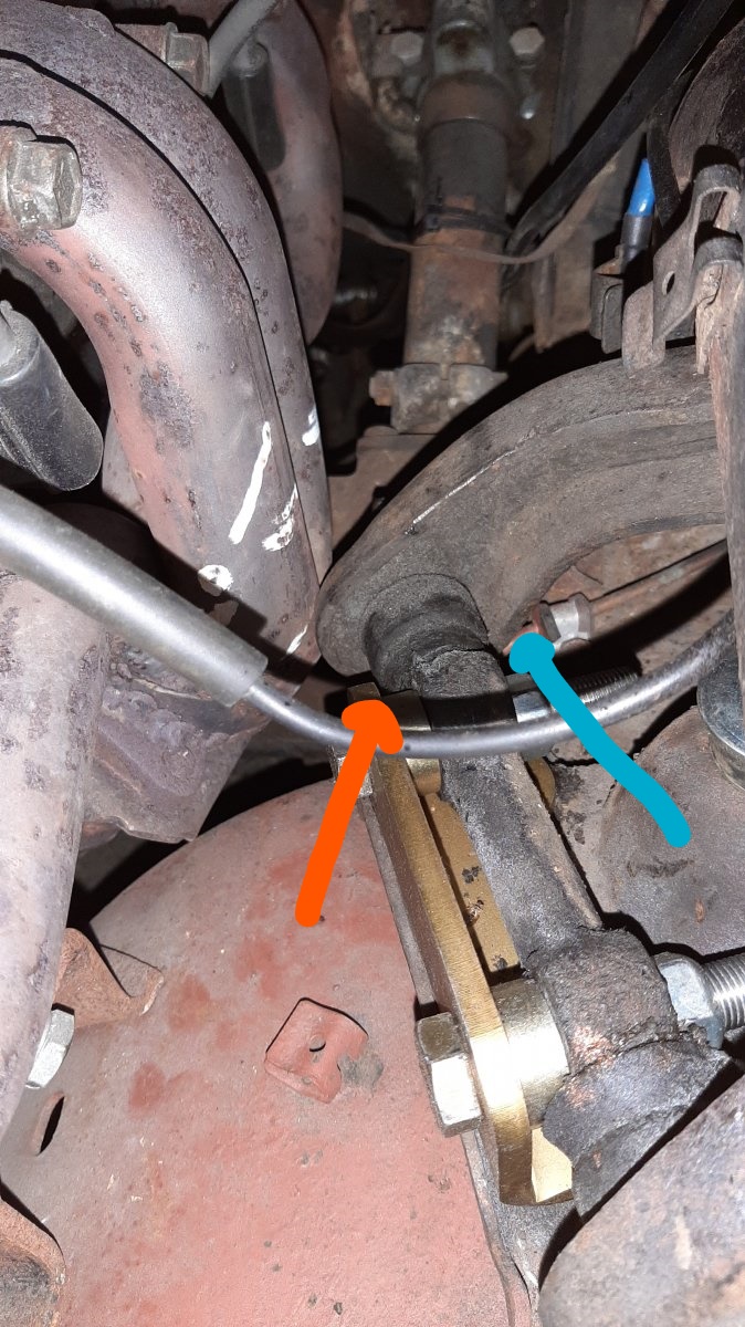

    There is something going on with that control arm either the bushing is worn out or the the bushing and shaft are worn out. look how far off center the shaft is in the bushing. Orange arrow showing that it is offset to the inside, blue arrow showing how far it has moved. That alone is throwing your caster/camber off. If you look at the other end of the shaft the bushing isn't worn as much and the shaft is more centered in the bushing. Control arm_LI.jpg

    Thanks mr48chevy, I'll look in to that. I looked at the other side and it was indeed more centered.

    New shafts and bushings aren't very expensive from Shoebox Central https://shoebox-central.com/1949-1950-1951-1952-1953-ford-upper-control-arm-shaft-bushing-kit-new They are a bit tricky to install until you get the hang of it and on that car need to be greased fairly often. Stock shoebox Fords when new got greased every thousand miles and now that doesn't get done as timely as it should. I'd take a look at the lower control arm bushings and the rest of the wear parts while I was at it. You don't want to replace one thing, then find out you have more worn out parts in a few months.

    The rubber pieces work as seals, the "bushings" screw into the A arm while screwing onto the shaft.

    I believe I see a fracture as well. It may be grease. It sure looks broken.
