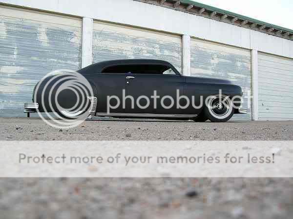

  9. tankwilson
    Joined: Oct 12, 2004
    Posts: 1,161
    tankwilson
    I like that car. See how the bumper is as low as the rest of the car. Can i do that or is my car just not right for that????

  22. Jeem
    Joined: Sep 12, 2002
    Posts: 5,882
    Jeem
    Alliance Vendor
    Depends on your priorities....
    Do you want ALL the sheetmetal to lay on the ground?
    OR
    Do you want something with decent proportions?
    Tuck the bumpers IN a bit, but not DOWN.
  23. skirts would look rad on that car. suck the bumpers in. not down.
  24. blown49
    Joined: Jul 25, 2004
    Posts: 2,212
    blown49
    I welded 2" x 3/8" flat stock on the top my Merc front bumper frame hangers and drilled the mounting holes in the flat stock; then just bolted them on. Dropped it about 1" to 1-1/4". Top of front bumper is about 1/2" above the pan.

  27. tankwilson
    Posts: 1,161
    tankwilson
    I think your right. I just took a look at her on the ground and the bumper doesn't look that bad. Will probably lower it some but not much.
