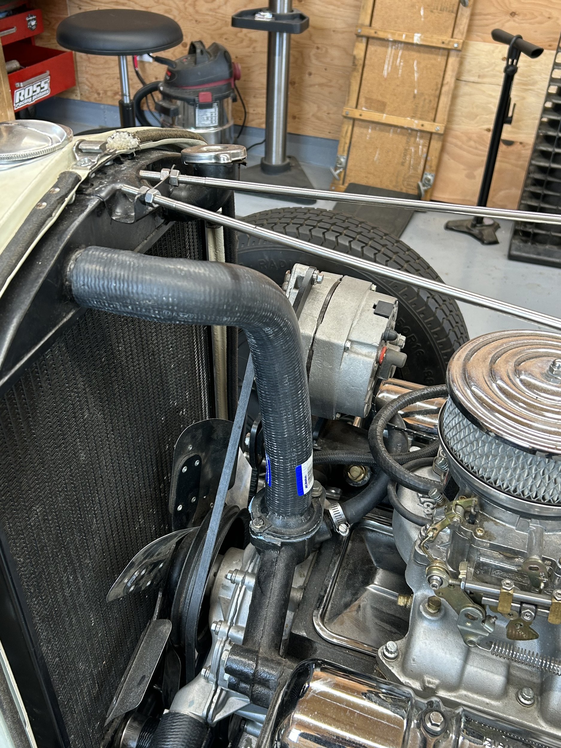

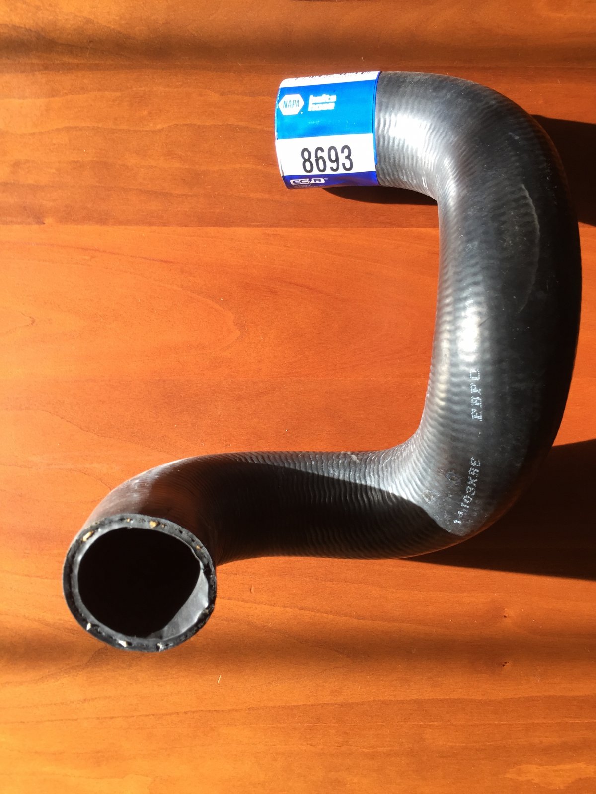

  18. The upper hose is gates 22484 with a few inches trimmed off the left side of the image
    The lower hose is Gates 22006 with the one of the 90 degree bends trimmed off on the right

    Eureka! Time to go shopping for that lower hose. Thanks!

    Eric, thanks a lot for the information. And thanks to the young kid at O'Rielly's as well.
    This is great information for anyone using a Nailhead in a earlier chassis.
    Thanks again on behalf of all Nailhead users.

    The Gates #22006 is known as an NBH #8693 in NAPA speak. It is manufactured by Gates for NAPA Auto Parts. Window sticker is about $15.00
