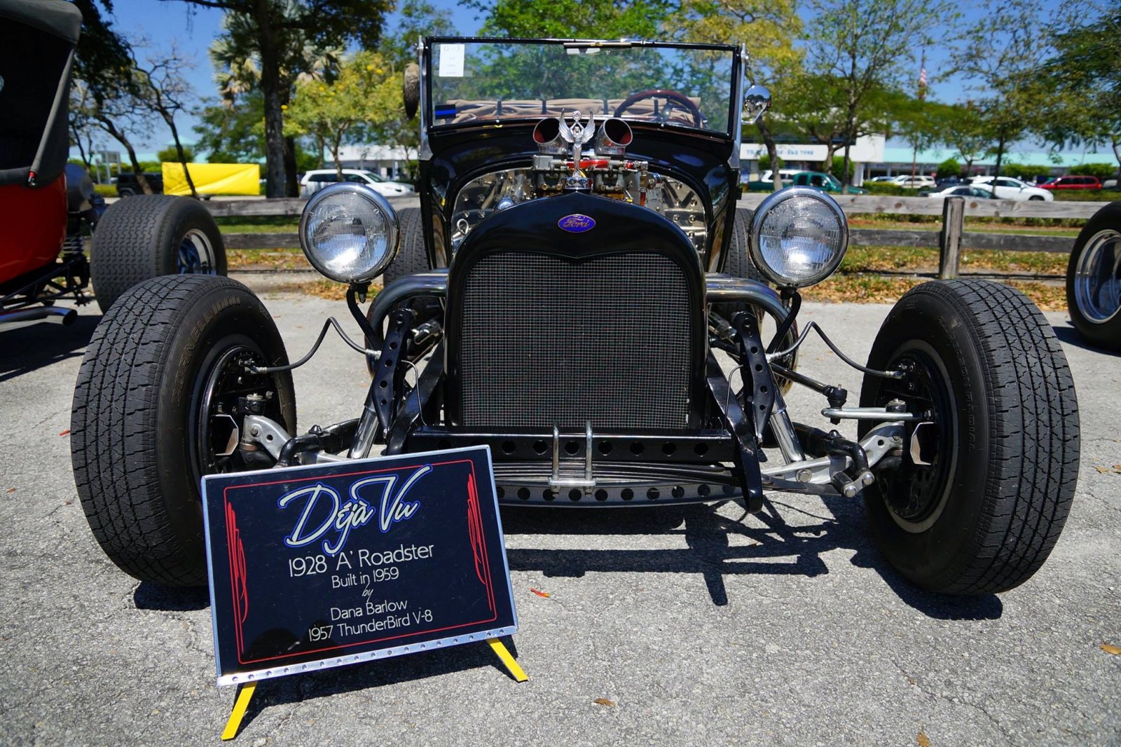

    1. Y-blocks
    Shells can be cut. My 28 A shell is cut, I slide bottom up inside top.
    I'm about 3in. short from stock hight! I use a T-bucket Rad>fits fine,but not as wide as "A" rad,but "T" size rad is shorter then a stock A. Cut is hiding behind frame,so dose not show.
