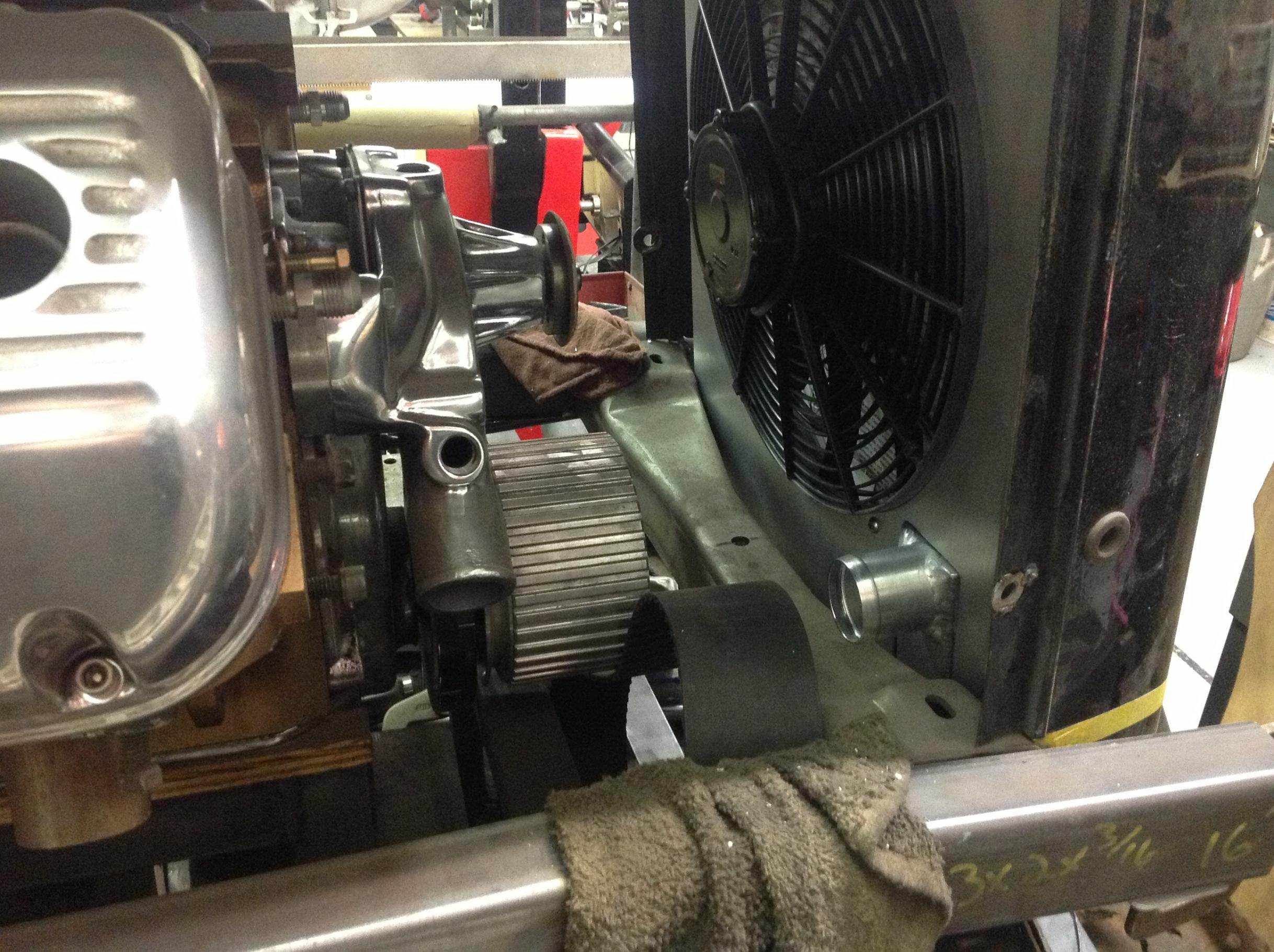

  30. Just revived my custom radiator Friday.
    Its just setting in there right now.
    It was a challenge getting the cooling capacity in the available size space, wheel base and hood with a blown hemi all in the same car. My wallet needed to do the compromising on this one but something's got to give and nothing else could. It's a beautify hand crafted custom radiator with super duty core.
    The bottom of the tank is approximately 6" below the top of the frame. After gathering opinions from several different sources, there was no way a 6" chopped radiator would be able to cool that engine.
