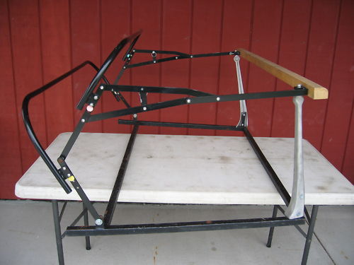

    Bought The Speedway motors universal cab frames:
    Made a plywood piece to fit on the Duvall screen (that is home made as well).
    After lots of massage and patience, I got the style I wanted With the frames still possible to collapse.
    Made a top out of masking tape to check. Did this 3 times before I was satisfied...
    Covered the masking tape top with thick plastic pieces that later became templates to cut out the fabric pieces.
    Got a professional to sew the 3 long seams across the rood, as my old cobblers sewing machine is no good for sewing long straight seams.
    Testing the fitment to check that the seams were following the frame:
    Rear window frame:
    Done!

    The Speedway top is a Kwik Top and they sell it for $495.00
    I bought this one that was listed on e-bay for $295.00 (28-32 but can be adapted to other years)
    It is no longer listed there however they still make them (In the US) and they are of very nice quality for the cost.
    If you want their contact info, just PM me and I will give you an e-mail contact address.
    Edit: Speedway has lowered their price , the steel Kwik Top is now $399 and the stainless steel version is $499.

    The reason I started with the Kwik top is simply thay I didn't have a clue on how top bows should work, dimensions etc. The Kwik Top gave me the starting point that I needed to - well start the work.
    If I should have done the same once more on another car, I would probably just bought some pipes and made the bows, too.
