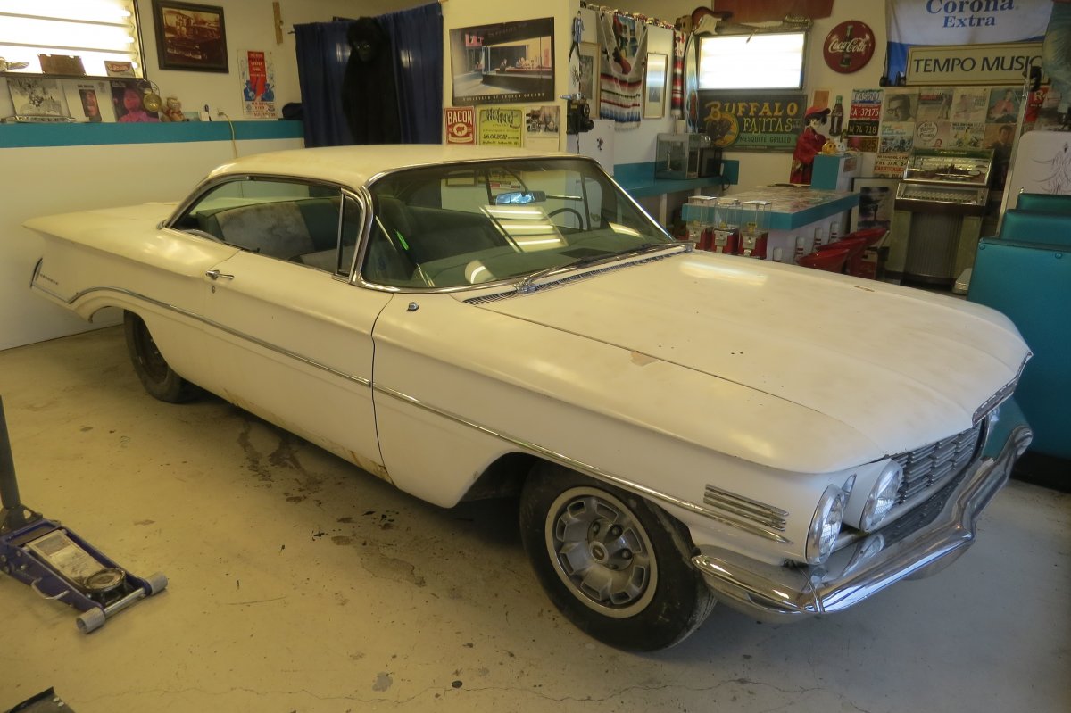

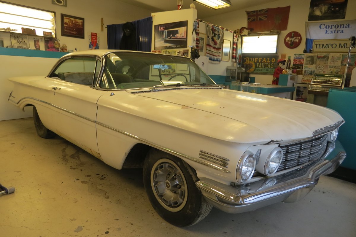

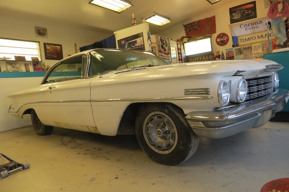

    I just brought her home.
    A complete runner less the radio, master cylinder, trunk lock and battery.
    After I get it running I'll get a better feel for its future but for now, I'm thinking a pretty lean trip between the shop and the road. Time will tell.

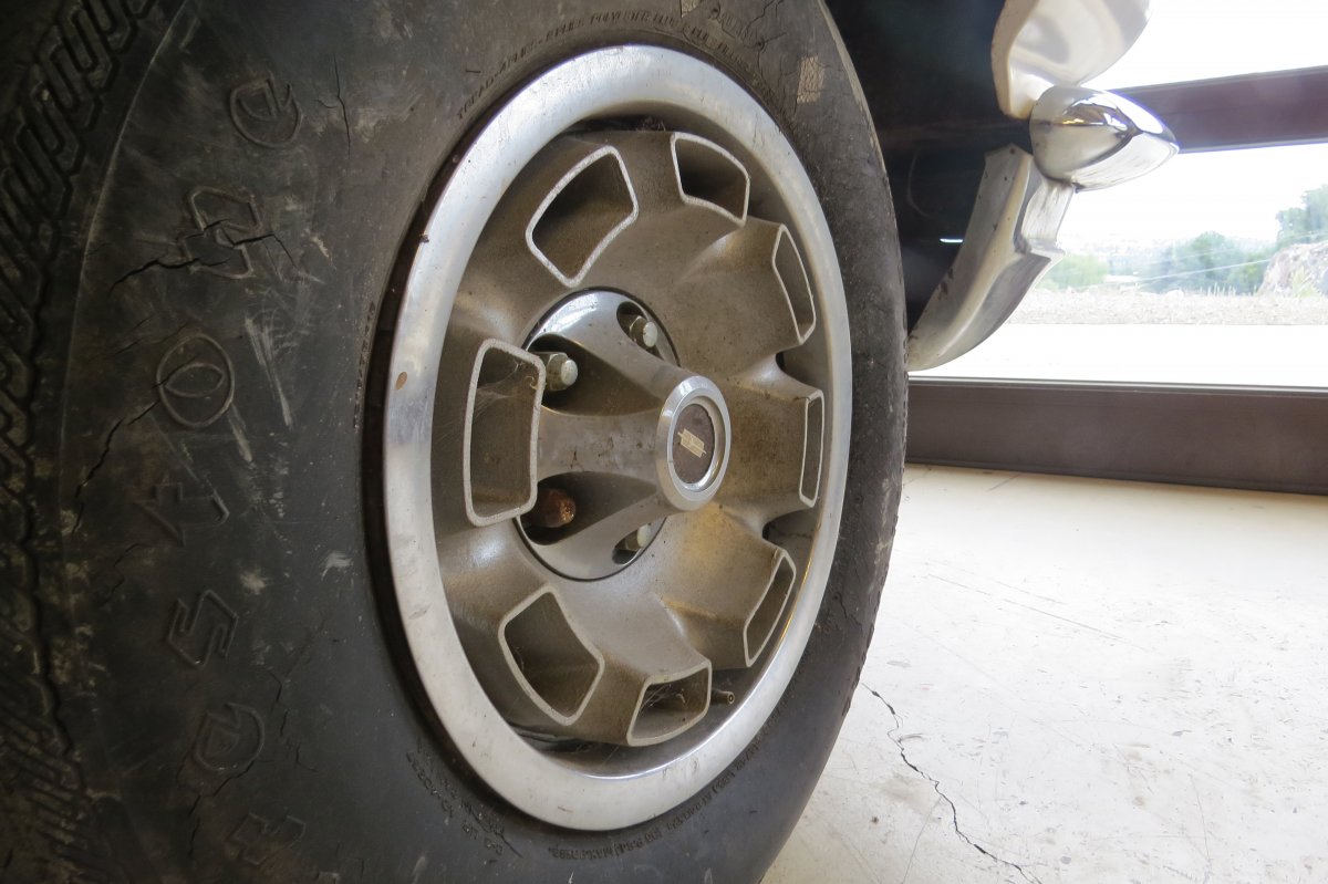

    Perfect glass, floor and trunk repairs and over all just good for its age. Those wheels are a gas, I'm thinking early 70's olds but somehow I can see them working with red lines and spyder caps.. we'll see.
    My never again turned into a squirrel.

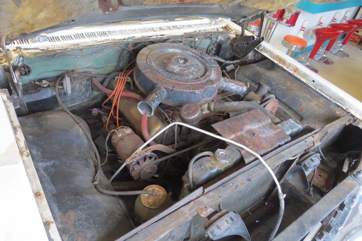

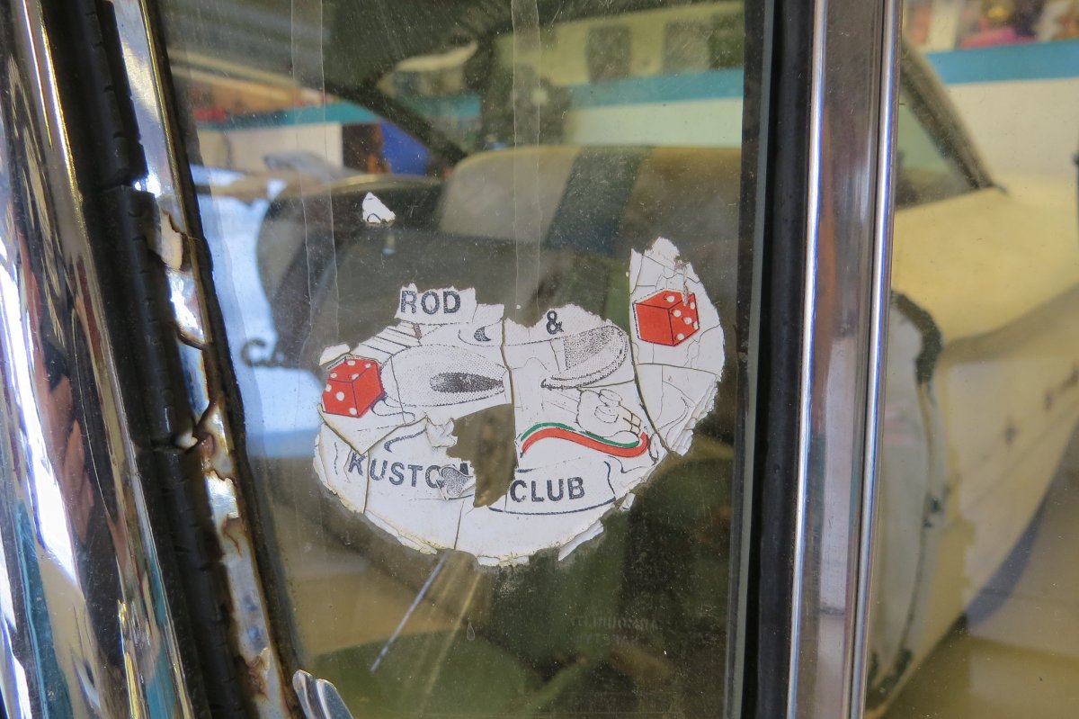

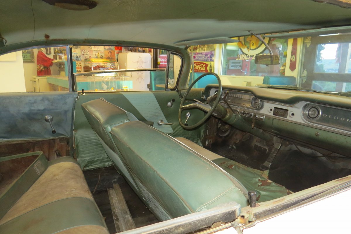

    371, ps,pb. wild period factory old mags from the 70's, some glove compartment goodies,a mystery car club decal and some fun ahead.
    I dont see slamming it but lower profile tires and a bit of a rake, kinda surfer 60's style.

    371 2bbl, ps,pb

    Neat car....love the decal. The wheels are early 70s full sized Olds...like 1971 to 73 or so...I always like them...they fit that cars style well..

    They're not traditional but I agree they have a look that works. Some spyder caps instead and some fresh paint and beauty rings with some red lines... yeah baby.

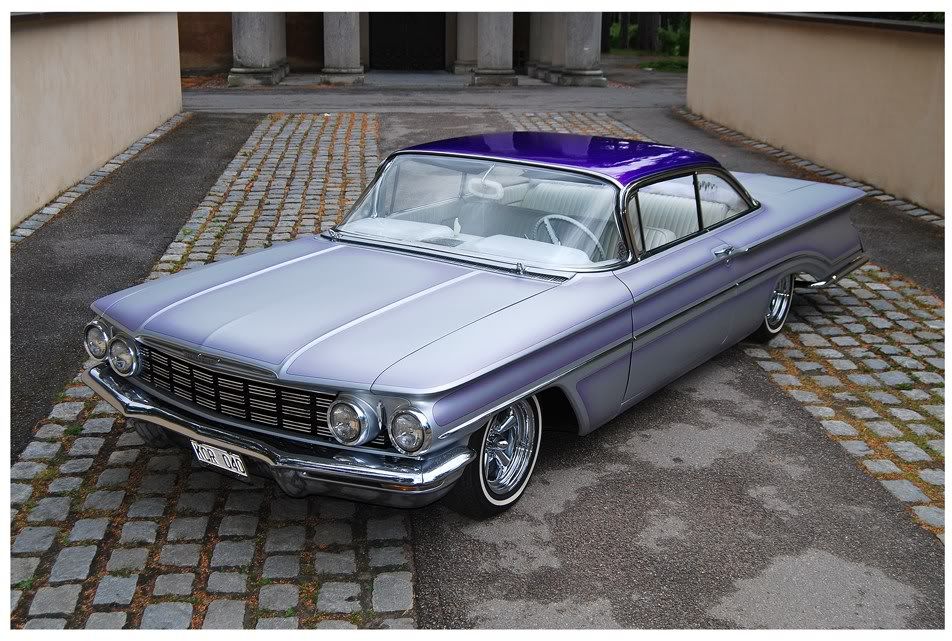

  17. What a great car to turn into a mild Kustom.....please use those provided pics for inspiration...beautiful GM piece right there

    That's a low compression 371, about 8.5:1. You could always change out pistons for 1959 371 pistons and get 30 -40 hp right there. Put a 394 4bbl and intake and you get another 20 hp. Lastly, ditch the DC hydramatic and put a slant pan hydro out of 54-56 Olds.
