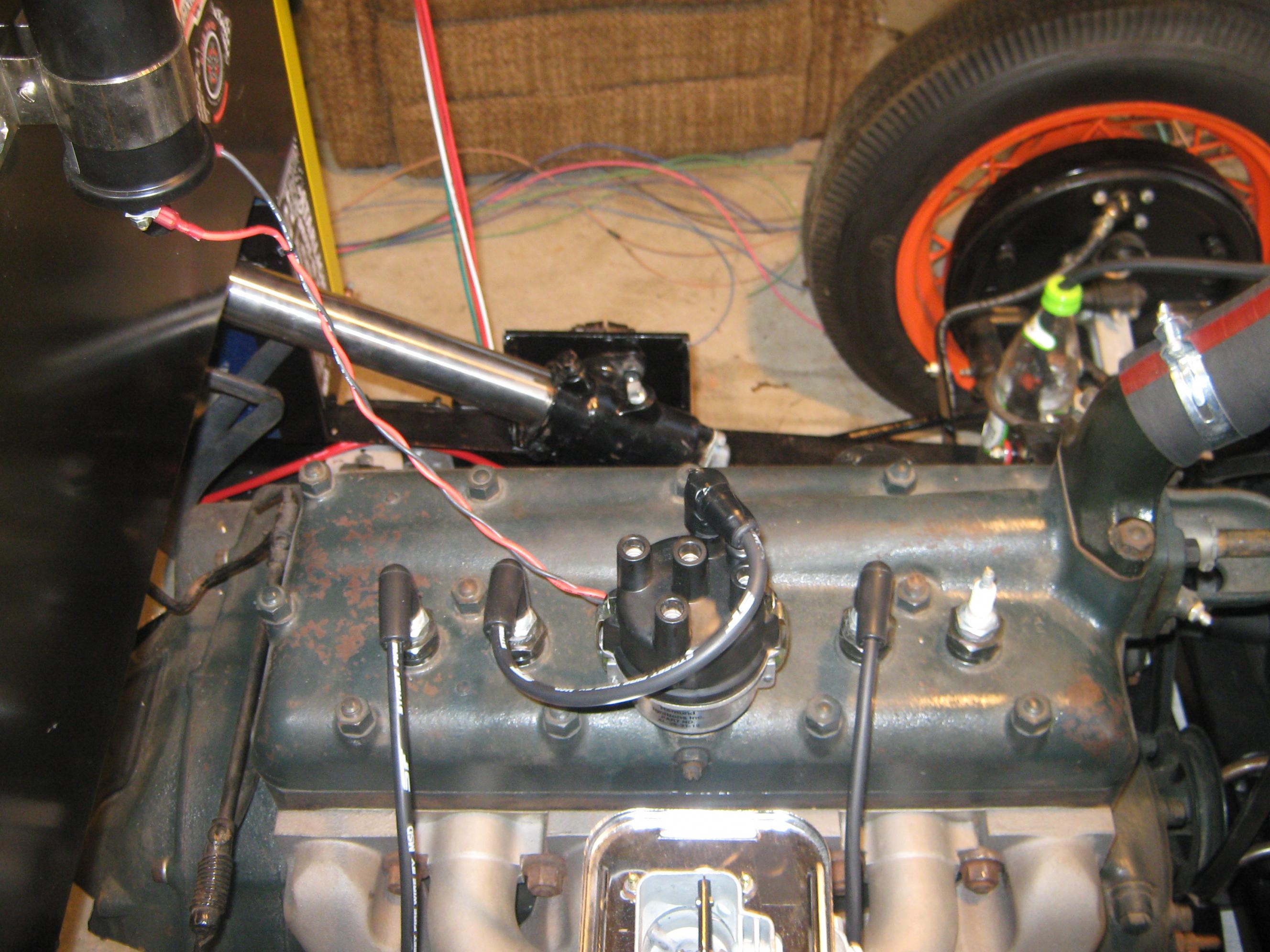

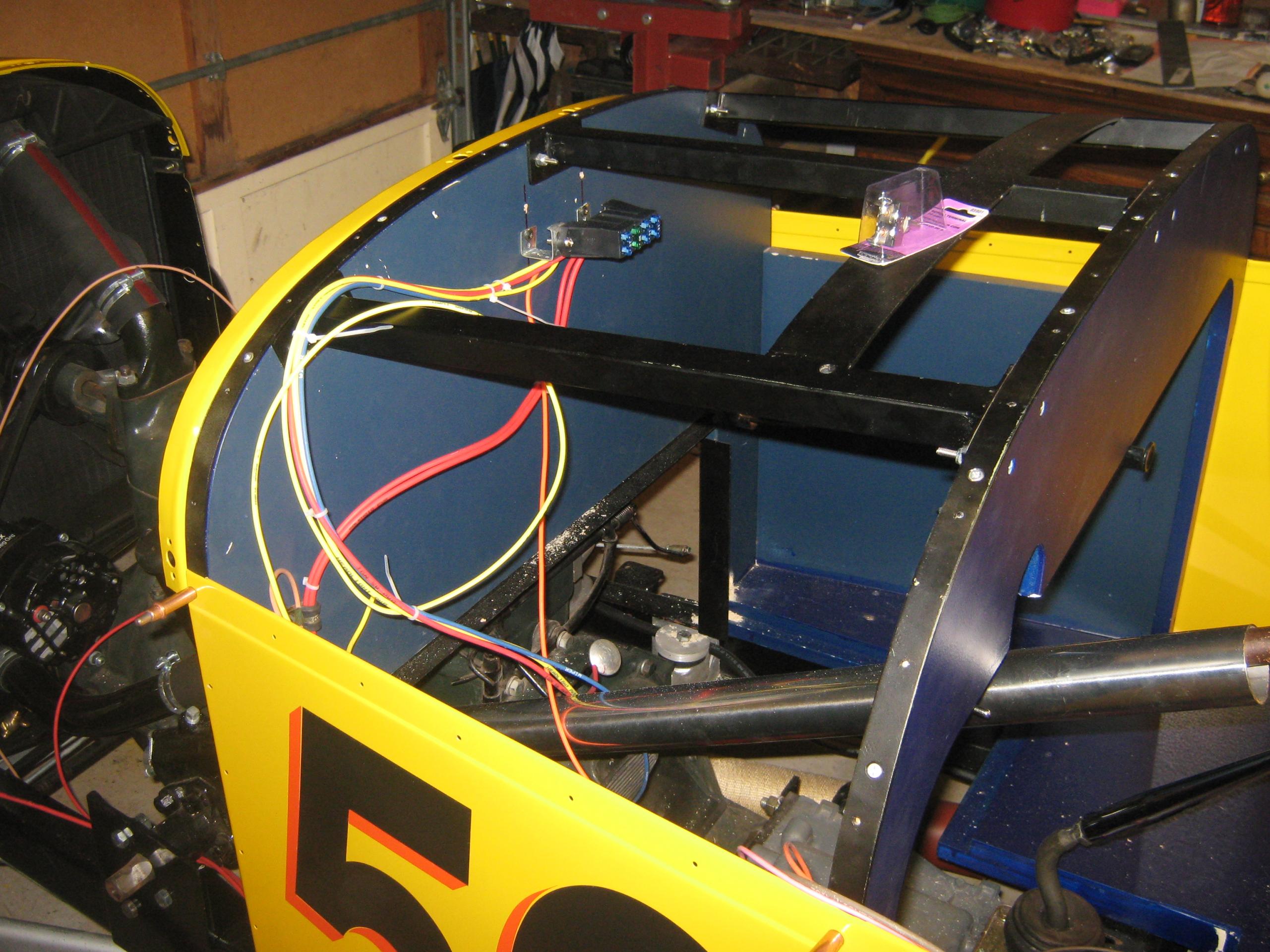

    1. S.F.C.C.
    So I found the old thread on timing- it was a huge help. anyone have any last minute advice before I try and set timing on my banger and get her rolling?
    and dont mind the plug wires- they are done and in the right 1243 order I think- so long as I have the enginr at tdc ( which i think it is)
    but I got the speedster down to 4 fusesd circuits!woot!

    I was thinking about buying an FSI distributor when I come over, does anyone know if these units are reliable or should I just get dual point mallory ?

    I'm running a FSI distributor in mine and I love it. I would definitely recommend it.

    On an A or B engine, you can verify TDC with the pin on the front timing cover.

  25. A timing cover pin hole location is TDC, B timing cover hole is 19 crankshaft degrees BTDC.
