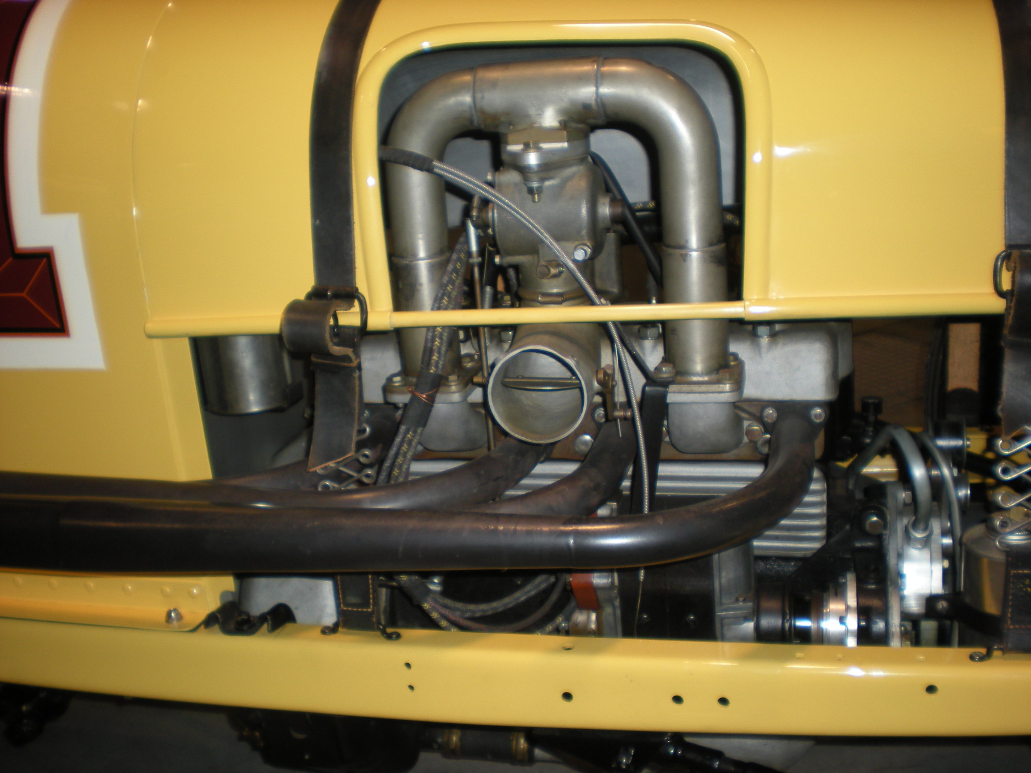

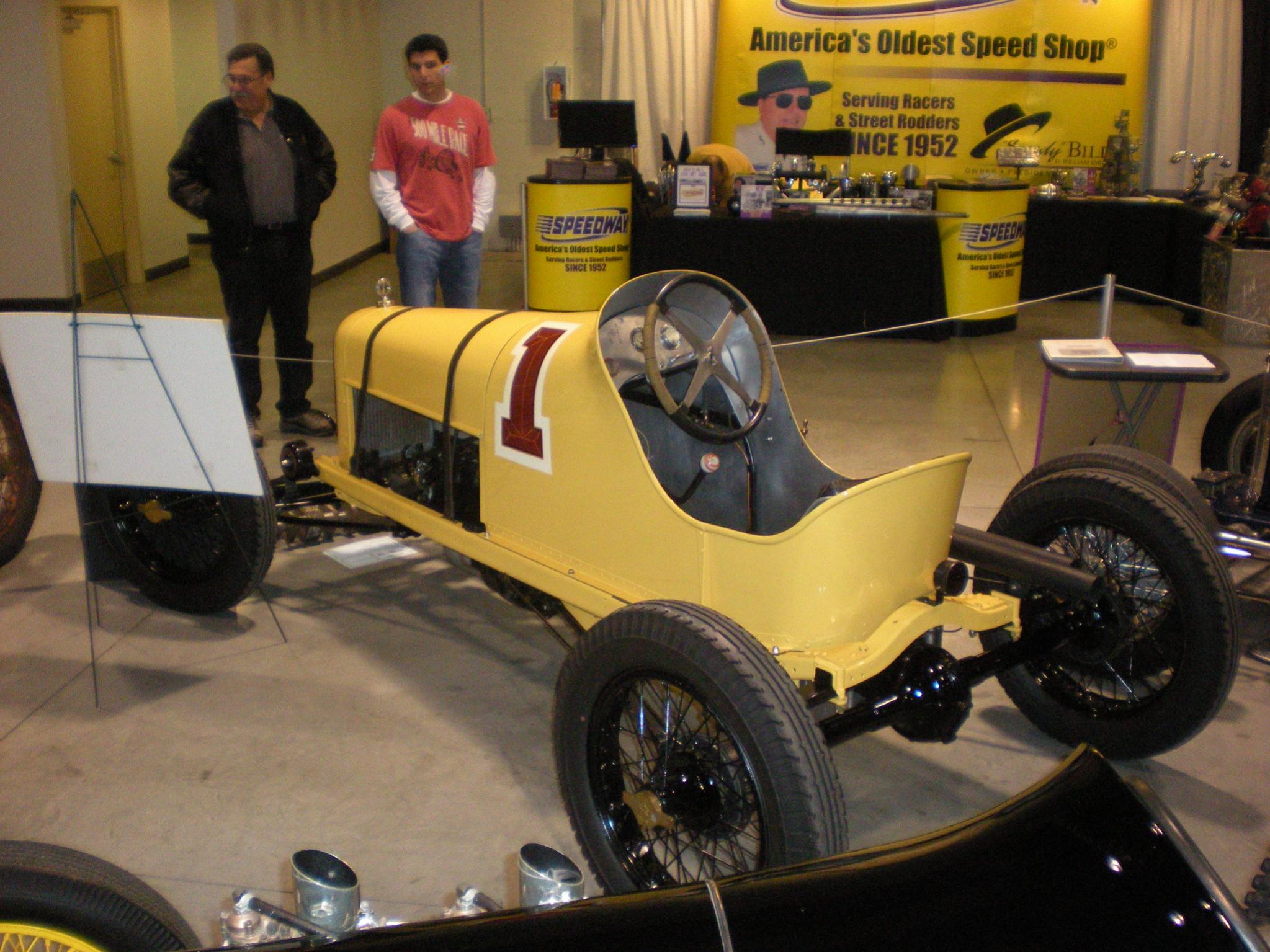

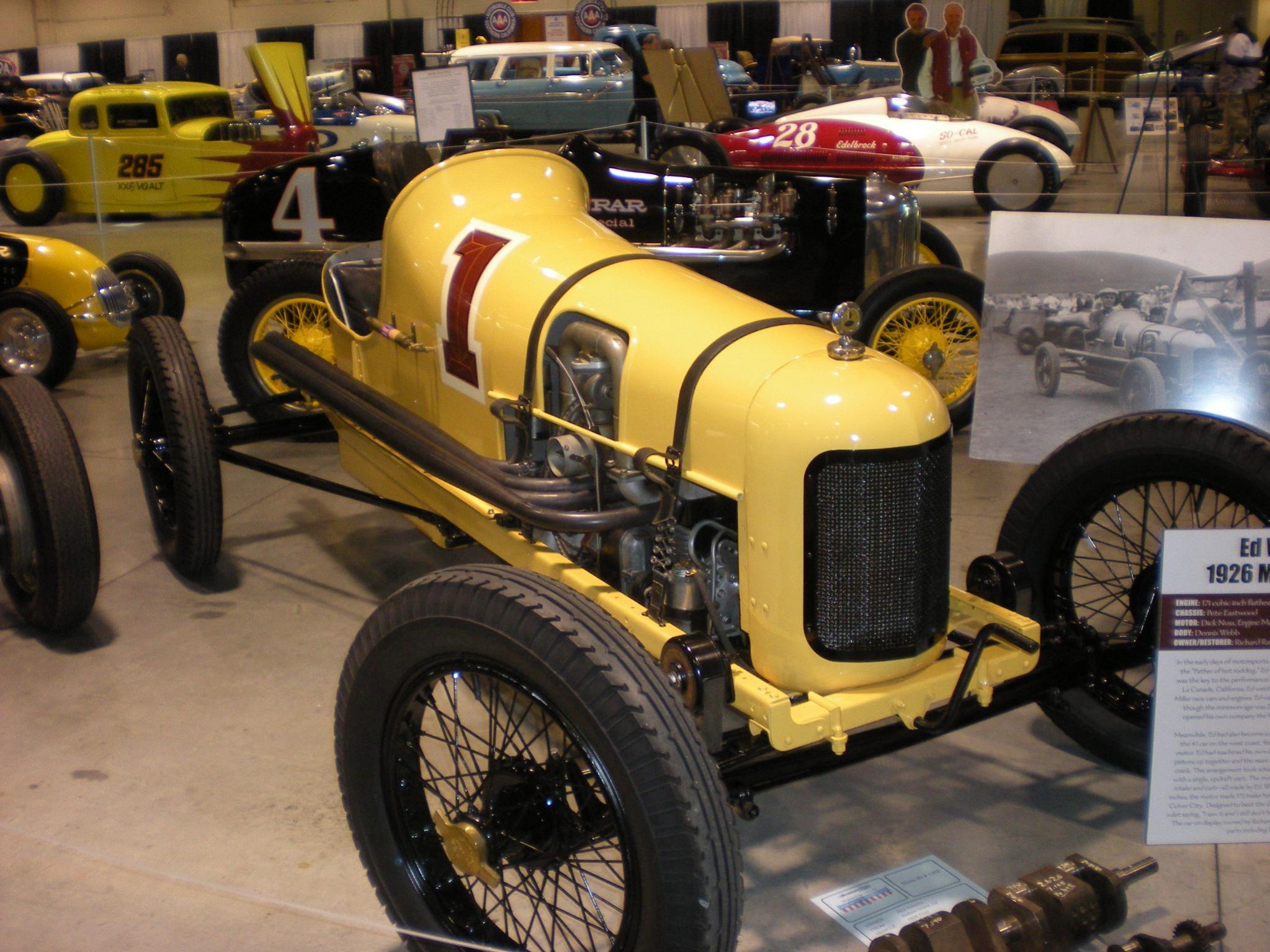

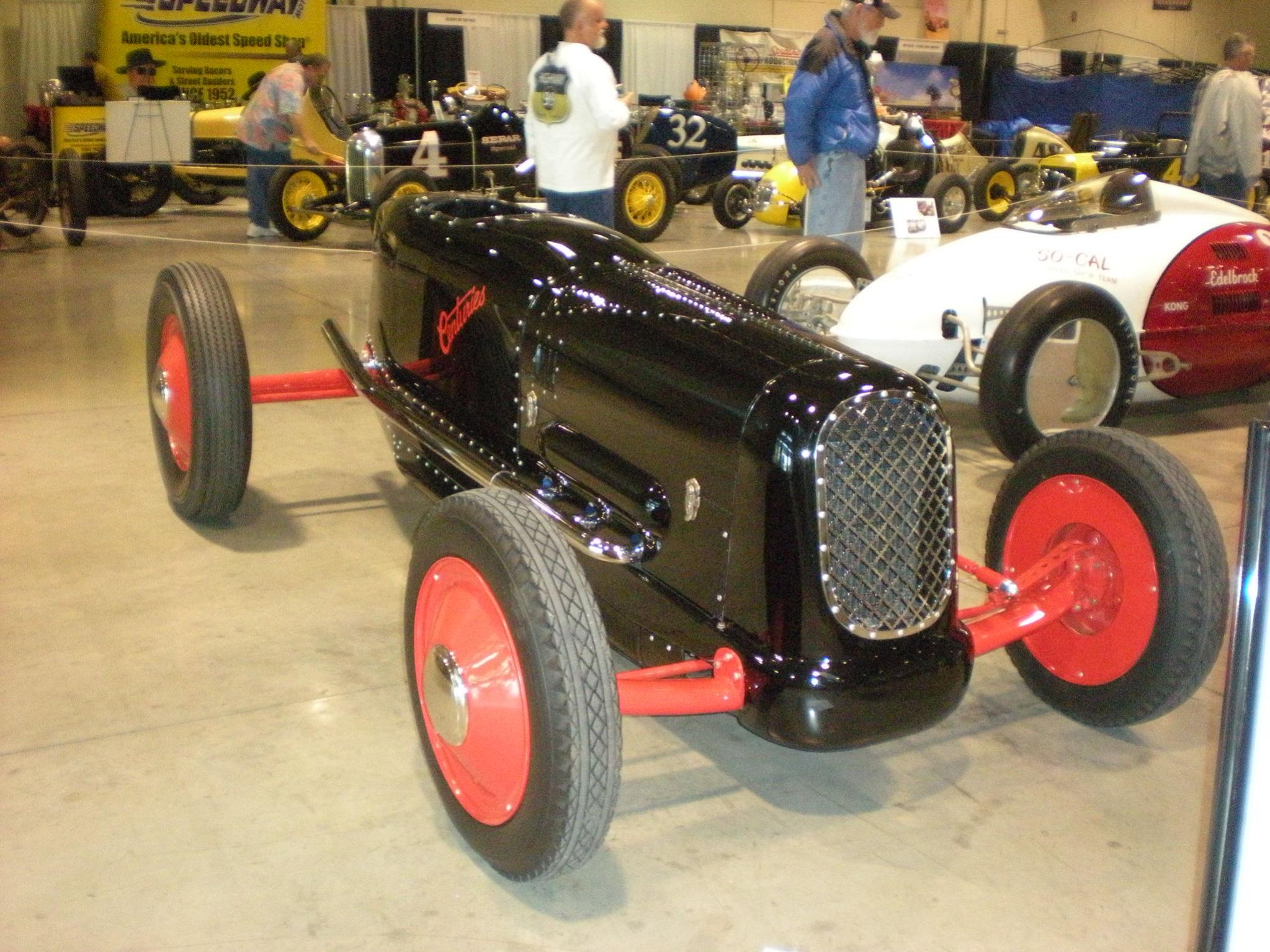

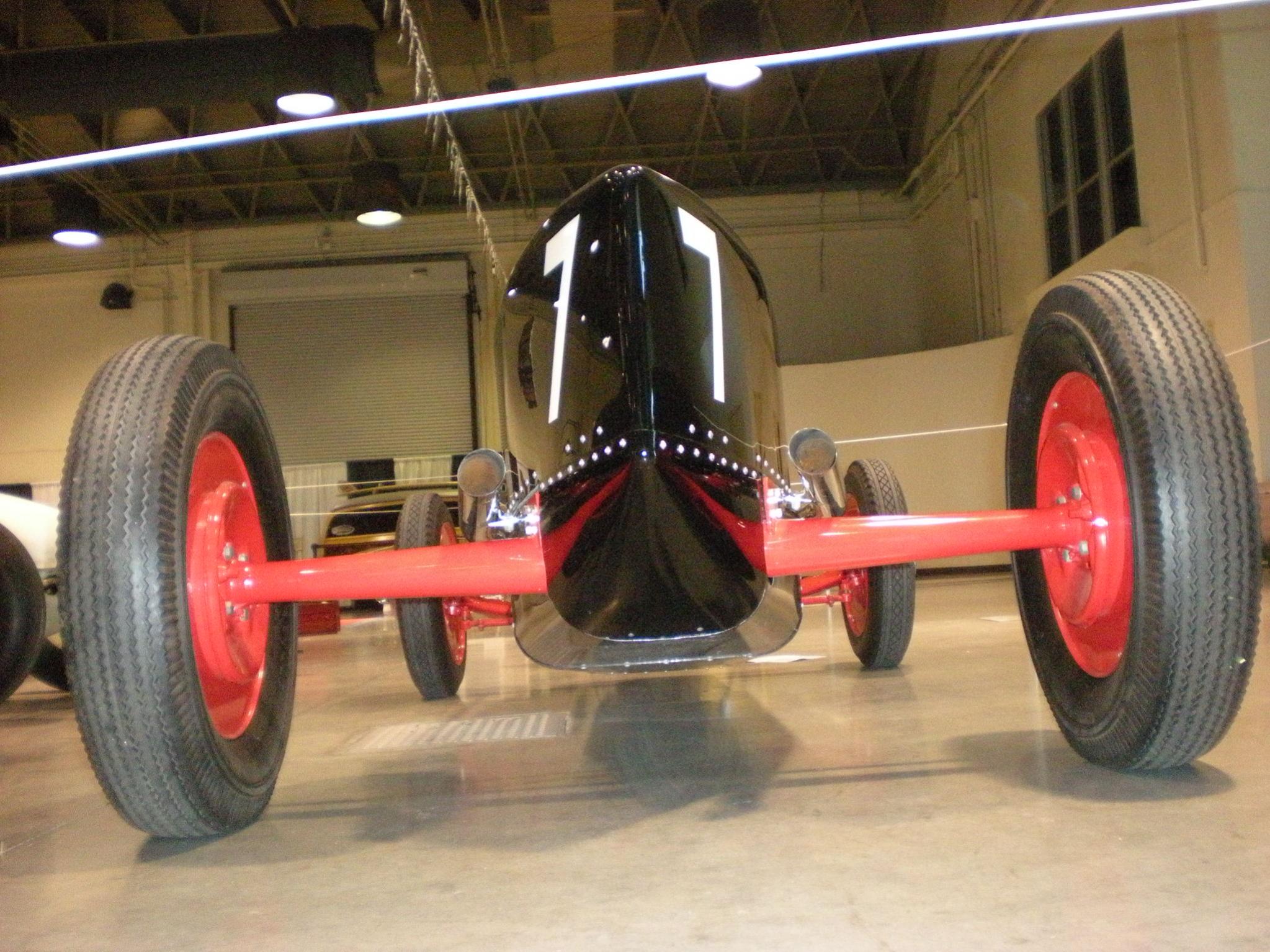

    Here is my favorite bangers from the GNRS this week end. The race car building was bitchin.

  9. Crazyd,
    Thanks for getting some close ups of that sprint and the Winfield "2 up 2 down"- I was hoping someone would!!!

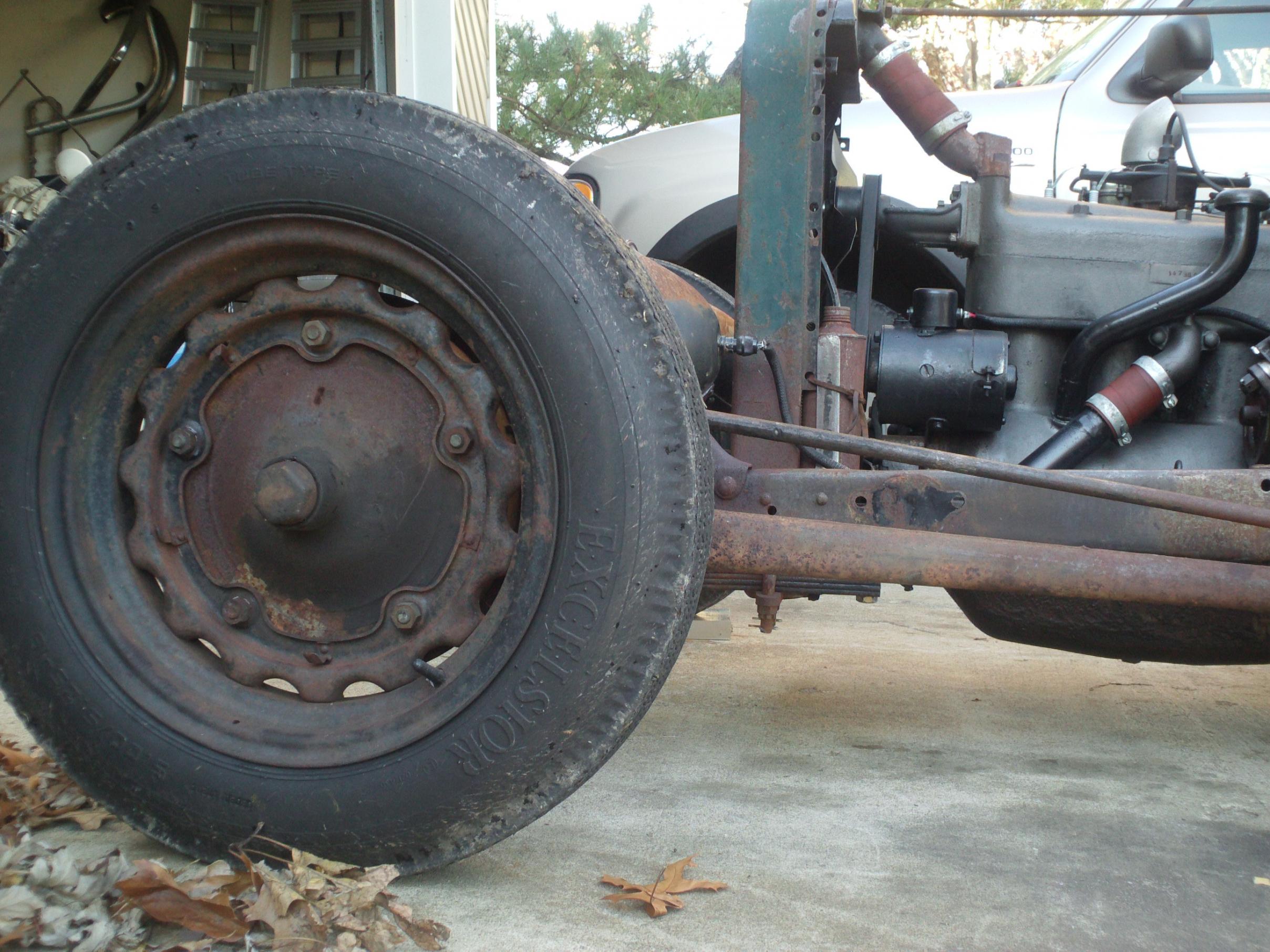

    I dont know if this helps or not, but I needed to change position of my water neck drastically, after cutting it up I got it positioned it and thought I wonder if my mig would bond it enough to keep together, I tacked it lightly and thought man that looks great, so I heated it up and tried it, it welded better than most mild steels, I didnt think it would last long but its been on for almost two years now and shows no signs of leakage. sorry the pic isnt very good.
