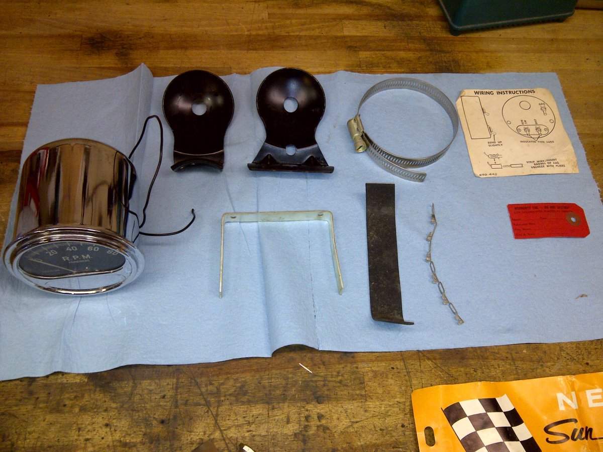

    Glad to see this blog/thread resurrected. I've always liked the simplistic feel of the early Sun tachs. Got lucky and found a NOS one for a 6 cylinder awhile back.

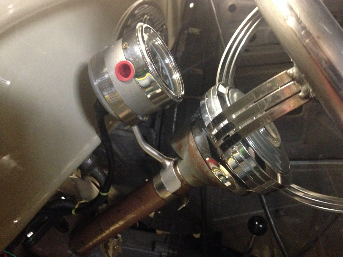

  9. I just picked up this vintage Dixco tach for my 55 Dodge. I dont know much about it but it looked good on the column. Any ideas how to hook up a 2 wire tach?

    Is your Dodge 6 volts or 12? makes a big difference. I make a driver for a tach like that if you're 6 volts positive ground. I believe others make the simpler 12 volt version.
  11. It has been converted to 12v and has a 325 Hemi. I have heard Dixcos didnt need a driver like the Suns. But this is new to me!

    I would expect that is a "meter-type" tach because of the two wires. They usually need a sending unit. Or maybe one or two of the wires have been cut off or pulled out. You might want to take it apart and check.

    Those old Dixco tachs did not have a sender. If it has a green wire that usually connects to the dist(-) side of the coil. the other wire usually black connects to a ground. A third wire would be for a light.
  15. Only two wires... one to the + post on the light and the other to the internal area of the tach.

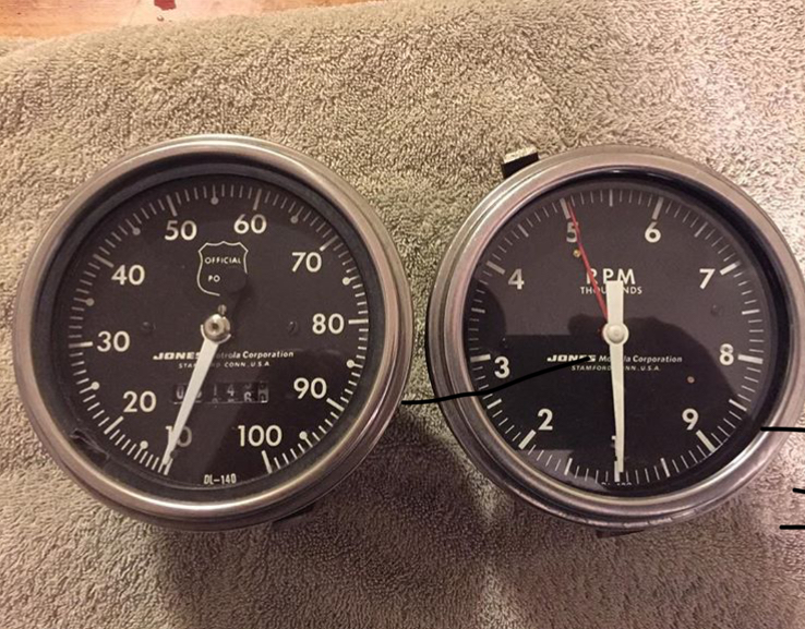

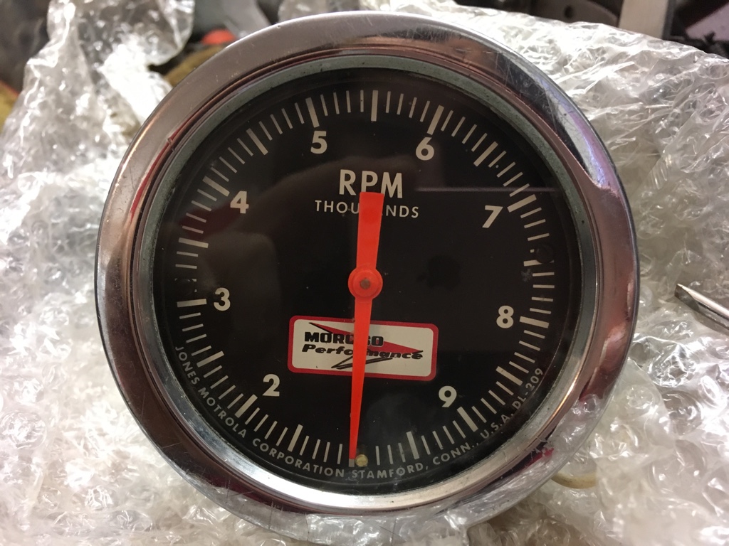

    I’ve seen quite a few 4-1/2” Jones Motorola tacks. But check out the 4-1/2” JM police speedo. Came in it’s original box with zero miles on it
