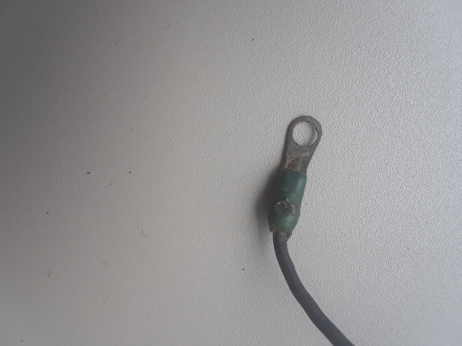

  26. Was just going to add my personal issue I had with a loss of power or ignition - the picture is a factory end that goes to the coil - chased it for awhile until one night I was just watching my motor run and I saw a spark or two to ground from that end. Looked good but was broke down from the years - replaced it and no more coasting to the curb. 20210610_130909.jpg 20210610_130850.jpg
