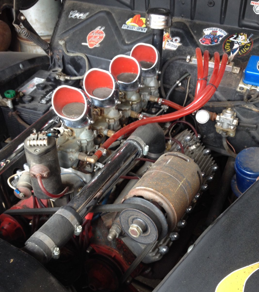

    Are those solid core wires in your picture?
    jimmy six likes this.
