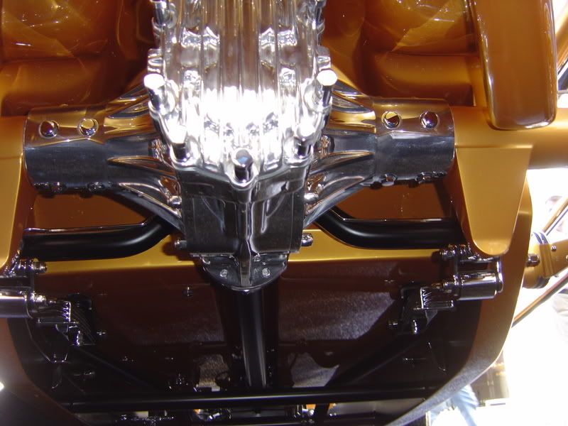

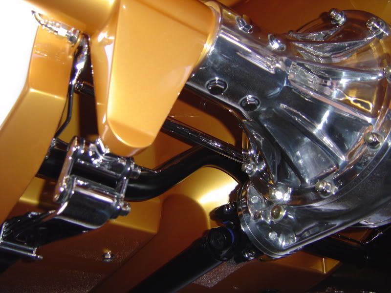

    I'm running Posie's quarter elliptical setup on my '34 truck. I'm using hairpins on it, and the ride is really good. The parts are excellent quality and the ride height is adjustable which makes it nice. The whole package is pretty thin profiled, so it leaves quite a bit of room under the bed.

    wow. that looks killer! do you have anymore pics of how it's attached to the Axle etc?

    I ran a panhard to eliminate the chance of side travel since the rearend is just located with hairpins. You could make some brackets for the rear, but for the money, I just bought speedway's brackets for putting a transverse spring on top of the rearend. The radius on their brackets fits a 3" tube, so I just turned the bracket to face the spring. I used the actual mounting end of the bracket for the link to my friction shock.

    TudorChevy, I like the set up and dig how you are using the Speedway brackets as the friction shock mounts as well...
