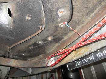

  15. This is just about 10 metres of insulated wire, soldered to the centre of a length of co-axial cable. The outer shield is connected to ground. It is strung between my front bumper brackets. It's cheap (like me), and works well.
