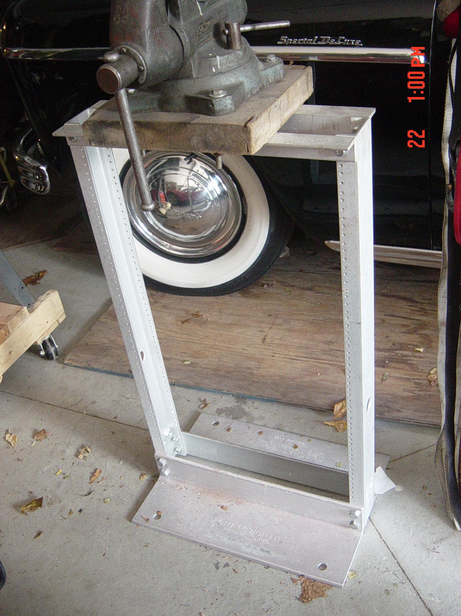

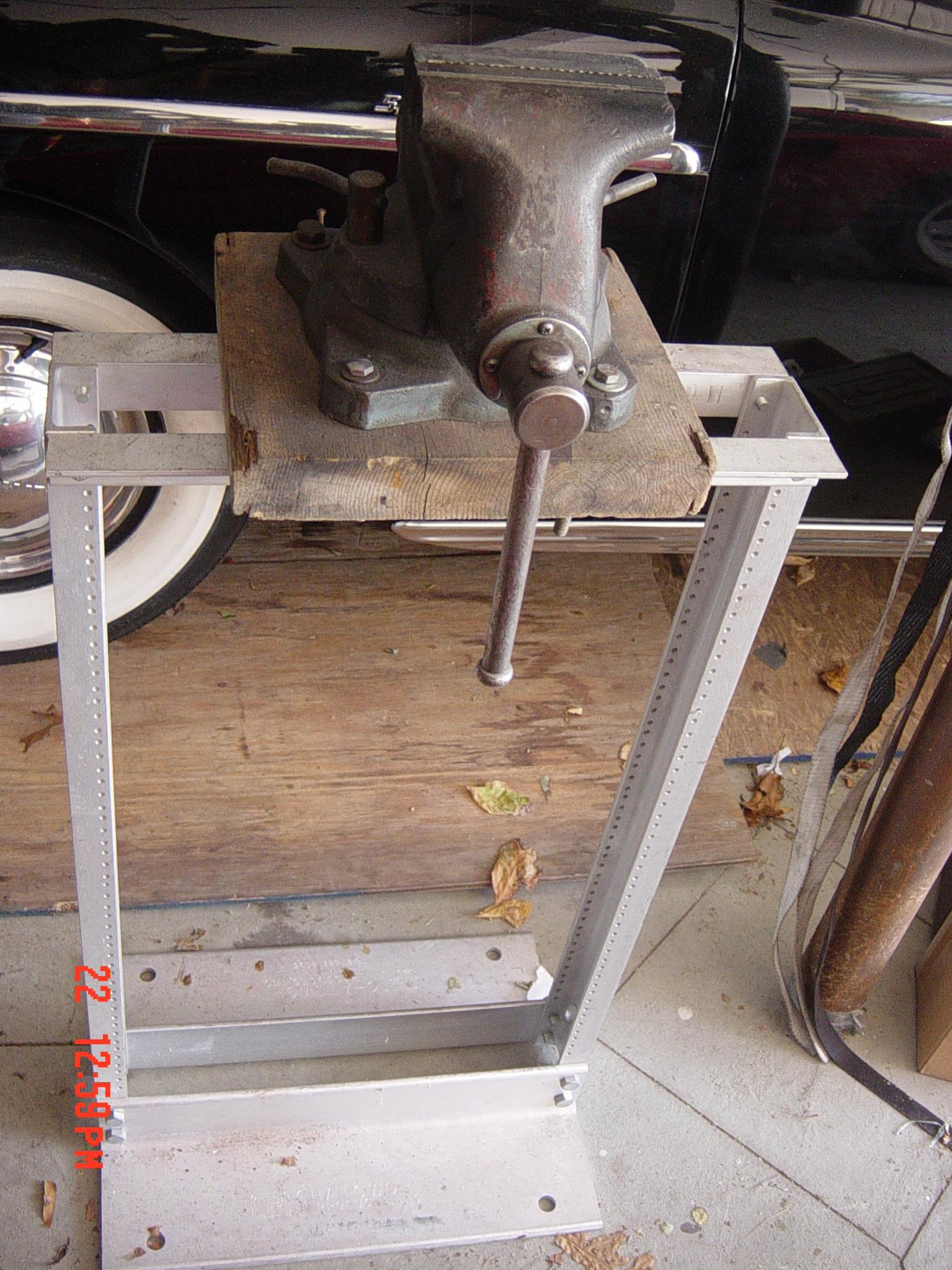

  29. plym49
    Joined: Aug 9, 2008
    Posts: 2,802
    plym49
    from Earth
    There's nothing wrong with what you built. Just like every other tool in the world, it has its limitations and if you understand them you will not get into trouble.
    I can't have enough vices -- excuse me -- vises.
    I have several mounted to workbenches and here is a portable - because - sometimes it makes sense to work on something away from the workbench. It is an aluminum server stand from someone's computer room. It was headed to the dumpster. It is heavy construction yet fairly light and with a wide footprint is fairly stable. I have it set up for the vise in this picture. I also remove the vise and use the stand for things like a wire wheel/buffer (c-clamp the whole thing to the flat top of the server stand).
