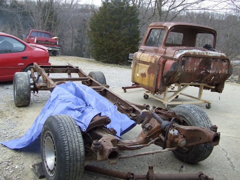

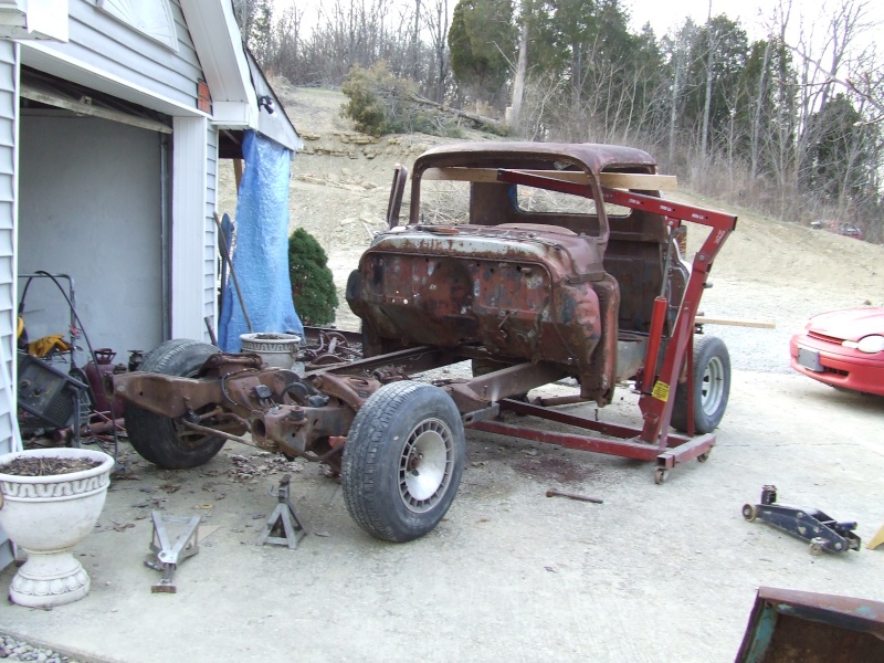

    Getting older and working a lot by yourself you figure out strange ways to do things. A couple 2x4 with a hole drilled in them and loosely mounted to your cherry picker is all that is needed to get the cab back far enough to weld the rest of the frame.
    We finished off the night by getting rid of the stock master and brackets that were on the frame.

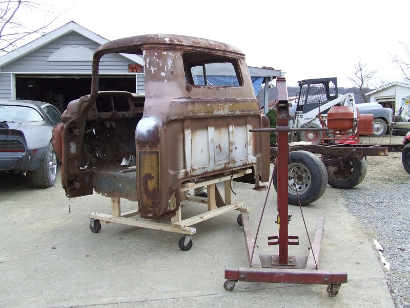

    Made a frame with some casters on it so we could move the cab around and work on it a little easier.

    It would not hurt to toss a couple side brace at a 45 degree angle. The cab is not that heavy and we are not working on the cab yet but before I start climbing in and out of it I'm going to bolt in a few more boards just for safety sake.

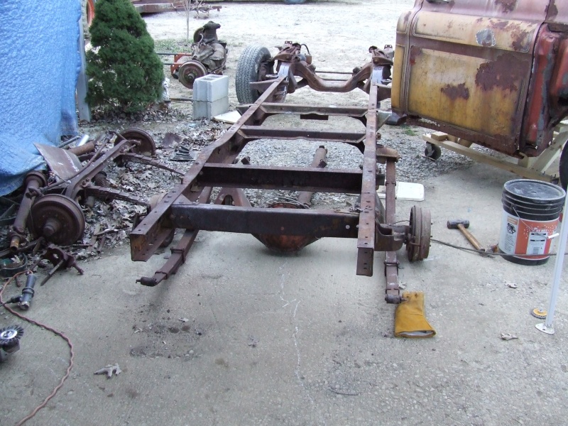

    Earl was off school and didn't have to work yesterday, that's a rare thing so the whole day was spent of his truck. We drove to the paint shop to get some primer only to find out it had closed down. Had to go to the one that was further away from the house to get what he needed. That took some time away but other than that he works all day and into the night. Even using a flashlight at time to see what we were doing.
    There were still a ton of bolts and rivets holding brackets on not counting the gas and brake lines up in the frame. Earl got the whole frame cleaned up while I finished welding the front clip on completely.

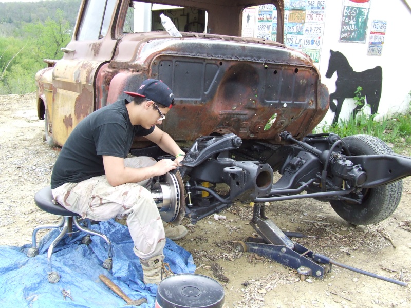

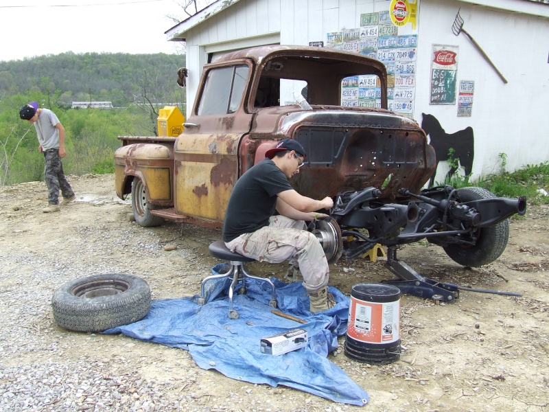

    The good: Today was Earls first day of learning how to put inner and outer bearings in new rotors along with new calipers and pads. The bad: it won't be the last time. lol .. He also tossed on some new shocks and sway bar links.
