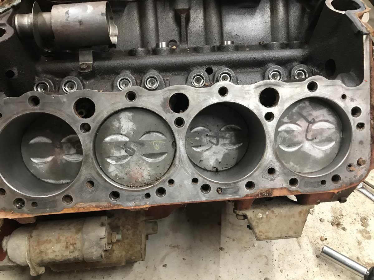

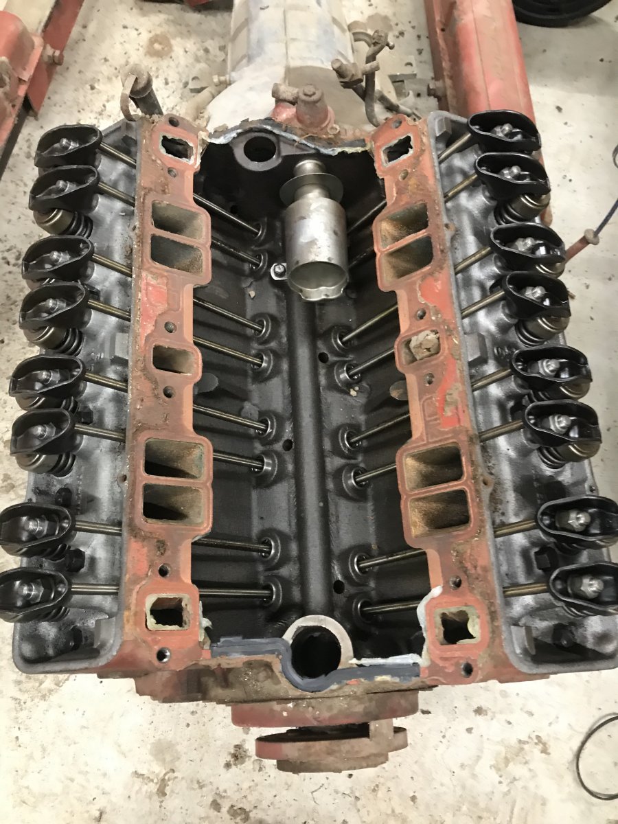

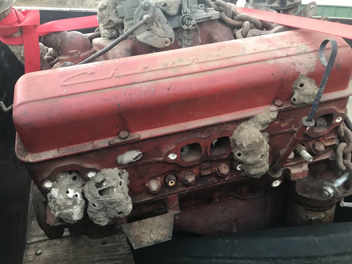

  11. Here is what not to do...I just bought a rebuilt 283 that sat in an open barn for 30 years with nothing covering the exhaust ports and no one ever turning it over. It was actually in better shape than I expected considering what the outside looked like. But, it also appears they oiled it all down good when assembling. I’m just glad no one did try to turn it over at least after the mud dobbers built their nest in #5 cylinder.
