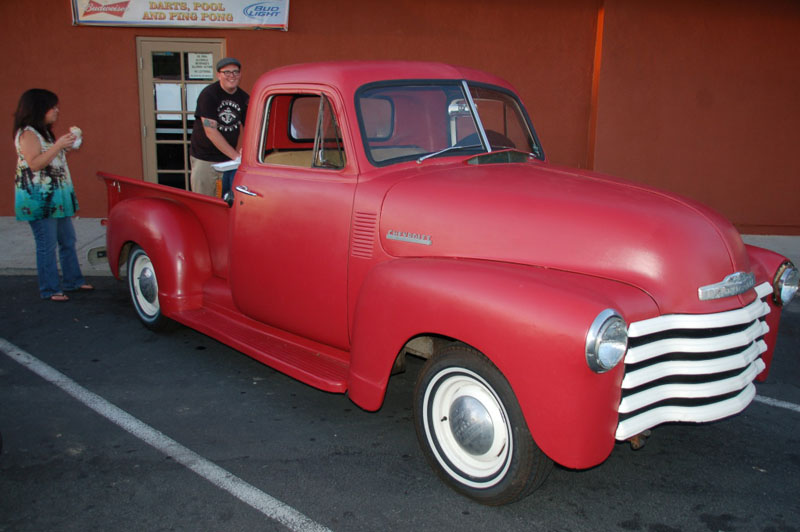

    I had a buddy who had a dual carb ‘51 Chevy truck that commuted an hour each way a day through traffic, up and over a hill with 6v, vacuum wipers and bias plies and the only thing he changed eventually was going to radials because he wore out the Firestones quickly commuting.
    It can be done, but you have to be dedicated and pretty hardcore to do it. The truck had been gone through and was kept in top mechanical condition.
