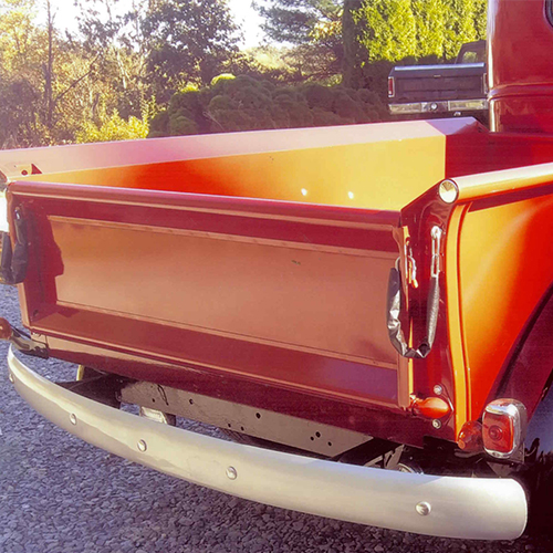

    I like this and need to build a tailgate. I think this tool would be perfect for the top and maybe bottom flanges. I have plenty of pipe laying around just not a large one. Not my truck just a tailgate image showing the area I'm thinking. upload_2024-9-20_13-18-19.jpeg

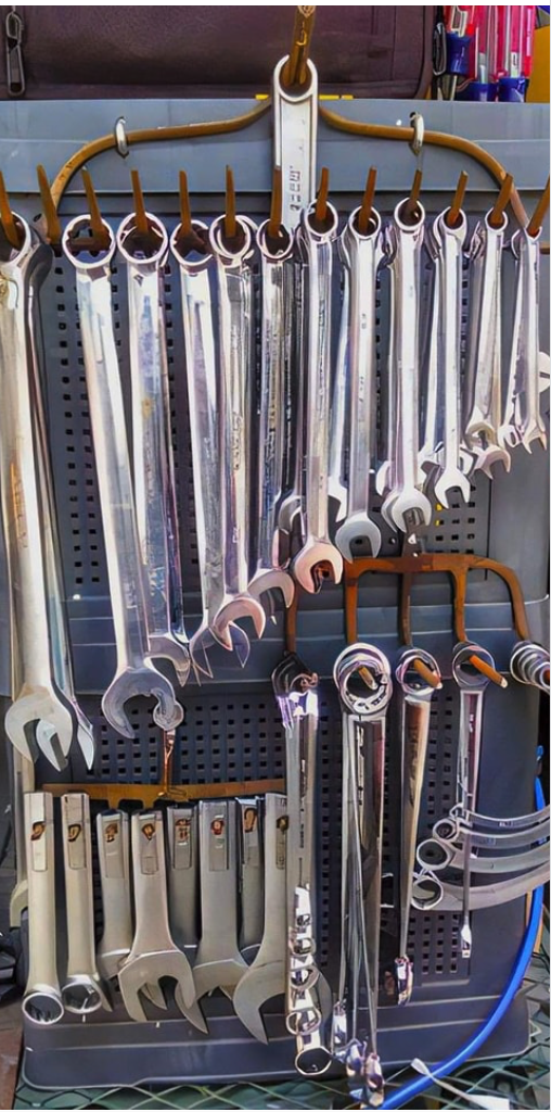

  8. Good gravy!! So simple! So obvious, as though they were MADE for that.

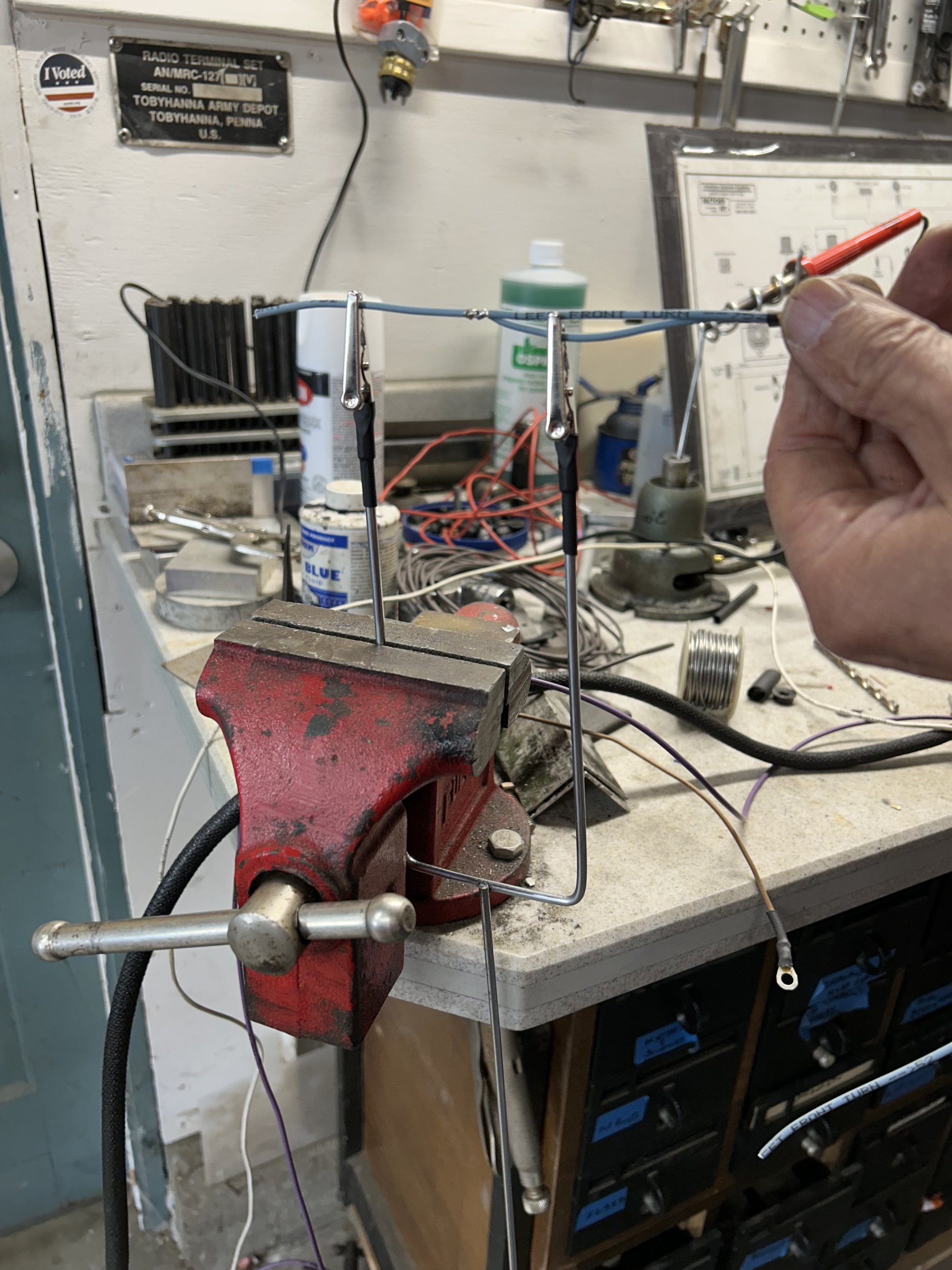

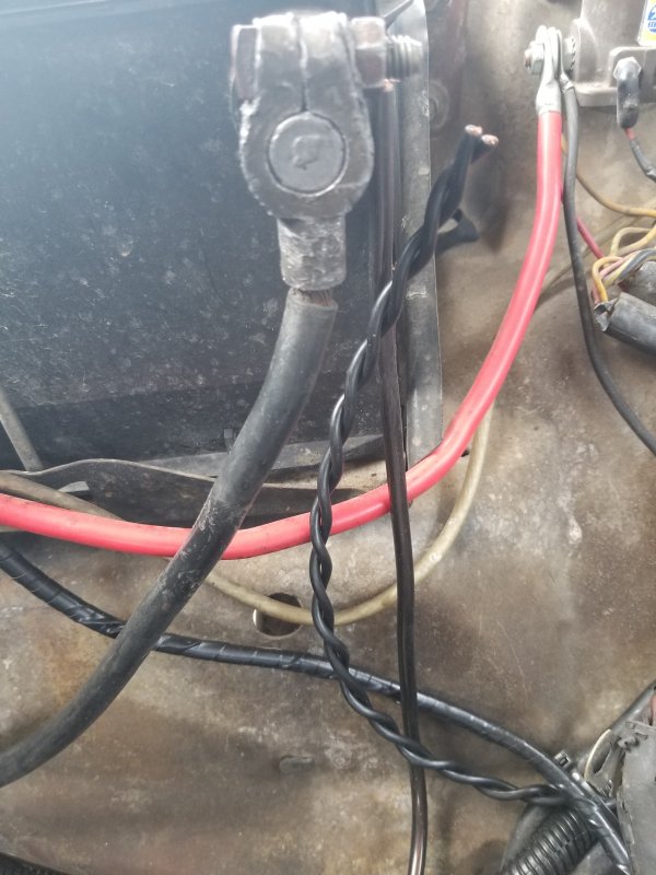

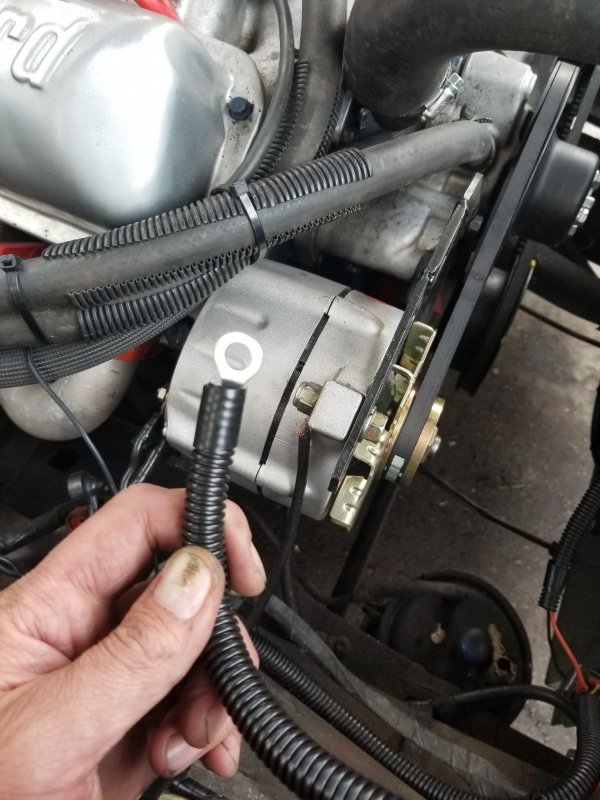

    Didn't go through every page, so just thought I'd share this if it hasn't already been here. I'm on a few forums and there's a similar thread to this one, so this is just a copy and paste I posted about braiding wiring:
    I know most of you know how to do this, but for the guys that don't here's the shortcut to braid wiring. Normally this would be two different colored wires going to one place like a positive and negative, but these are both grounds to the battery that will split off further down the harness so they're both black. So first route your wires from where they start to where they need to go. Leave yourself a few extra inches of each color. If you're not sure leave more than you think. The longer the wires, the more extra you need. This will be about 5 feet so I gave myself half a foot or so, it's better to waste a couple inches than two five foot chunks because you cut them too short. Next, squeeze one end of the wires in a vise. Pull them tight and put the other side into your favorite drill and tighten them up in the chuck. Pull back with a little force to keep the wires straight but you don't need to get crazy. Next pull the trigger on the LOWEST speed. Twist until you've got the weave you want. Reroute and connect the wires to their places, then cover with loom. Wrap the ends of the loom in electric tape to keep it from letting the wires out. Voila.

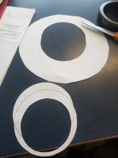

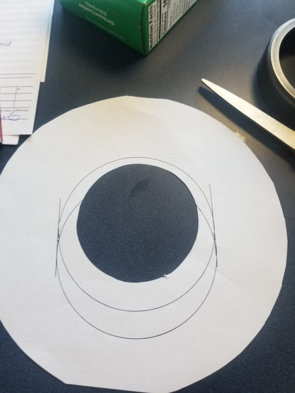

    This is how I offset air cleaner bases when a clearance issue occurs, but could be used to offset any hole easily. Basically you get a template for a hole that is slightly larger than the hole that you'll be "moving" in the material, and place it over the hole, and draw a line around it. Then figure out the center of where you'd like the hole to be, and draw another circle with the template around that. Connect the two template circles you drew with straight lines, and cut on the lines and outside the template lines. Turn the material you just cut out 180 degrees, then weld/braze/glue/stick together with gum or whatever you need to do, and you're done. Kind of confusing in words, but here's a demonstration on paper (it's easier if you start with the hole centered, not like I've got in these pics, but when I made the original post and these pics on another forum I was showing a guy what needed to be done for his specific air cleaner base):

    I worked for an electronics manufacturer at one time. The first time I saw them doing that it was like magic.

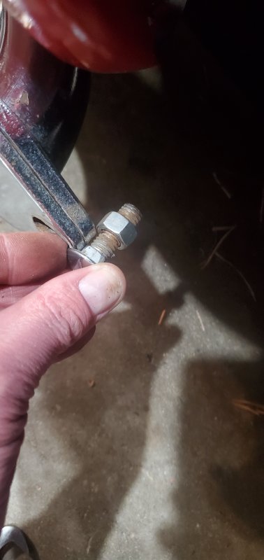

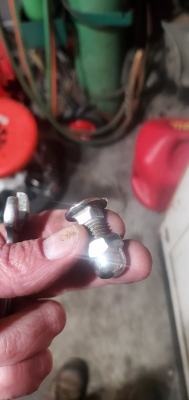

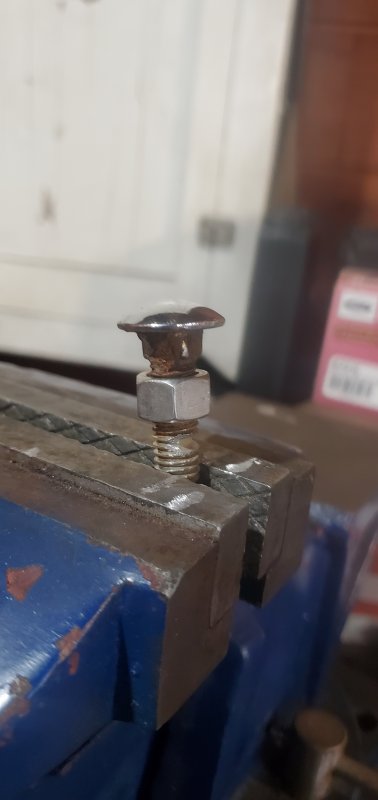

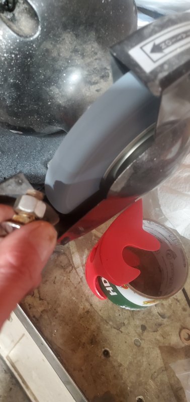

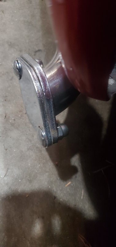

    Shortening bolts:
    I hate threads hanging out of open end nuts, especially anywhere that can be seen on the exterior of a car. If you've never shortened bolts before, it's pretty easy. Measure how short you want the bolt, run your thread chaser up it the proper length (or a nut if you don't have a chaser set, but chasers will make it at least 89.7% easier, especially on stainless), cut it to length with your cutoff wheel, grind the end off at a bit of an angle for easy starting, then run your chaser or nut off the end of the bolt about half way and back on a few times to square up the threads, and done....cap it off with an acorn nut and no more nasty threads hanging out the end of an open nut like some derelict from the hardware store. Nice and finished looking...

  19. GearheadsQCE
    Joined: Mar 23, 2011
    Posts: 3,606
    GearheadsQCE
    Alliance Vendor
    Just to add to the confusion (and my $.02 worth) There is no strength to be gained by having the bolt extend beyond the nut if all the threads are full diameter. This would be @2devilles example of cutting the end of the bolt off flush with the nut. This leaves no lead or taper to ease starting.
    As he showed the the acorn nut in his example, I would suggest that the bolt extend into the nut the same depth as the equivalent open nut plus 2 threads.
    Let the arguments begin!
    brEad, Sharpone, Six Ball and 2 others like this.
  20. Then there's the ol' What's It Holding Factor.
    If the nut is clamping on a rod, crank main, cylinder head, or a on a wheel stud, I'd want every thread sharing part of the work and some left over.
    But capping a lake pipe or holding on a license plate? A few less threads aren't going to keep me up at night. :rolleyes:
    Just Gary, 61Cruiser, brEad and 3 others like this.
  21. Dick Stevens
    Joined: Aug 7, 2012
    Posts: 3,947
    Dick Stevens
    I'll stick with Industrial Fasteners Institute guide, we aren't fastening traffic signs or building high rise steel structures, we are building hot rods!
    1. Industrial Fasteners Institute, Joe Greenslade, Director of Engineering Technology.
      • “How Many Threads Should Be Beyond The Nut?. The answer is: A minimum of two thread pitches should extend beyond the top surface of the nut.”
    brEad, Sharpone, LWEL9226 and 4 others like this.
  22. 2devilles
    Joined: Jul 16, 2021
    Posts: 448
    2devilles
    Hey, if it makes ya'll feel better, I ran that stainless cap nut onto the chrome bolt and galled the fuck out of it....it ain't coming off no matter what.......

  24. iagsxr
    Joined: Aug 26, 2008
    Posts: 290
    iagsxr
    My understanding is that spec exists so a fastener can be visually inspected.
    Threads past the nut add no strength. I quess in theory they could give a little extra time before the nut falls off if it vibrates loose.
    On my race car bolt's are long enough if they fully engage the nylon on a nyloc or barely come past the top of a top lock. I never have anything come loose.
    I run a lot of 1/2"-20 nyloc jam nuts on suspension pieces on my race car. Just for giggles a couple years ago I decided to see at what torque the threads pulled. The ones I tested were in the 125-150 ft. lb. range or close to double the correct torque on those bolts. Not sure if that's pertinent to this discussion, but I thought it was interesting.
    alanp561, 29A-V8, Sharpone and 2 others like this.
  25. lostone
    Joined: Oct 13, 2013
    Posts: 3,317
    lostone
    from kansas
    Working in the automotive field I was always told 1-1/2 to 2-1/2 threads past the nut on everything, especially suspension parts, I.E. 4 links, ladder bars, tube arms etc.
    I was told this was done incase the threads start to stretch it would help support the last threads of the bolt that was in the nut.
    Old wives tale or truth ? Don't know but always did it that way.
