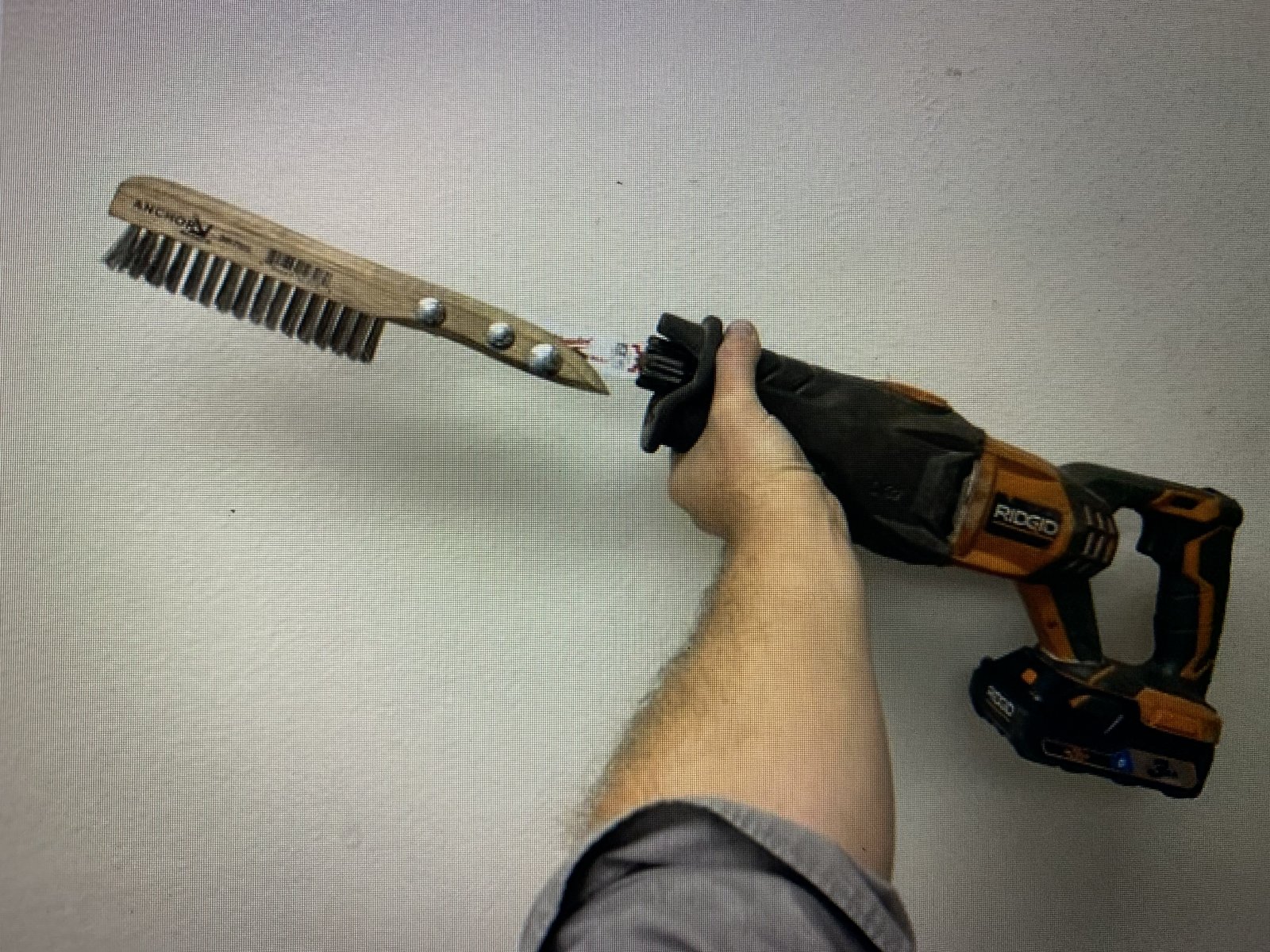

    Filed under “Now why didnt I think of this” E4515ADE-C1EE-46EF-9004-D82AE1CDF1EC.jpeg

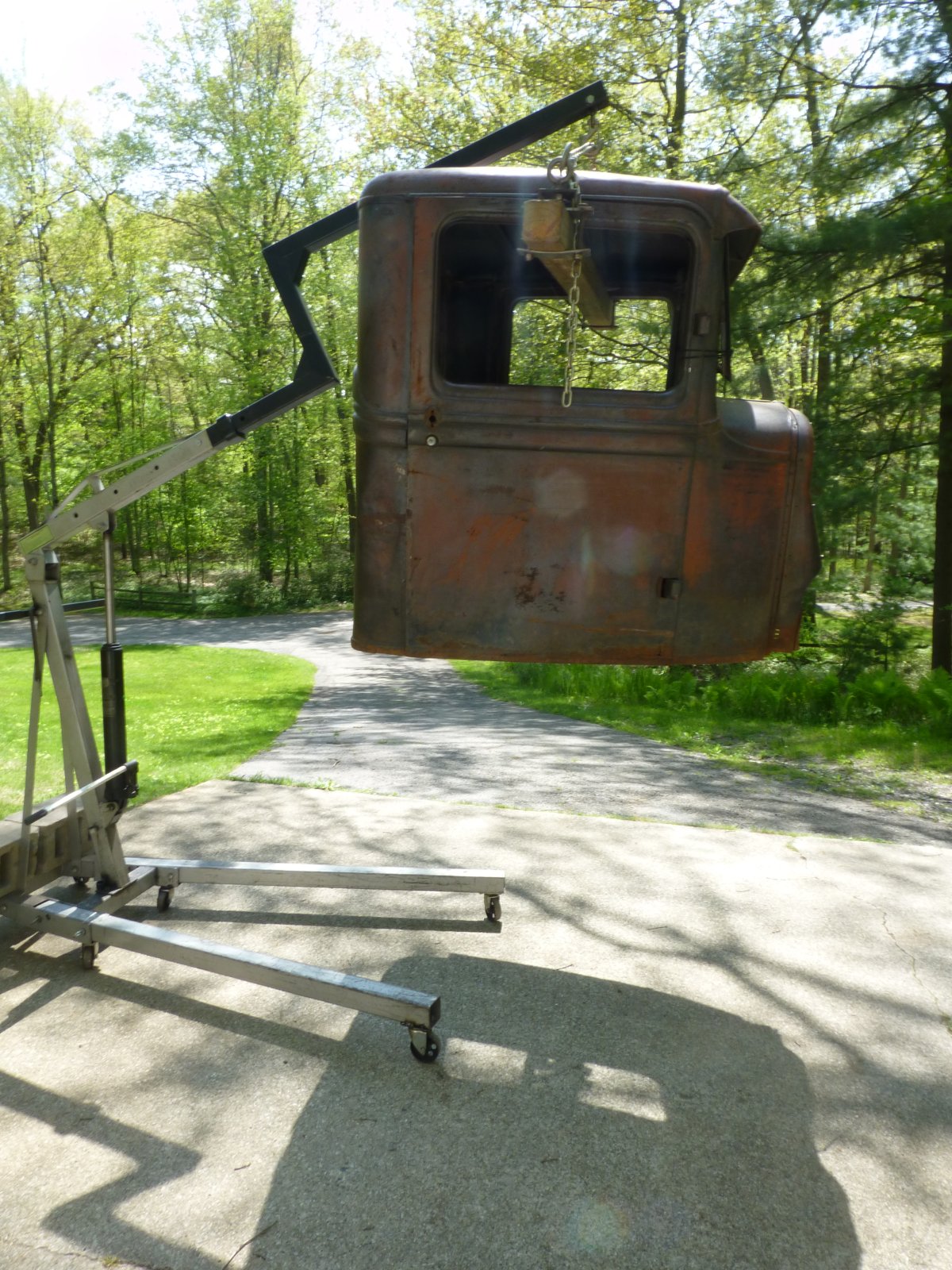

    I'm sure I posted a picture of this arm before but I can't find it. I made an extra arm for my cherry picker in order to be able to easily lift bodies off my trailer. This picture shows just how high it can lift and the arm isn't touching the cab. Overall length is 81 inches and the upright is 15 inches. In order to be sure the tube of the picker itself wouldn't split I wrapped some 2" X 1/4" steel strap around the end. The 4 X 4 cross piece has sliding eye bolts in order to accommodate different widths and I can adjust the length of the chain also. With the extra length I can also set a body on the ground or a dolly without the legs of the picker interfering. I also added some angle iron to the bottom rear of the picker in order to add weight to counter balance if needed P1060658.JPG

    Counter weights required I see...good tip...I mean it doesn't tip good tip...lol

    Neat. I might suggest making the upright piece on an angle to give a little more space to whatever is being lifted.

    This replaced one I made with a Z in it. It's back more than far enough. Realize that it's at max height and still has room. If it were angled the angle piece would be touching the cab roof unless the arm was even longer. The factory arm is 36" overall, this one is 81"

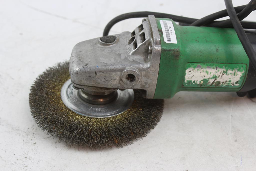

    Why bother attaching a brush to a Sawzall? Just get a wire wheel for your angle grinder. Don't overthink this stuff. power-wire-brush-angle-grinder-1_22920161848168630653.jpg

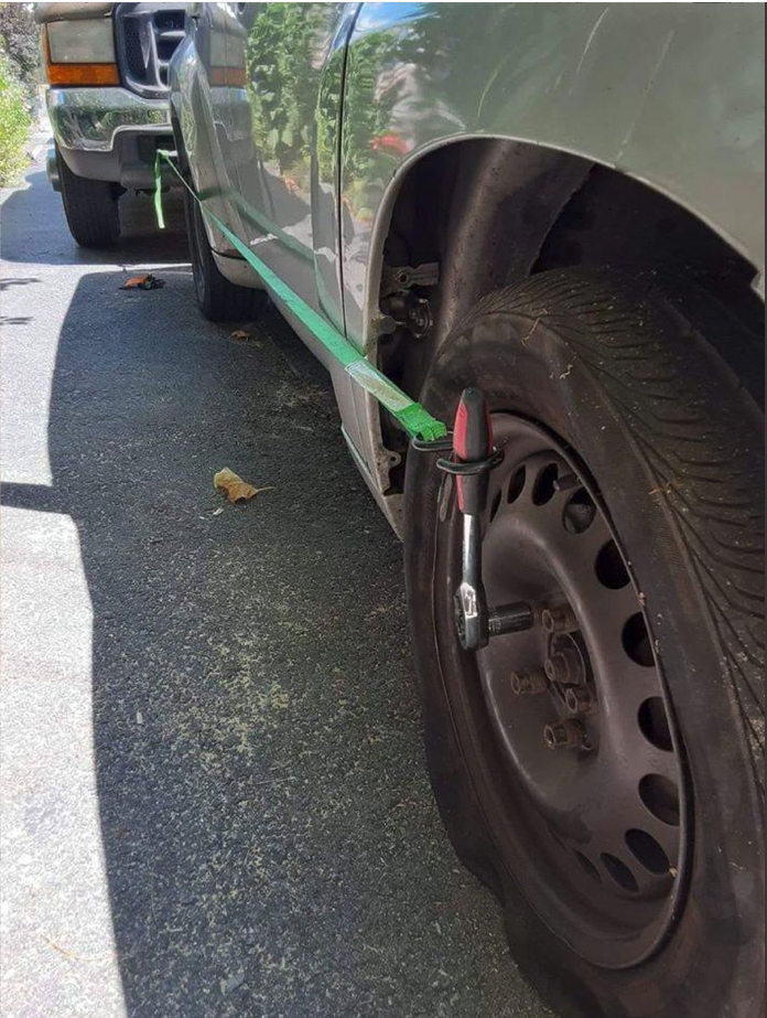

    I used to do that all the time with pipe wrenches on my firetrucks! Those 4 inch pipe threads , under water, could really get stuck. I used my little 500 lbs air hoist, had a little more “ distance “!

    It sort of reminds of when Dad would tie a string around a loose tooth and the door knob. Then he would slam the door. I had the fastest 10 yard sprint in town till I lost all my baby teeth.

    An extension for these lifts is very handy, and a standard size of square tube fits down the middle of the jib. Just drill holes for the hook and locking bolt. Picked up an A coupe body using my straight extension, but went in through the window and secured the lifting chains to the floor. A suitable human counterweight is required as well!

    Notice that he used a 4x4 thru the doors to lift. If you use a strap it will cinch tight as it raises and bend the door tops.

    Here is a related tip. Don't put a wire wheel on the $15 Harbor Freight grinder. It will burn out in just a few minutes. They do work fine for grinding and cutting if you are only working a few minutes at a time.
    The $25 HF grinders hold up much better to wire wheel use. They are often on sale (or you may get a 20-30% off coupon) . I have 4, using a flap disc, cut-off disc, grinding disc, and a wire wheel.

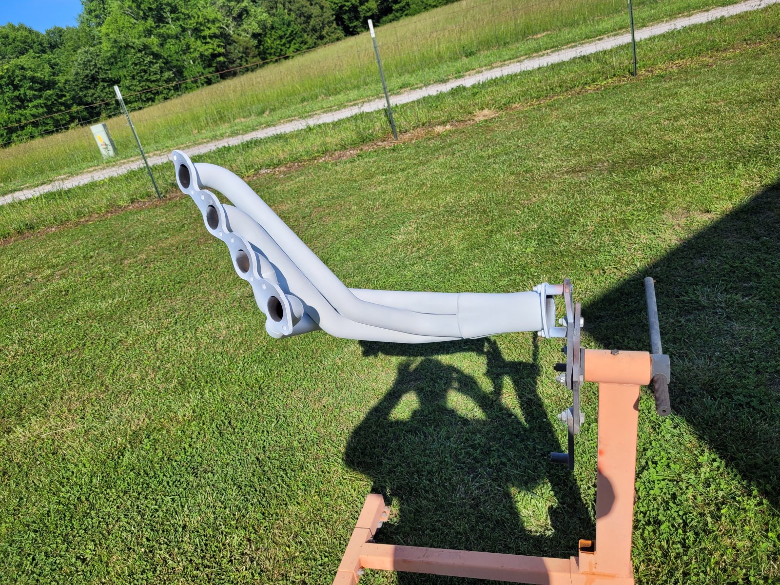

    Nice way to support the headers during paint. Most of us would have hung them off of a tree limb with coat hangers. You did good my friend.

    Just be careful to NOT have your lifting point very far ahead of the hoists front wheels otherwise it could topple over ..... understanding that the body weight is relevant too.

    Makes it easy to paint.roll them around. Lol

    Beautiful paint job, then scratch them all to crap installing them in the chassis.

    No...fenderwell headers...super easy to install.
