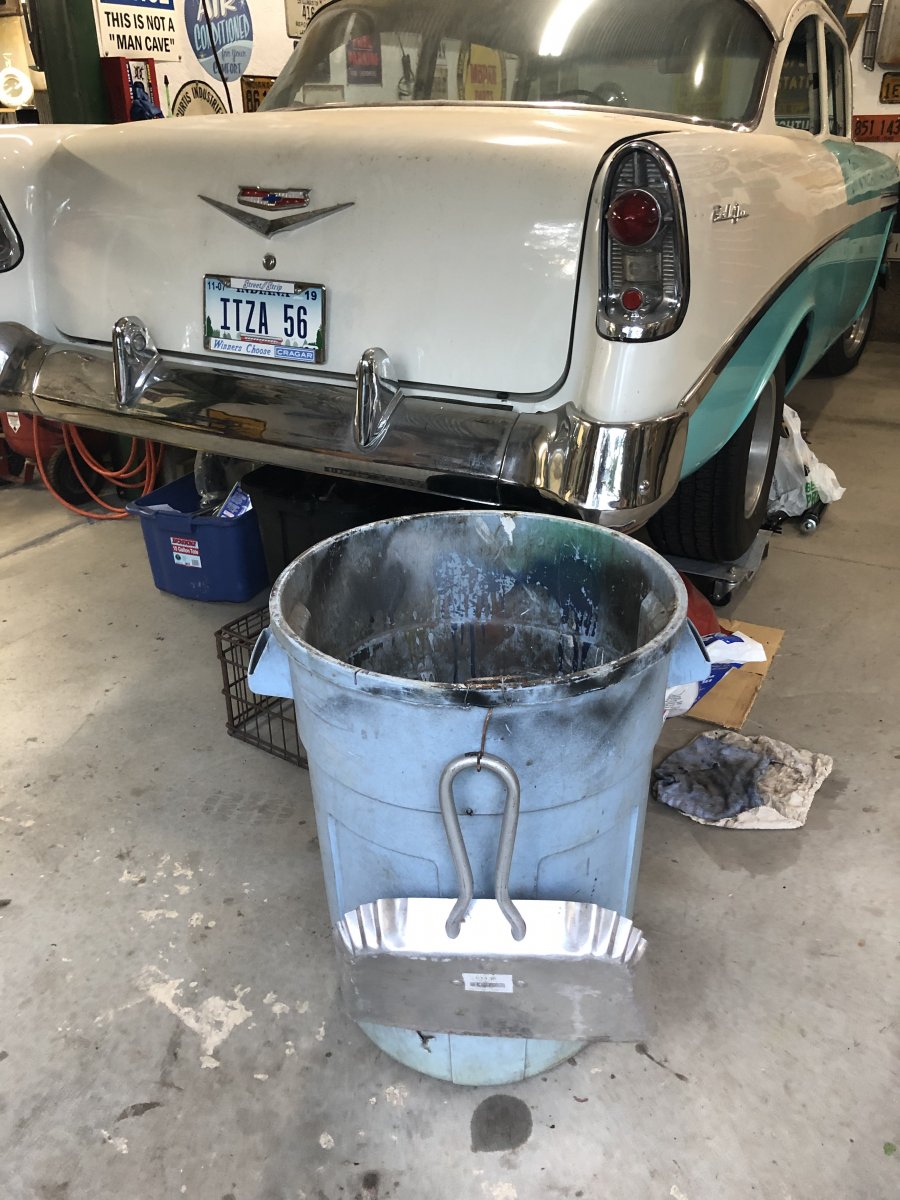

  21. 027A6B3E-207B-44A9-93AE-158A8C0D85D4.jpeg Here’s some more trash can tech. Hang your dust pan from your can. I used a welding rod, 7018 I believe :rolleyes:

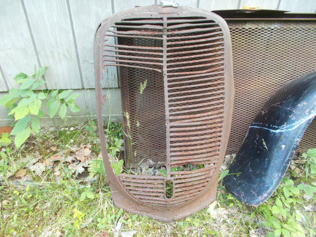

    If you like the narrowed '37 truck grill look, buy a roll of 5/16" or 3/8" steel brake line, it is already bowed, easier to make match the grill's bow... I chop and narrow the grill about 3" and leave the top and bottom few teeth there as they are harder to fit... take the b/l pieces and roll them over a tire the right diameter to get a starting bow... they will bow more in the center and flatten as they approach the top and bottom … tack in a center strip to keep the bow right...
    should work on about any horizontal tooth grill.... maybe even a vertical tooth grill ? DSCN4390.JPG
