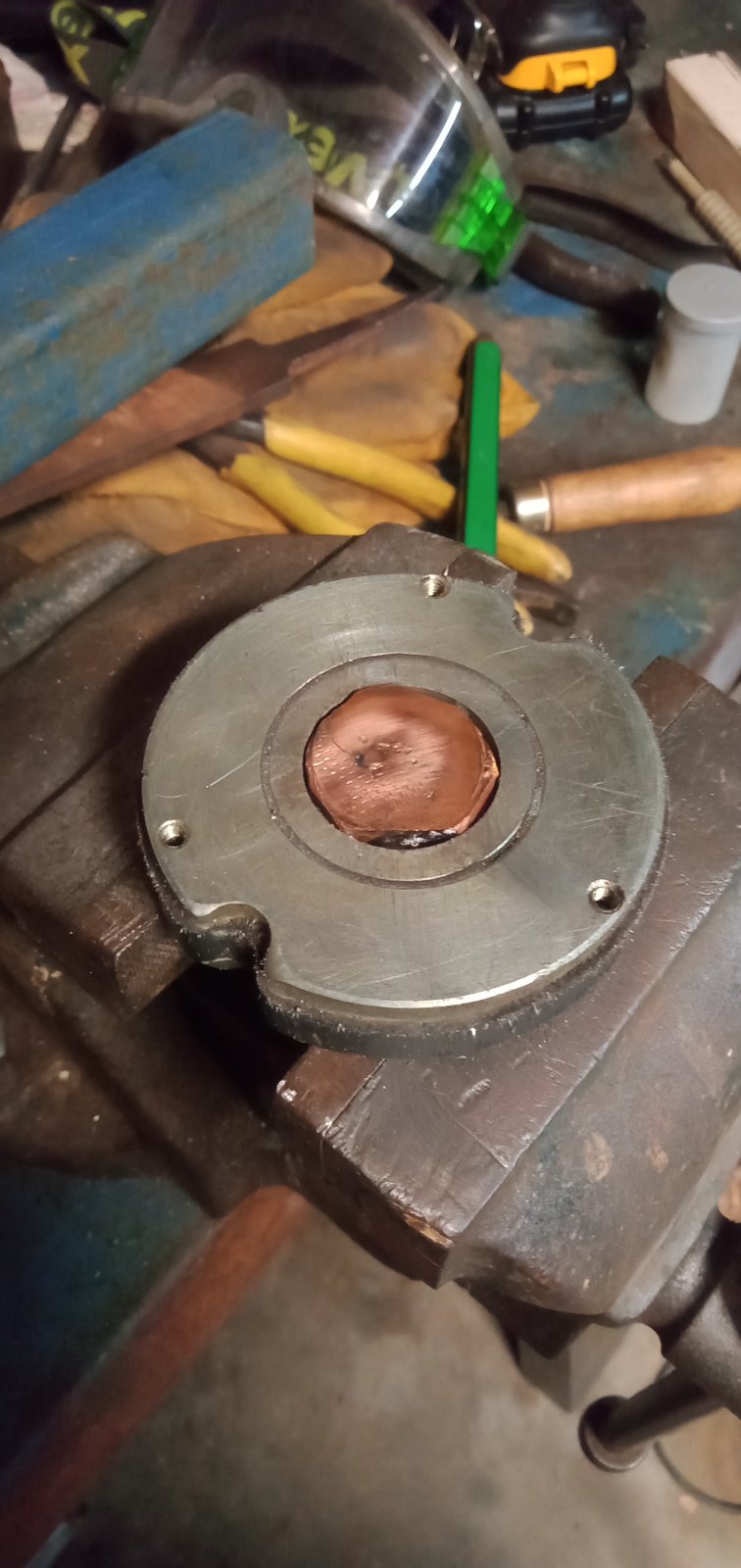

  24. I have a lot of holes in my firewall that i'm welding up.
    Got a magnet from an old PA horn speaker, cut a piece of copper bar to fit (poorly) and padded it out with some MDF behind. They slot into the hole in the magnet.
    Works a treat.

    Thats a neat idea " Clitchy "
    Glitchy and loudbang like this.
  26. Nice solution using the magnet with the copper. Any smoke from the MDF?
  27. No smoke, only gets warm. I only used MDF because it was close to hand when i came up with this. The copper is pretty thick, it's from a 50v DC bus bar.
