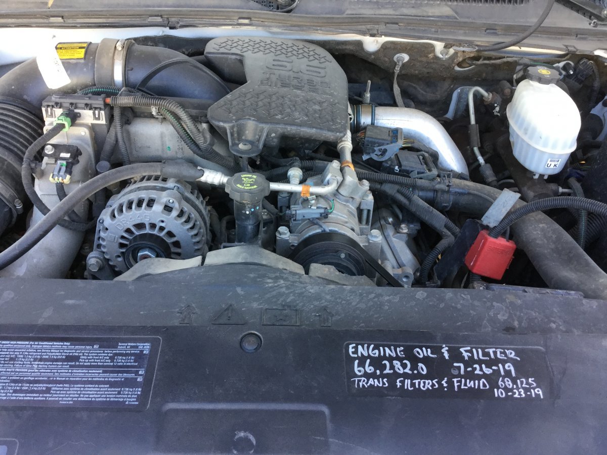

    I’ve found that if I use a silver sharpie to document my service records on my daily drivers it helps to remember them. Next service a bit of brake clean and update and I’m good to go!

    That works too, but I forget to look at those. This way every time I open the hood it screams at me that it wants some love!

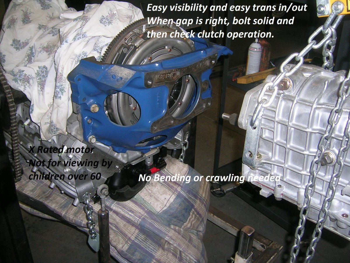

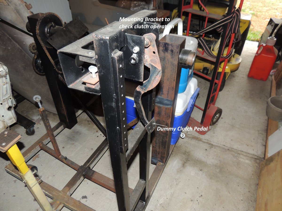

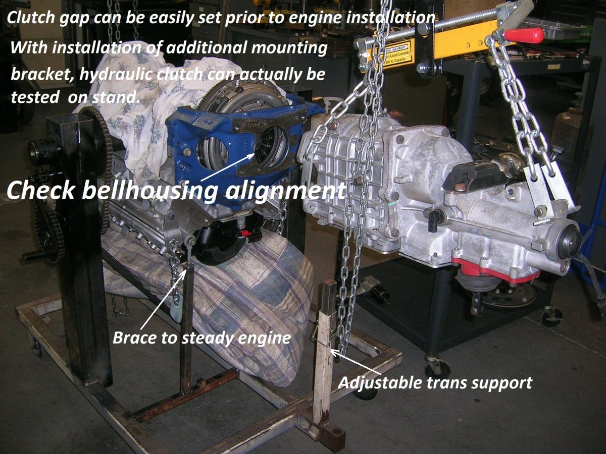

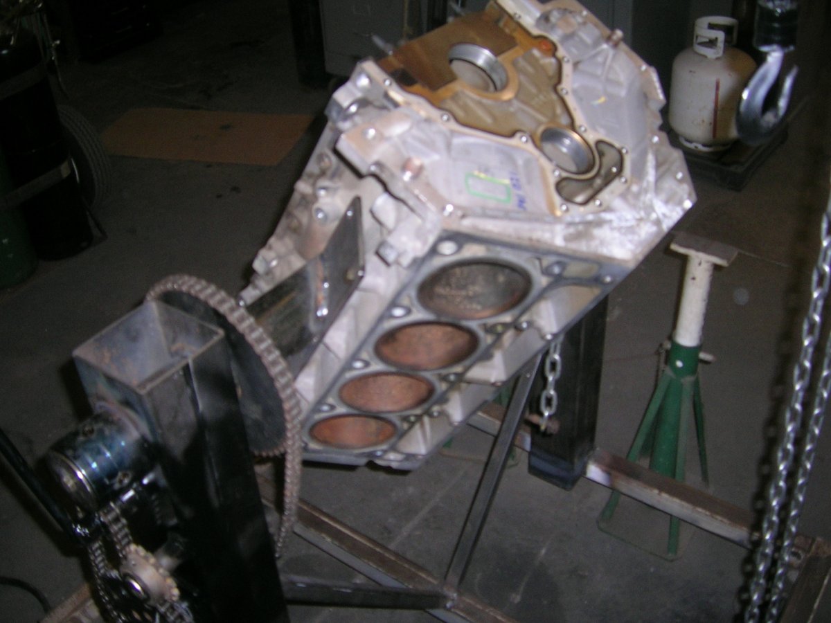

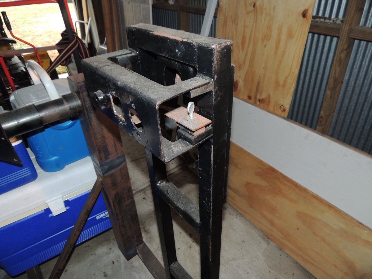

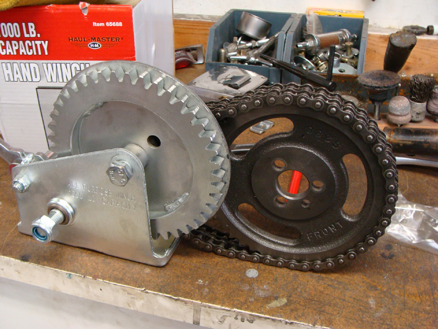

    I have a couple of inexpensive engine stands that I welded some adjustable supports out on the extended leg to give support to engines that are going to hang there for an extended time. I also made a stand similar to the chain drive rotator above. On mine I made the engine so it mounts with the bolt holes on the side of the block. This lets you rotate the engine without having the rear of the engine impeded by the mounting arms.

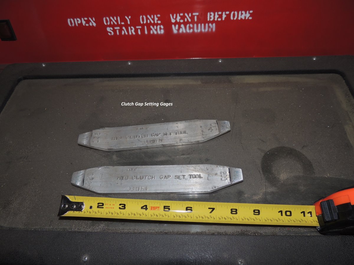

    It gives a builder good access for assembling the engine normally, but also allows mounting accessories and brackets on the front to work out any problems. In the rear, the bellhousing can be mounted and checked for centerline accuracy. Then you can mount the clutch assy and check clutch fork relationship or completely check the operation of a hydraulic clutch.
    Some simple bracketry will allow mounting the hyd components and checking operation before installation. Another simple bracket can be made that allows an adjusting screw to push a manual clutch fork and see how much movement is needed to make it work...and whether the pivot ball is in the ideal location height wise. Lots of things that can be checked and set up prior to installation. Personally I don't find working under the car to be as enjoyable these days.
    Added note: The blue bellhousing in the picture has a large hole cut with a hole saw. This is a dummy bellhousing that I use for clutch set up. When aligning a bell housing I use the one that will be actually used in the car, as every bellhousing is different somewhat.

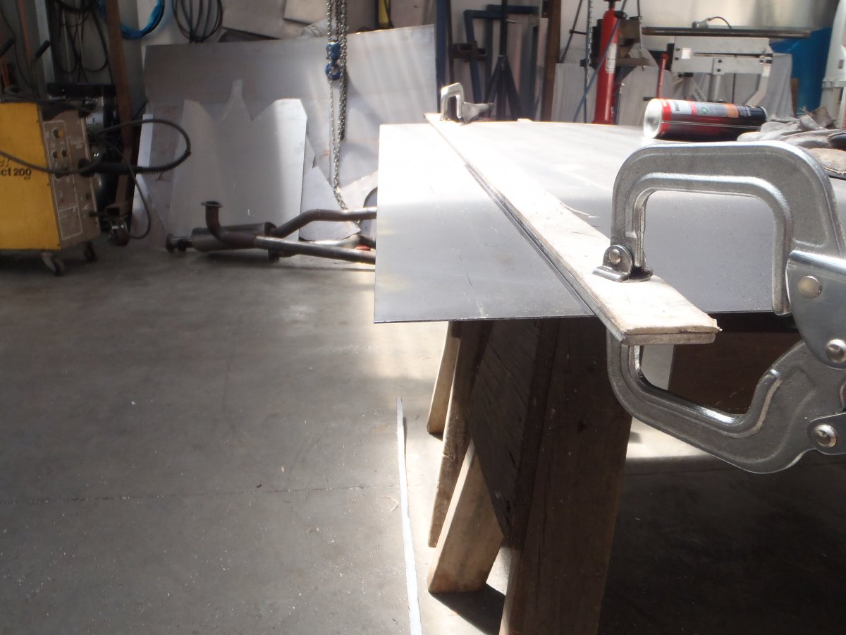

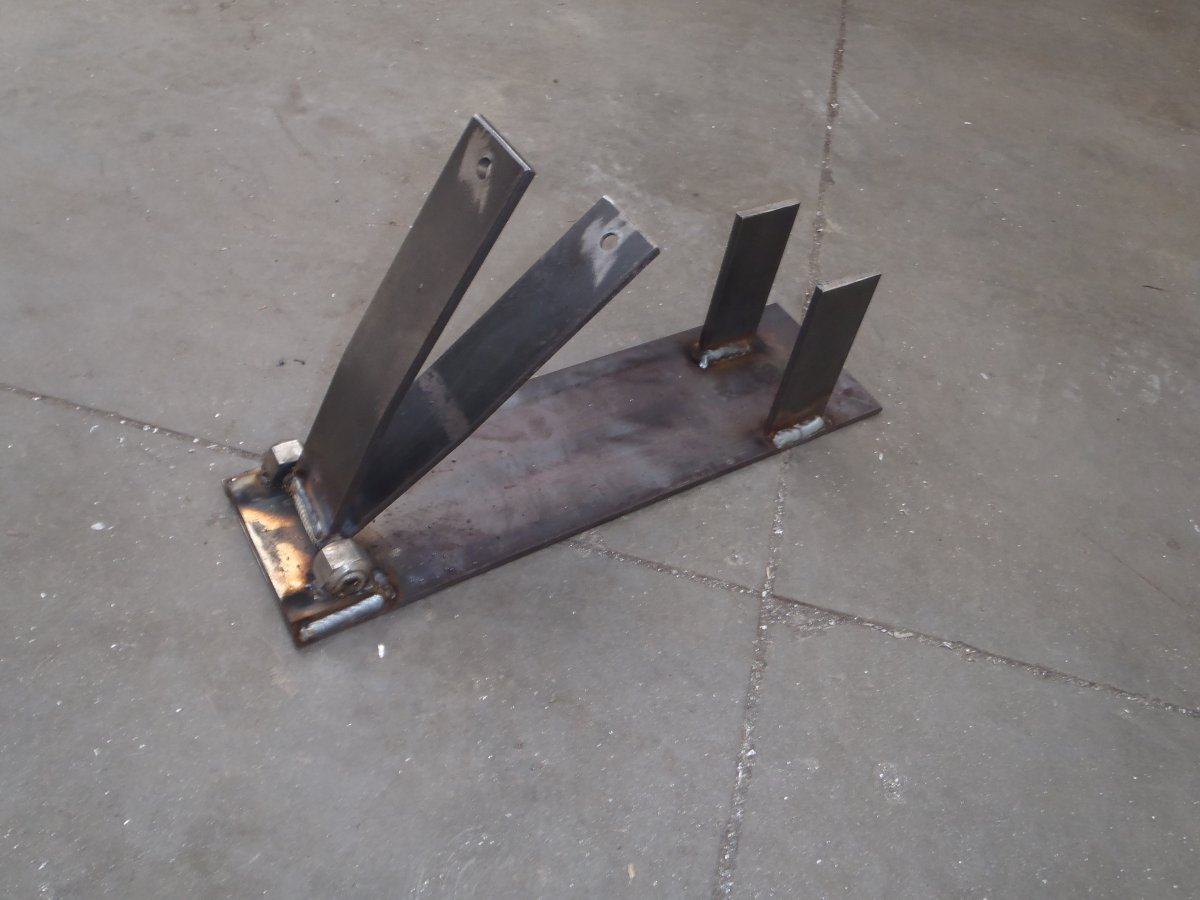

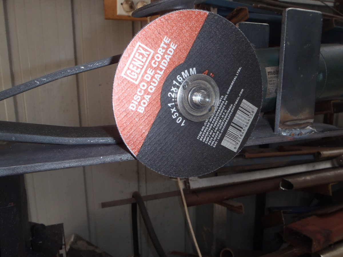

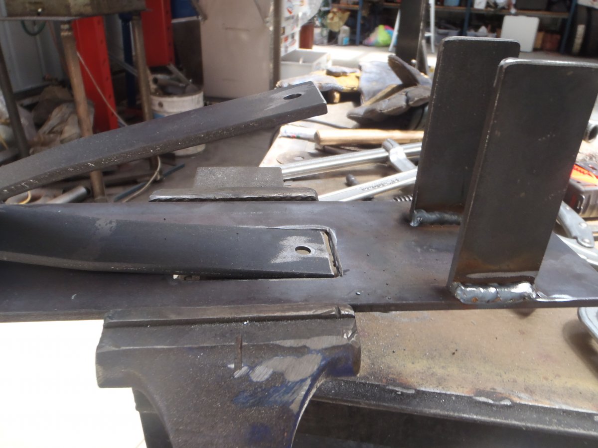

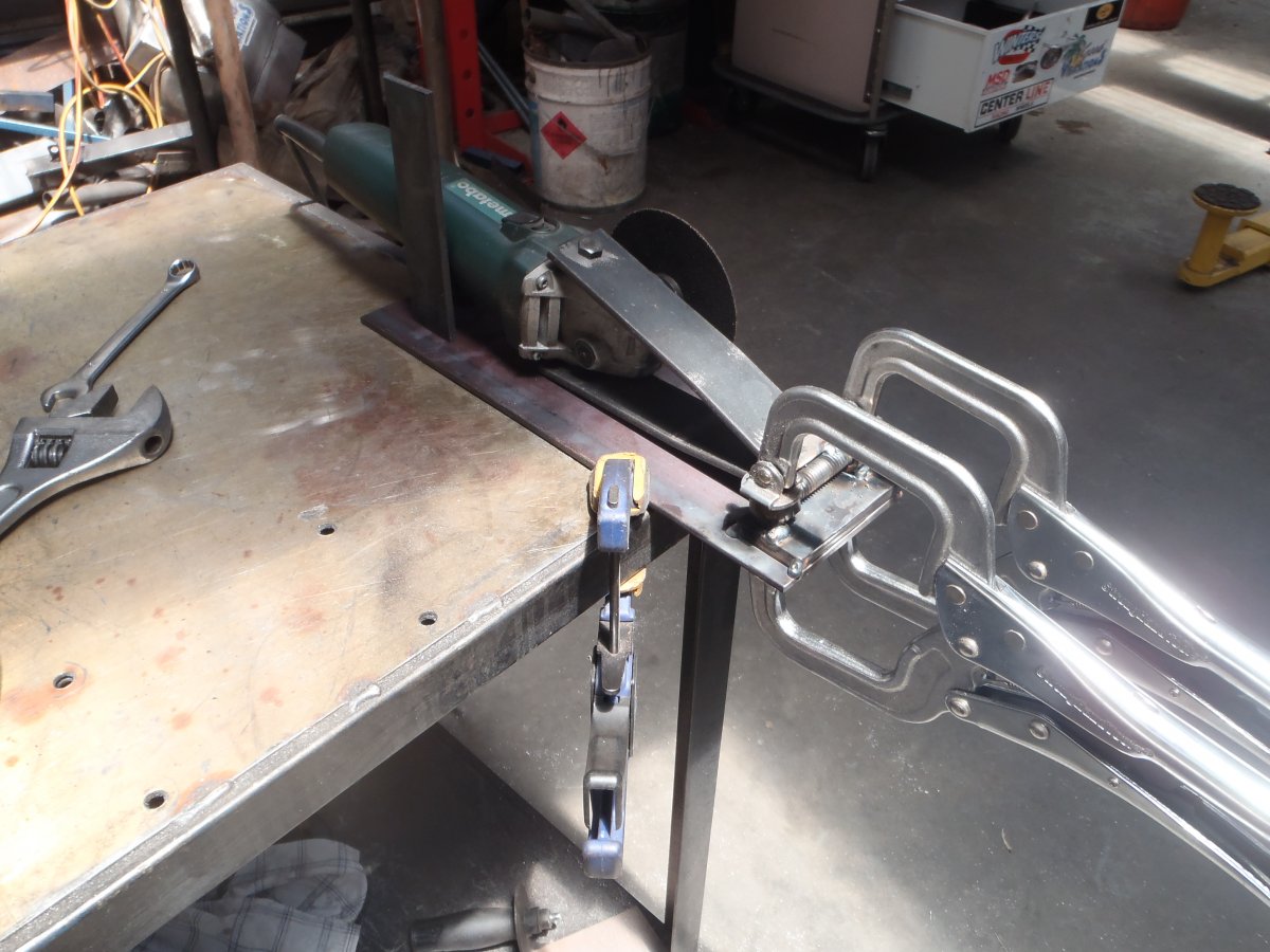

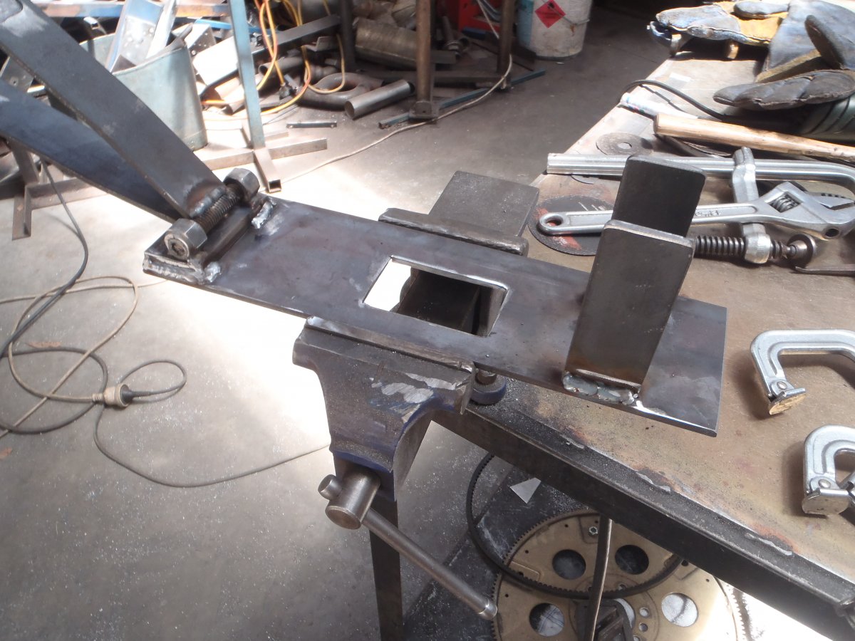

    Today I fabricated a attachment for my angle grinder to cut straight lines in sheet metal as I dont have a guillotine. I searched you tube and came up with this unit. Works a treat. Glen P1010071.JPG P1010073.JPG P1010074.JPG P1010076.JPG P1010077.JPG P1010078.JPG P1010082.JPG

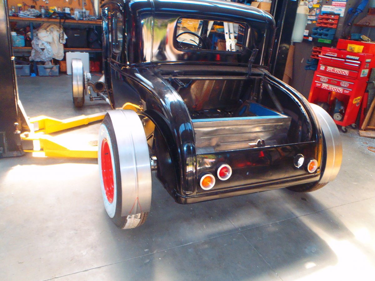

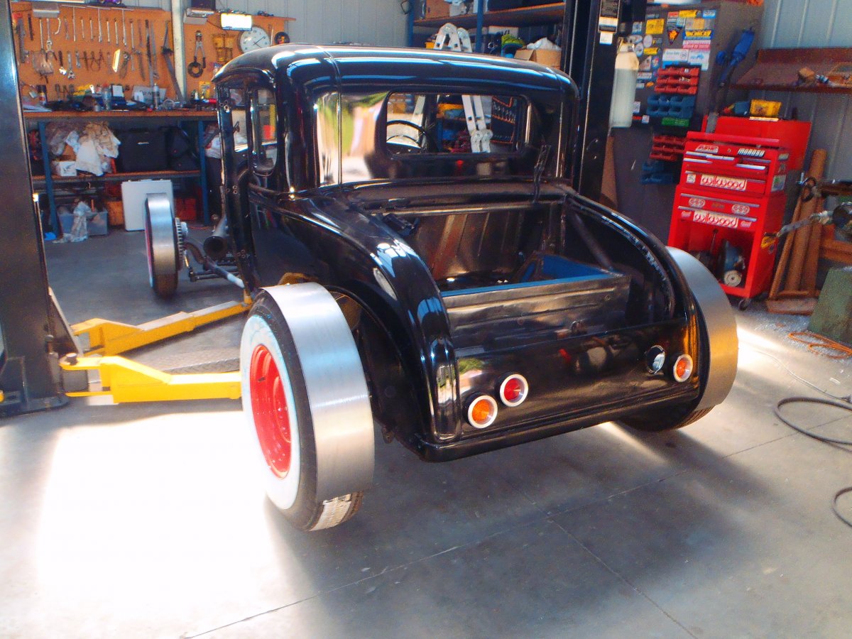

    I made my angle grinder attachment so I could make my cycle guards, I also needed to make a guide for my bead roller so I could make a straight bead in the guards, check out pics. glen P1010104.JPG P1010108.JPG P1010114.JPG P1010115.JPG P1010116.JPG P1010117.JPG

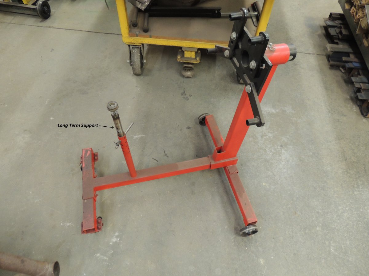

    I put an adjustable support on my engine stand for when I want to leave a very heavy engine or leave one for a very long time. Don't like the idea of all that weight pulling down from a few bolts, especially if its an aluminum block. It might not make a difference, but it sure doesn't hurt anything.

    There’s one I’m going to use! If I left a complete engine on a stand overnight, I would roll it under me hoist to relieve it a little. Mostly for me, it was peace of mind concerning the engine stand it self! I have seen them fail! But now I have a new project! .....to add to my already too long of list! Thanks......I think! Lol

    When I first did it, it worked great, but I didn't make it able to clear an engine with a front sump. Never thought about it. Bought a 500 Cadillac the other day and had to shorten it a couple inches so I can rotate the Caddy. Just took a minute, but wanted to point that out in case anyone else copies it. ;) Might think about a pivot to let it lay on the bottom rail when not in use,......

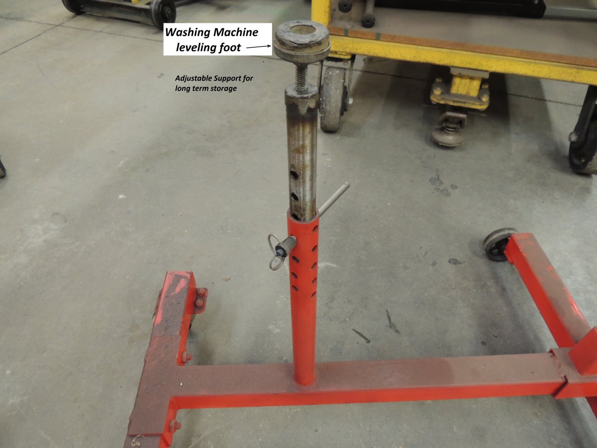

    Anyone wanting to add the adjustable engine support post to their engine stand. I used one of those screw adjusters with a rubber bottom like they have for leveling a washing machine or old desk. Probably find them on line or at Lowes. They work good and are cheap.

    Same thing with Muriatic Acid. It will get rid of rust on metal but the fumes will cause everything in your garage to rust if you you use it inside.

    I remember the first time I put my 235 straight 6 on the stand, I bolted it in place and started to lower the hoist, and it just kept going down! We welded some extra bracing to it which is still there (as seen in my avitar), but it keeps me from rolling a complete block and head over. Something like your improvement would help.
