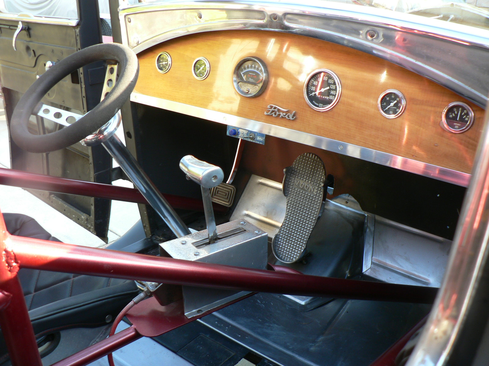

    Here's the switch on my street car...
    It's just a Radio Shack HD momentary contact switch mounted in a drilled-out NAPA skull knob.
    granny
