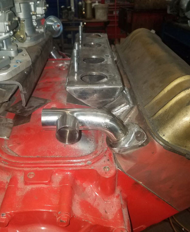

    Ok, its been some time ...but I am back to creating the Intake Manifold for the Ol 332..
    Picture 1 was scrapped and we move onto Picture 2 which is almost complete. intake try #1.png intake try #2.jpg
    After a few attempts , and one heck of a lot of homework...here is where I have arrived. I do need to separate the top plate and separate the runners yet. It was easier to fabricate it as one piece to get the geometry right....but I will be separating the runners . My question is ....How should I pull vacuum for ignition advance ? Should I tap into each runner and build a vacuum can with small vacuum line....or pull everything from 1 runner. It gets tougher if add a power brake booster. I am close to getting it finished, so I am down to details.

    I'll be watching , working on a similar idea for a Cadillac 472. I'v been wondering if it necessary to connect the two sides to help balance vacuum? For street driving should water passages be built in to run coolant through it?

    Good day, This is a Lincoln Y of course and 332 was the stock dispacement from the f800 trucks. This is a 1959 motor with a .060 overbore....so really a 341 or something like that..

    From what I have learned is that typically a longer runner helps with your bottom end...but not with a Weber. With 1 throat per cylinder, you have to separate the runners and keep them short so the air charge can move very fast...thus more low end and quick acceleration. I believe a balance tube would slow the charge and slow down throttle response.Thats where adding a vacuum port becomes a bit tricky for a youngster like mysself..lol

  7. Some of the newer aftermarket weber intakes address this with small (1/4") holes in each runner feeding into a common plenum cast into the bottom of the intake. They claim this offers enough vacuum to operate even power brakes if need be without upsetting flow. With the right plumbing, you could duplicate this with a remote vacuum can plus even offering the ability to do a carb sync with an ordinary vacuum gauge.

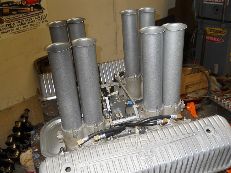

    DSCN0126.JPG DSCN0128.JPG 017.JPG 368 +.060 with 317 crank = 363. Very nice for C/AIR at SCTA events.
