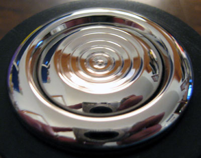

  1. I thought I would start this thread to share how I installed a pair of reproduction 46-48 Lincoln door buttons and made them work with bear claw door latches on my car. These are manufactured and sold by Logic Industries-an Alliance vendor right here on the HAMB.
    If you havent seen these door buttons or cant remember what Lincoln door buttons look like,here are a couple pics from their website

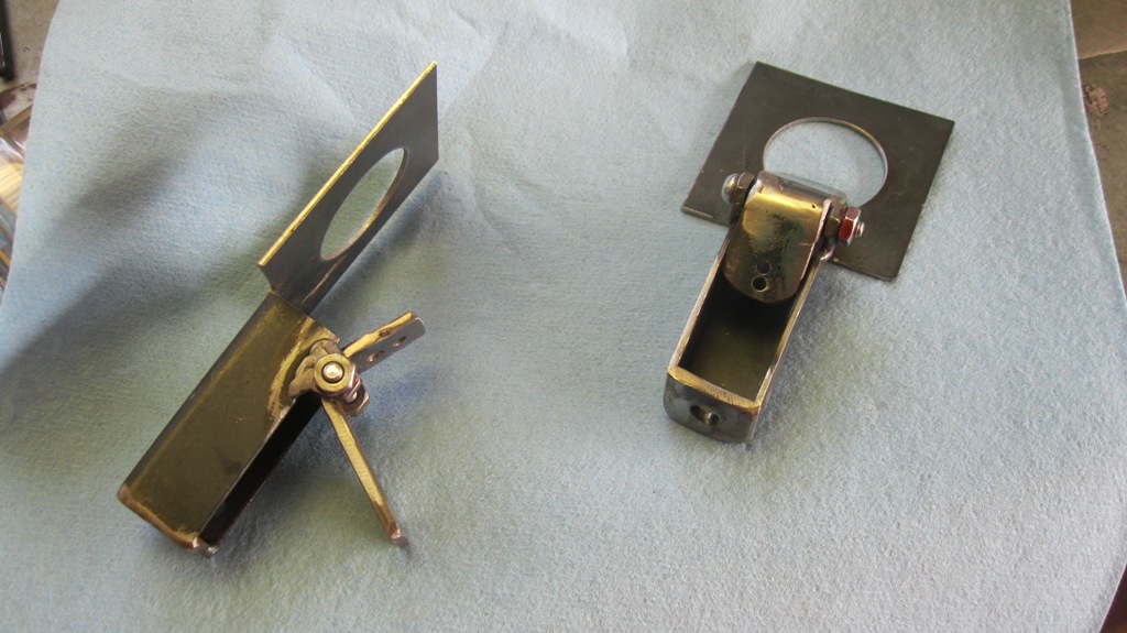

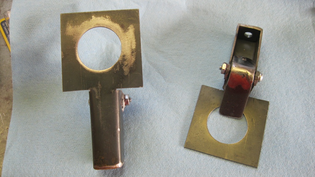

    I needed a way of controlling the cable-my buddy and I went through a couple proto types and came up with this:
  6. The button fits through the bracket and the big nut that is supplied keeps everything nice and snug
  7. Thanks for this I am about to tackle this exact same issue with the Logic buttons and this will save me a ton of time!

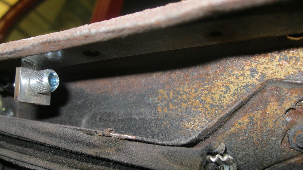

  8. The cable will run from the inside of the door skin-down under the glass and back up to the latch-You have to have a way to hold the control cable housing-One end is held at the button bracket/actuator inside the skin.The other end is attached to length of 1/8" strap with a 90 degree bend . I rosette welded the strap/bracket on the inside of the door below the latch- the length really isnt that important-I made mine a little longer-just to add a little rigidity-

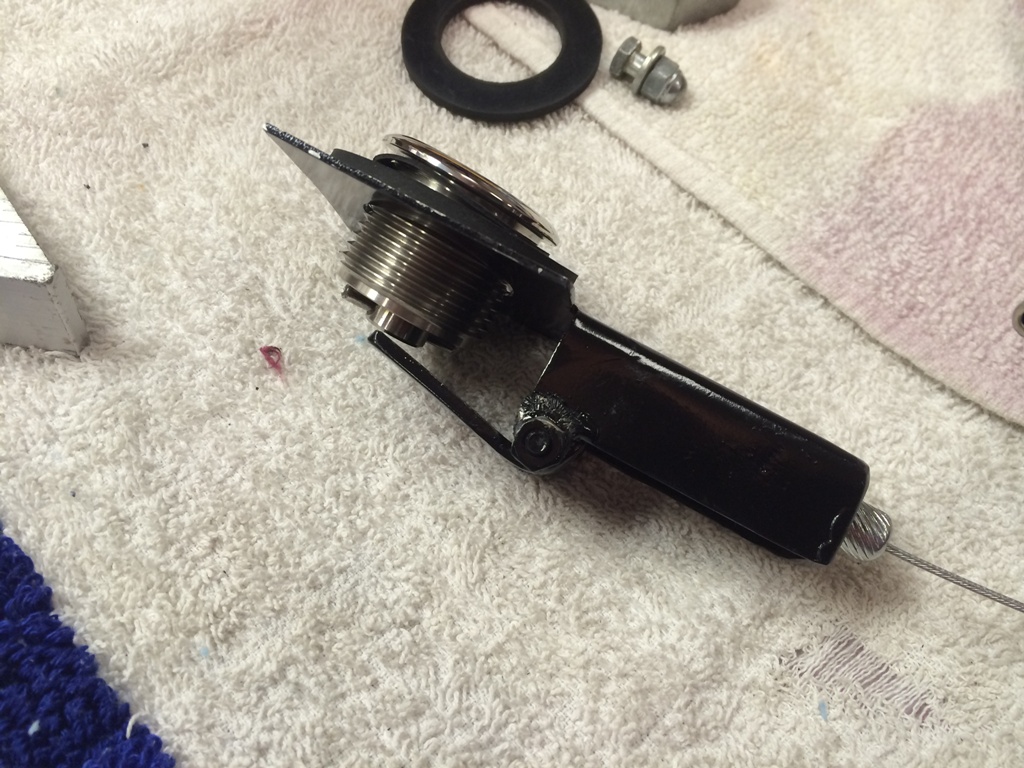

  10. The cable is inserted starting at the button end-The 'L' shaped lever gets pushed in when you push on the button from the outside. That causes the bottom of the 'L' to lift up-and pulls the cable

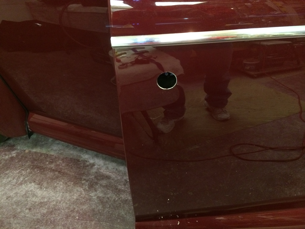

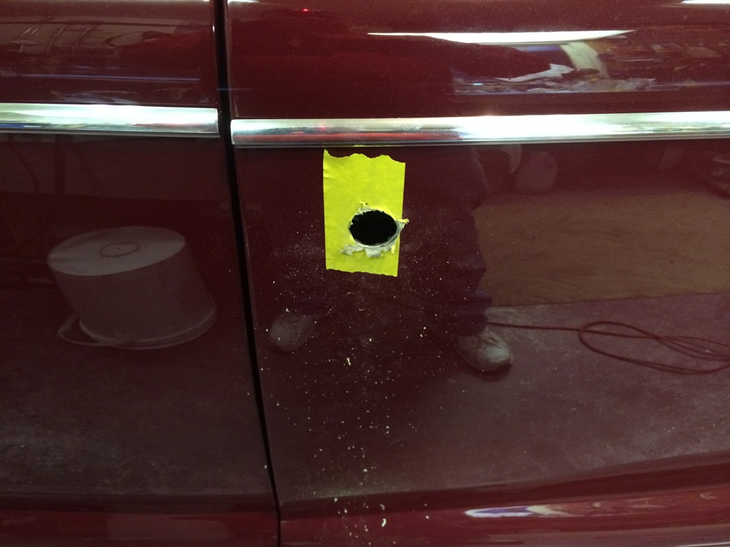

  11. Now comes the most important part-cutting the hole in your door!
    I can tell you how many times I measured-but it was alot. You have to make sure you have the hole where the button and actuator wont interfer with anything inside the door. The buttons come with gaskets to seal out water-But You also need to make sure everything is sitting flush with the door skin-
    On the inside of my door there is a brace on the outer skin that runs behind the glass channel-I trimmed the button bracket back alittle on one side so it would sit flat against the door skin and not interfere with tis internal support.

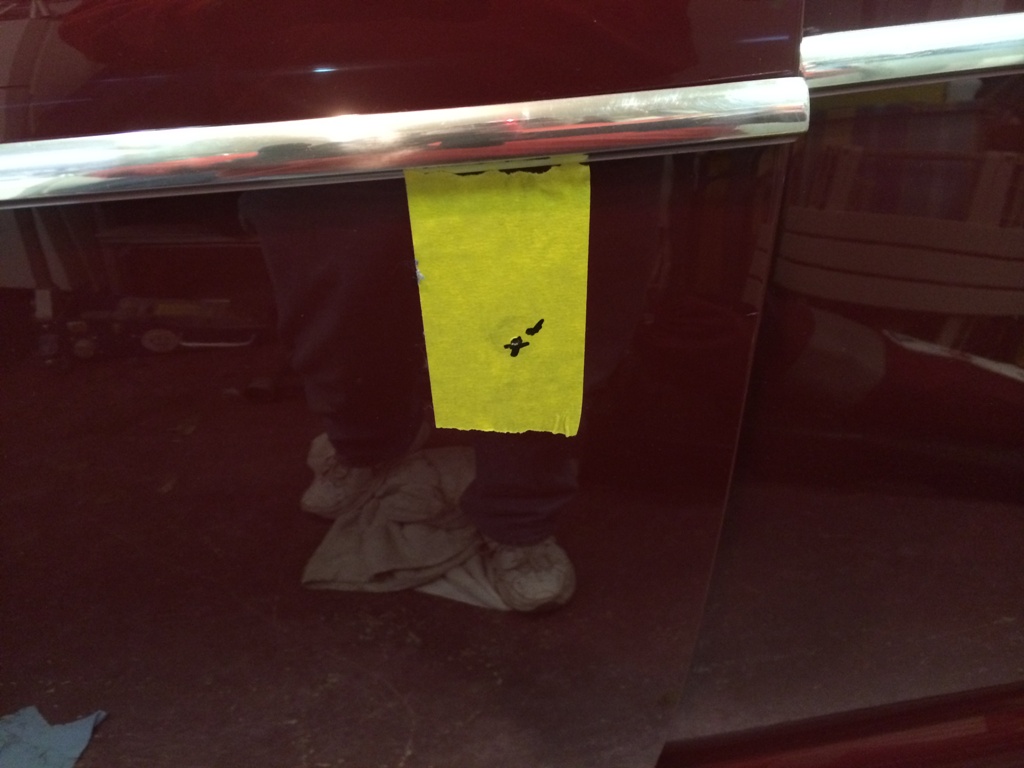

    (This should go without saying)Before you cut the hole-drill a small pilot hole first-maybe 1/8th inch-hold the bracket inside the door and make sure the pilot hole is in the middle of where the bracket is going to be located.
    I used a regular drill bit for the pilot and a step drill to cut the hole-which is 1-1/4 inch diameter
    Take your time and hang onto that drill tight!

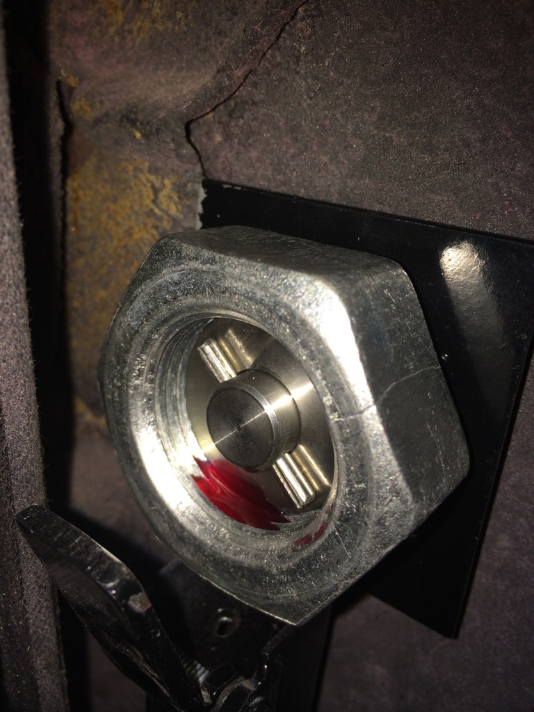

  12. Now we can put it all together-The door button is stainless steel-The hole is tight enough that you have to thread it through-make sure you thread through the bracket at the same time. You can see how close everything is to the glass-dont worry-you have enough room. I put the thick rubber gasket that is supplied between the bracket and the door skin-when you tighten things up-it will seal everything up. We also dont want to have to take the door apart to re-tighten this assembly-so I put a little puddle of red Loctite in the threads-make sure you have your cable run through the 'L' bracket BEFORE you tighten this big nut!down

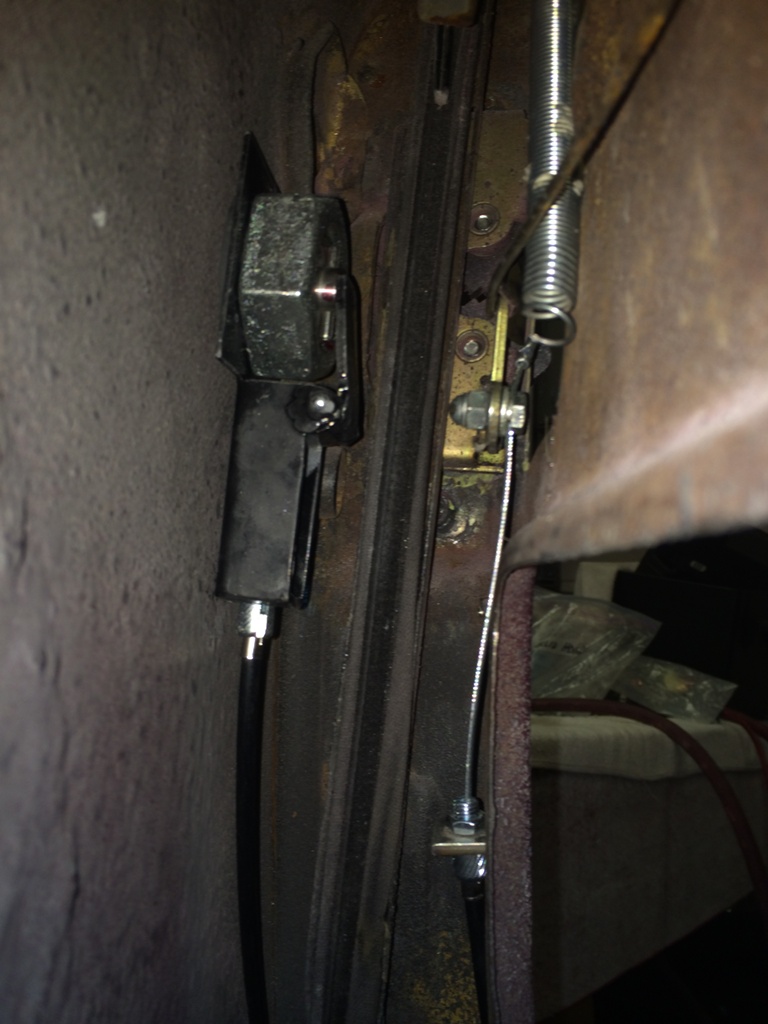

  13. This is what it looks like on the inside when you are done-The cable runs from the bracket below the glass and back up to the latch. The bear claw had a lever on it already with a hole drilled in it-I used a bicycle cable bolt and nut-with the hole drilled through it. Run the cable through the hole-pull it tight with pliers and tighten down the nut to keep the cable tight. You do need a return spring to put tension on the bear claw-that pulls the cable taught when the outside button is released-

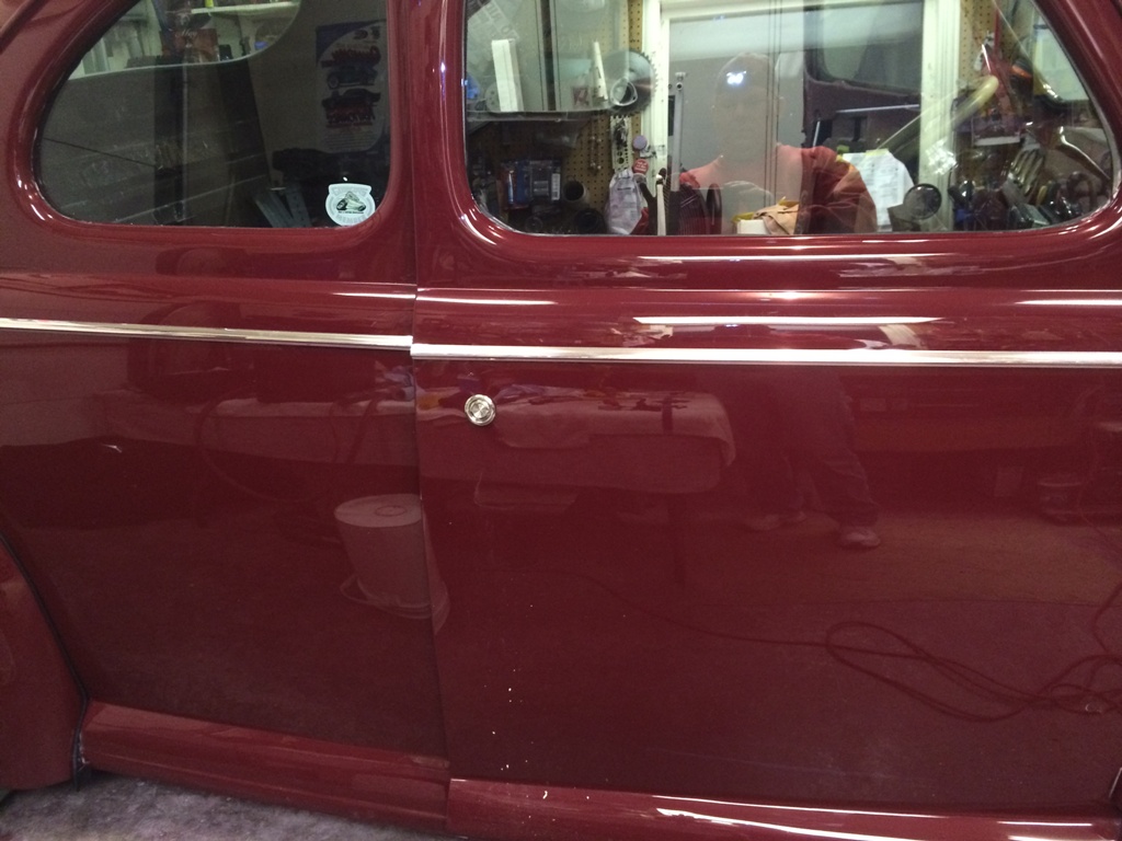

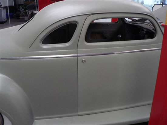

  14. Outside is clean and functional-
    The assembly has some weight to it when installed and the buttons have a nice 'feel' to them

    Very nice. Did you need to calculate the ratio of the levers, or just get lucky?
  20. I didnt actually calculate the ratio-but it is about 2:1- The horizontal part of the lever-where the cable is inserted has to be short enough that it doesnt interfere with the 'plunger' as it moves inward. The pic in post#5 gives you an idea of the 'ratio'.
    What I did do was a couple 'dry runs' where I mocked up the assembly and just held it in my hand-connected the cable and tested it to make sure it would work. I did all the R&D work before I cut a hole or welded anything.
