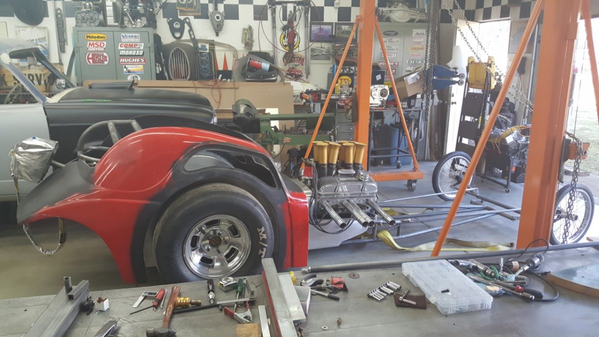

    I think it ended up being about 108'' wheelbase............still has a way to go......I need to upload a bunch of pics soon............Should be a blast to drive........For now it will run my little old 355 sbc that I ran in my Model A Pickup, probably w/ the six-two barrel setup I ran............Littleman

    How were the various brackets, pedals etc w the holes made.....water-jet

    A fine point sharpie and poster board template first..trace onto my material..I then will mill my holes......I cut everything out by hand on my band saw, sand to size by hand to match my template......I never had anything water jetted, I have no idea who does it locally.........I prefer to be able to make something in the back yard and not rely on anyone..........I love making brackets........I think they are Art...ha ha....Littleman
