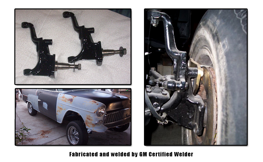

    ^^^^^^ Stacked spindles... There was a thread , think it got deleted.

  13. I'm interested. What is this?

    lumpy 63
    Basically two sets of spindles welded together... Google 55-57 chevy raised spindle's or stacked spindle's . BTW I am not condoning this method.

  26. Does anyone here on the HAMB have any pictures of these spindles. The clearer the better. Please post them if you would. Thank you.

    SUPER MODERATOR

    Google would also reveal this
