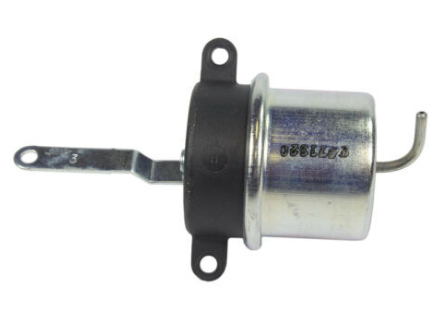

    Dan uses a couple of vacuum choke actuators, a plastic tank, some tubing, and a swinging Stainless steel hinged plate. So,.....you can do this if you want.

  10. If you're trying to build your own, look for a heat riser pull-off(GM), or headlight door actuator. Not common, but I found some at swap meets.

    I can see Vacuum as being nifty if the vacuum pull brings the plate down in sight and no vacuum lets a light spring pull it up out of the way. Plenty of heater and AC vacuum actuators kicking around that would be plenty strong.
    Just like any longer vacuum line you could use steel tubing for the majority of it and rubber at the ends.

    How about a cruise control bellow from a 70's vintage car? Engineered to hold against throttle return spring pressure, and is linear in design.

    A vacuum blend door actuator [from a heater]
    The great thing about vacuum is....... When you're "flat to the boards" when street racing there is no vacuum, so your plates automatically flip up :D
