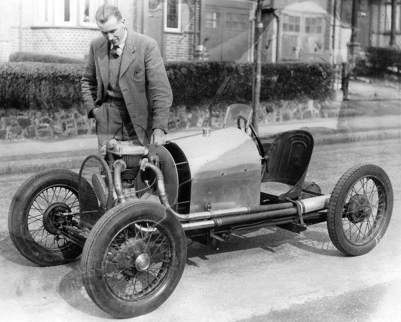

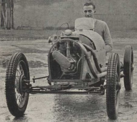

    This looks a lot like a trike I came across recently:
    Despite the Morgan-like look, the Hudlass-Jap had a 600cc JAP single behind the driver. It was built around 1924-6 by a young man whose father had built horseless carriages. The engine and transmission sat in a cradle that pivoted with the rear wheel so that the chain tension remained constant. Front suspension was by quarter-elliptic springs. It was set up for front brakes, but they weren't installed. In 1929, he started another special, which he completed in 1931, a this time a four-wheeler:
    Its 1100cc JAP twin drove through a Riley gearbox. The body was leathercloth covered plywood. In 1939 he began to stretch it to a four-seater. It ended up with a Riley engine and a pre-selector gearbox. That version was found in the mid-nineties minus the Riley engine and running IFS, which might not be part of the conversion to four-seater.

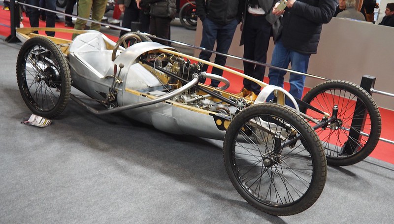

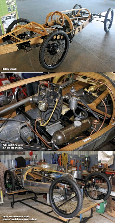

    Jappic @ this year's Retromobile. Is it @UKAde's or the New Zealand recreation? Apparently, the only distinguishing factor is that the New Zealand car runs a 500cc JAP KOC engine:
