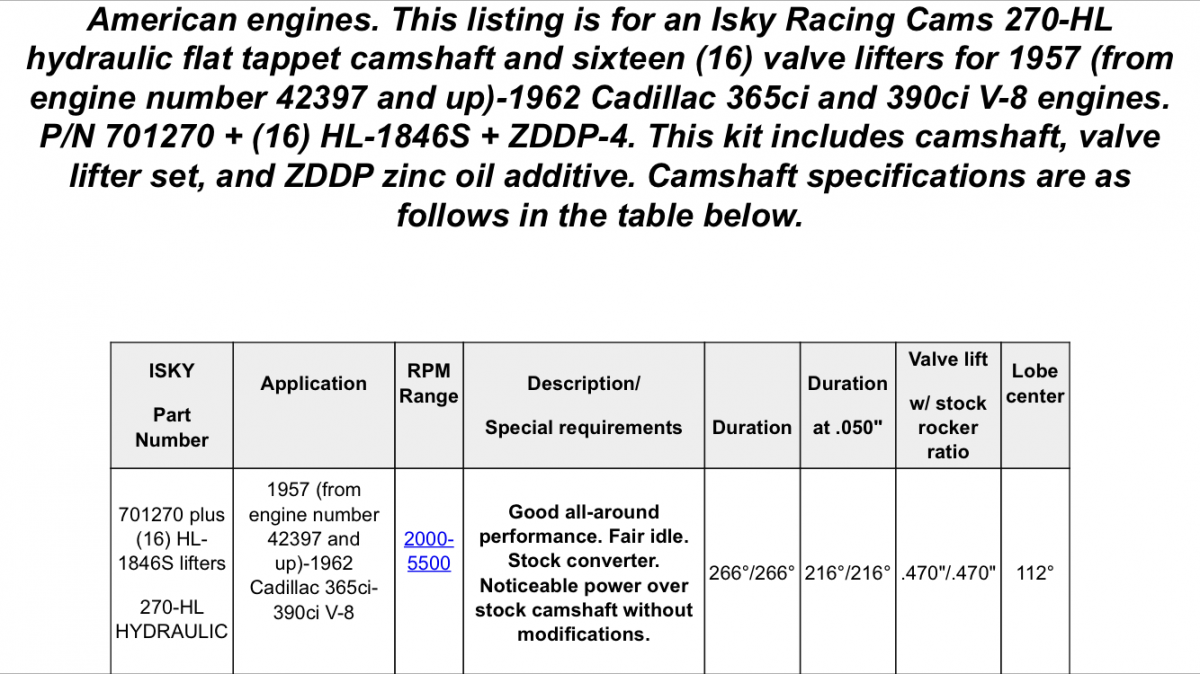

    Here it is.
    This cam allows you to use your stock style hydraulic lifters and push rods.

    Pete, I can't even find a pull down window on Isky's website for the Caddy. I can find the cam grind but it doesn't show what it fits. I'll have to look again.

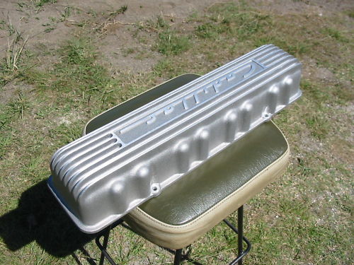

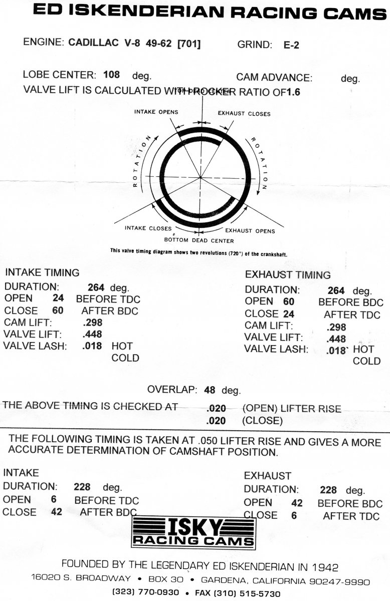

    This has been about 6 years ago, but when I bought the cam for my 331 Caddy, Isky Cams had to be contacted directly, by phone for all vintage cams. They didn't have any listing on their website or in their paper catalog for 49 - 62 Cadillac engines, (or any other vintage engines). In addition, there was a specific Isky employee who was in charge of the vintage cam grinds. This guy was only available by phone at specific times, (late in the day if I remember correctly). Needless to say, it took awhile to actually get the cam ordered. Once it was ordered, it was made quickly, though. By the way, this is a new cam, not a regrind.
    The cam is an E-2 grind with solid lifters. As far as valve covers, I found these on Ebay. They are new ones, made by Bell Auto Parts. The valve covers are excellent quality and fit very well.
    Isky E-2 Cam Specs.jpg Caddy Finned Valve Covers A.jpg Caddy Finned Valve Covers B.jpg

    Wow, those are nice. Does he still make them? I couldn't find anything online.
