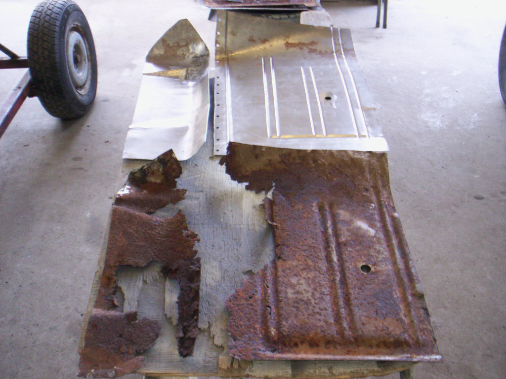

    Neat thread. I found a little trick when I rolled the beads in the floorpans for my rpu. I SUCK with a beadroller. I cannot roll a straight line for more than 2":eek:
    I set up some simple guides for the beadroller's dies to sit in. The dies I have are 1" wide. I used some 1" wide flat stock to set up a channel for the die to ride in. I set the guides 1" apart so the die would ride right down the middle. Can't go wrong, perfect straight lines every time.
    Here's some pics to show what I did, hopefully it will help the beadroller challenged like myself:
    Don't stress too much if you get a slight amount of warpage from rolling the beads. It will pull down flat when you clamp it in place to weld it down.

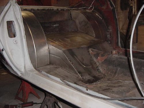

    Not the best shot, but the new passenger side floor (and rockers and rear quarter) in my '62 Monterey.
    Not as pretty as some of these other floors, but then again it will be getting the full carpet treatment as well.

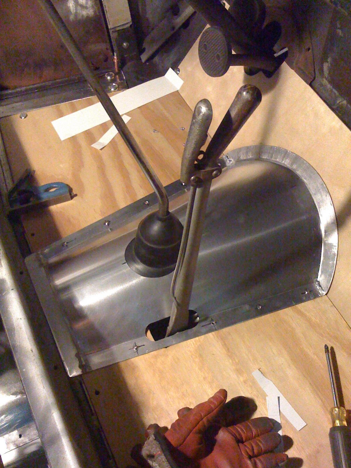

    A work-in-progress for my '34 Ford 5-W. When the transmission tunnel is complete the insulation and carpet will follow. The B&M shifter mounts on the top of the transmission tunnel.

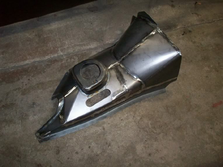

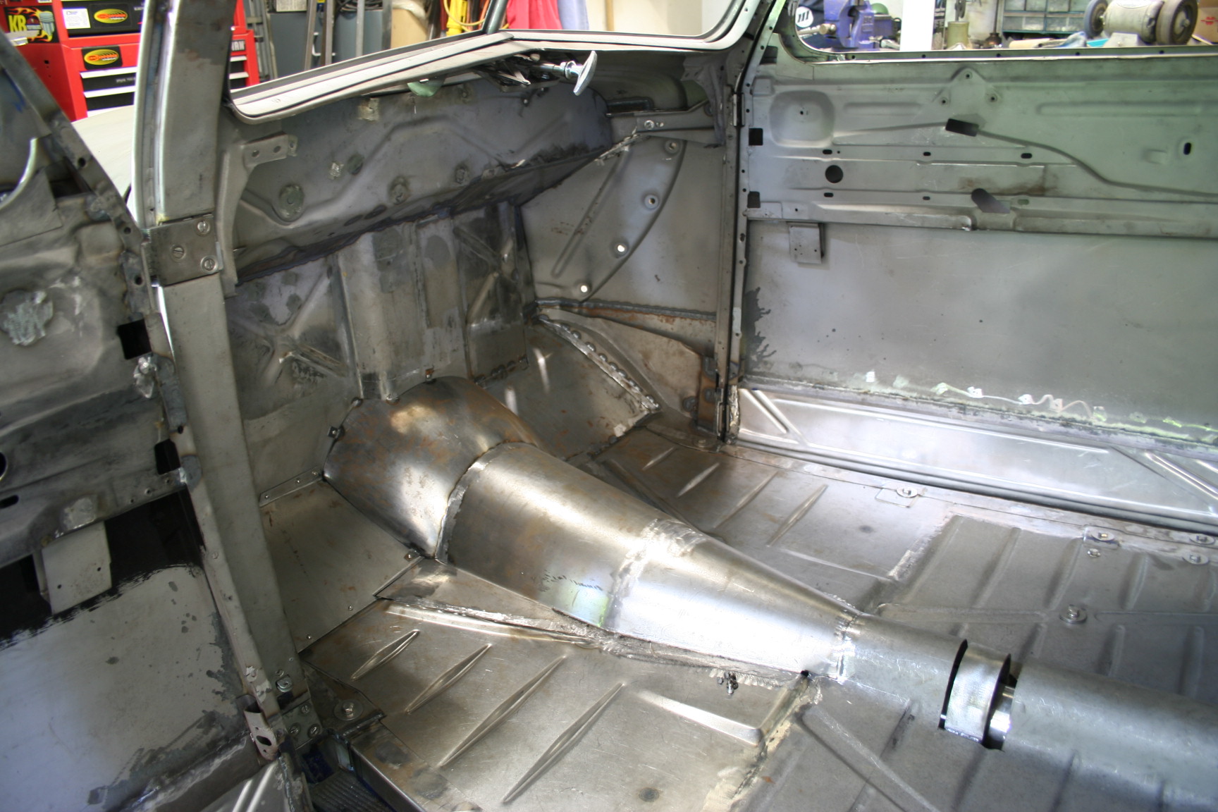

  12. Custom Belly Roller Action on this trans tunnel.

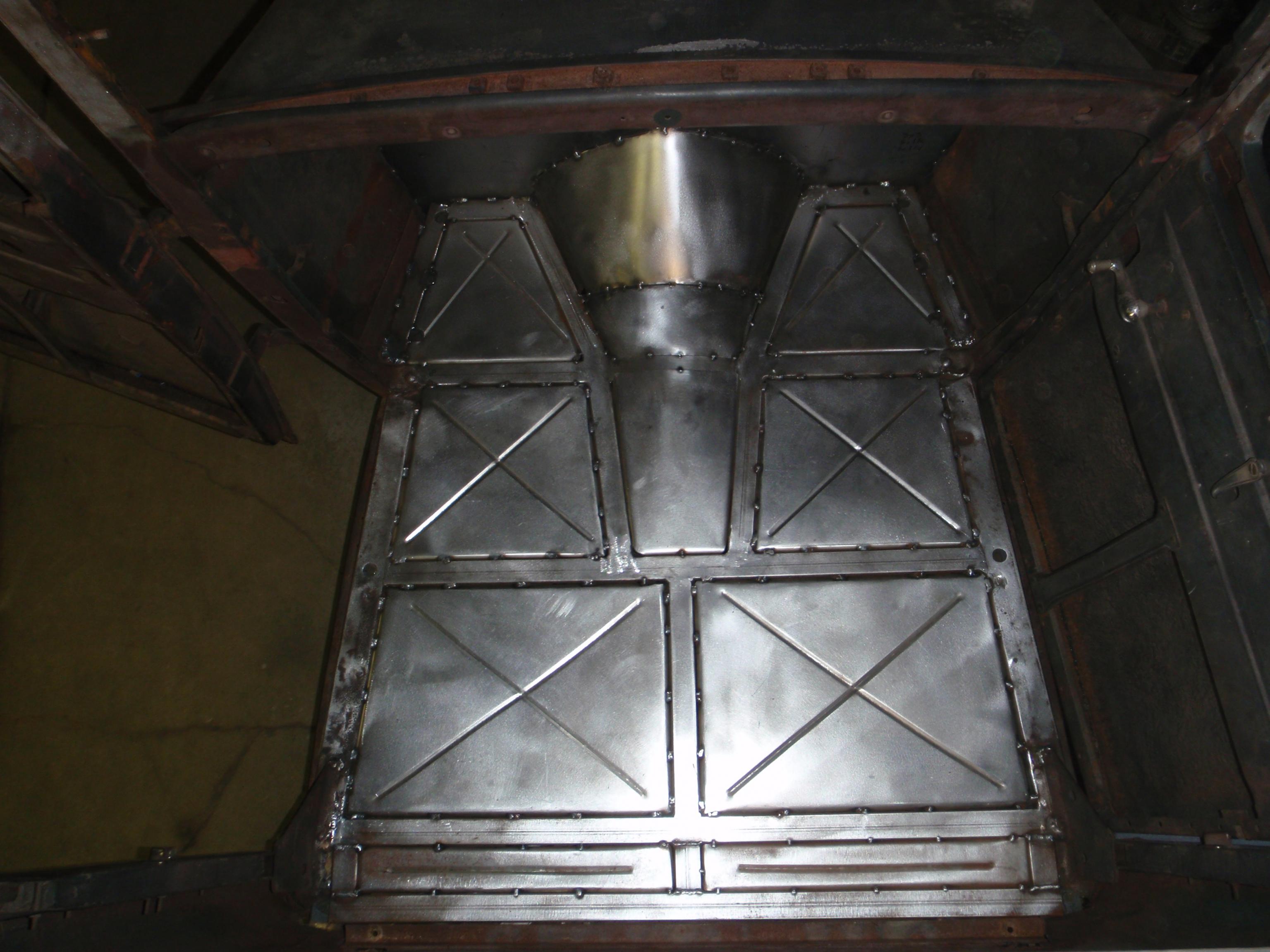

    "FITZEE", how did you make the panel with the four pointed star design??? That is amazing.:)
  17. fitzee
    Joined: Feb 26, 2003
    Posts: 2,862
    fitzee
    I overlap the beads then I work the cross sections with a hammer and dolly. On corners I end just short of each other then work with a hammer and dolly. I have only basic tools and would love to have more dies and build a press. For now I do with what I have.

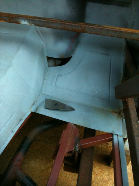

    Here are a few pics of my recent floor job...used 1x1 sq tube for the floor frame and 18ga sheet steel for the floor. Use propane tank, rubber hammer, my thigh, etc to get the radius's.

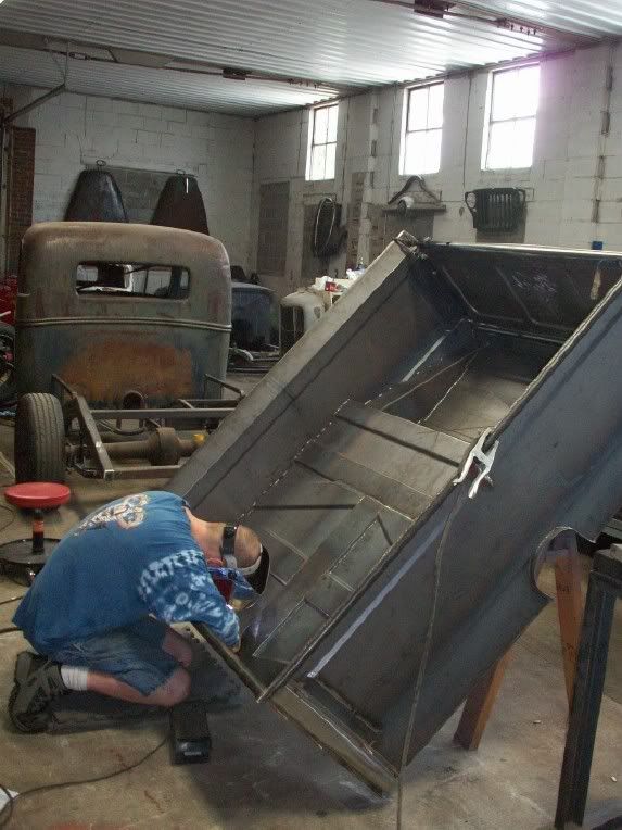

    Bed floors count???
    I got more but not posting pics of uninteresting off topic stuff!

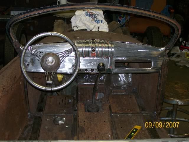

    Here is a quick pic of the floor I built in my 1935 PU and a couple of the floor I built for the 1949 F1 PU. I didnt put the time in the 49 tranny tunnel to make it round instead of angular like I would have liked to.
