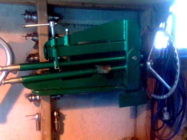

    mine-the bottom roller flexed when i first made it but added an extra 25x50mm box section to lower part.just use it mounted in vise as have limited workshop space.originally had a crank handle but that was a pain in the ass so changed to an old steering wheel,much easier to use.made various wheels including one to cut/form louvres.

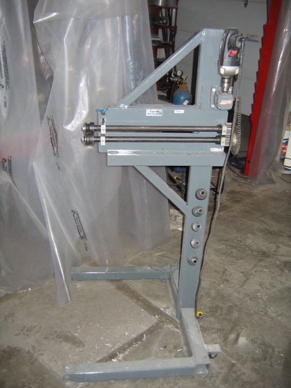

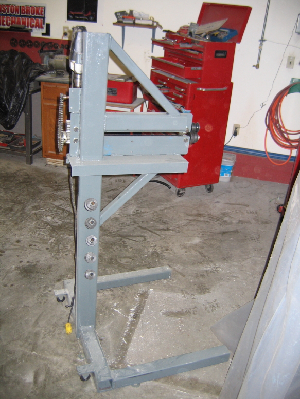

    Here is my friend Al's interpretation of the Harbour Freight basic bead roller.
    He built it in a day or so of puttering around with some metal that he and I gathered. Note the small wheels on the bottom. They sit above the floor, just tip the thing back and roll it around like a furniture dolly. Works great!

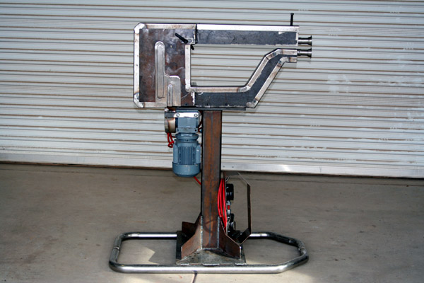

  5. Here's one we built, it was adapted to our planitary roller............................

    Nice!!
    Very smart idea. Hook it up to an Eagle roll bender!
