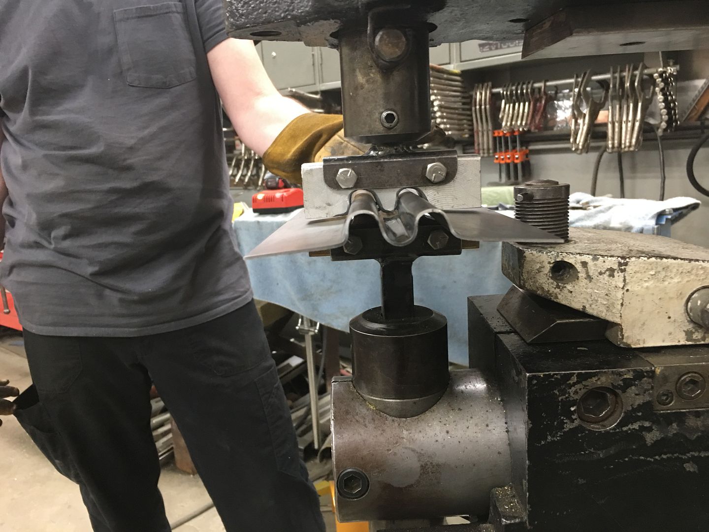

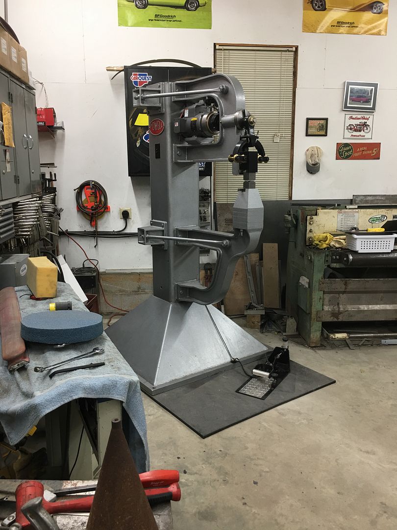

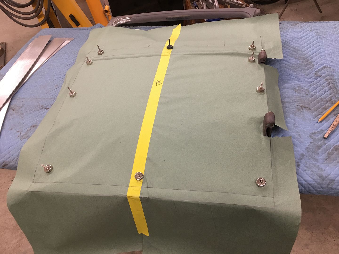

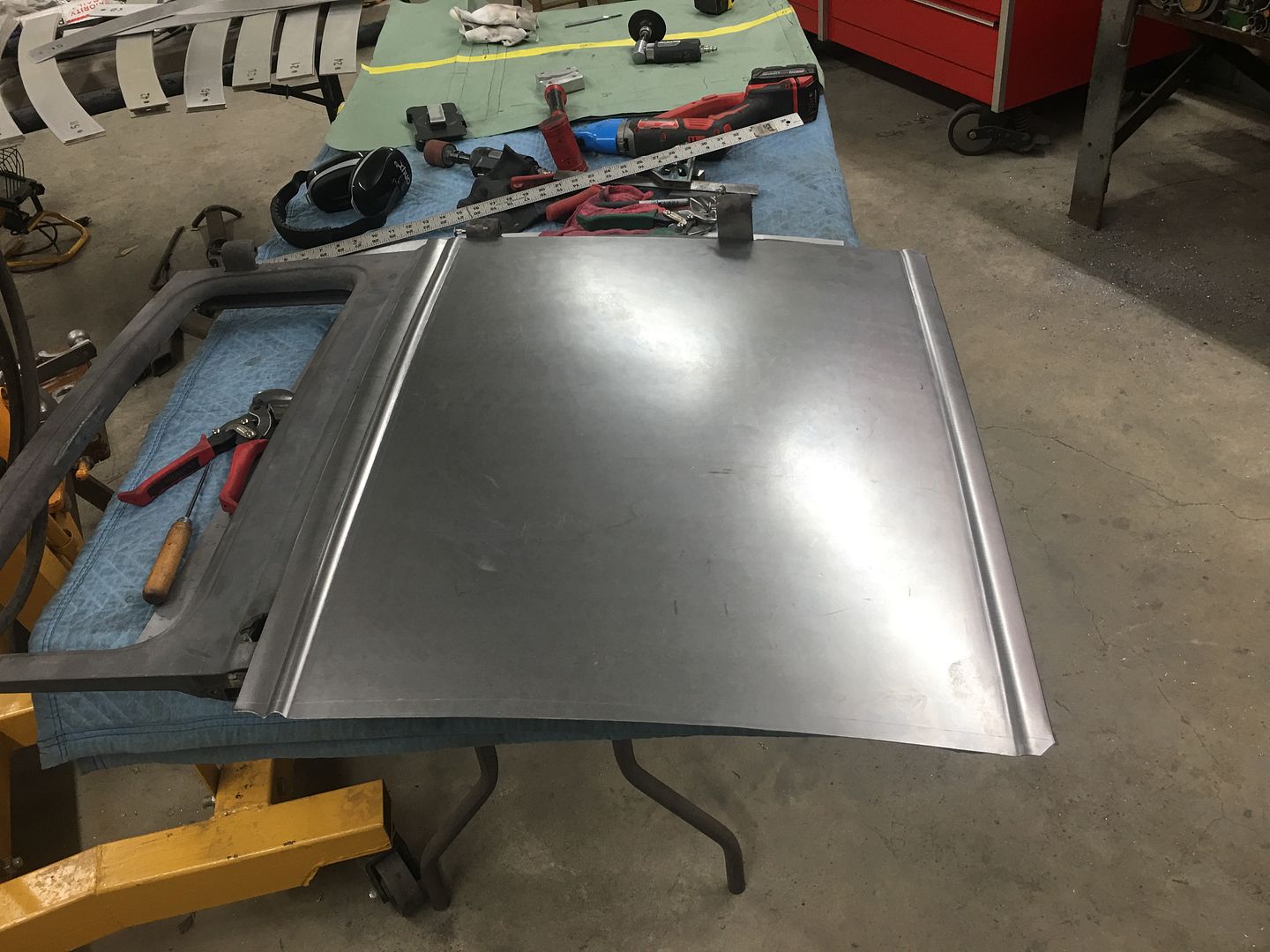

    Given the extent we opted to go ahead and make both door skins to have a more consistent finish on these. Paper patterns were taken to capture the pertinent details, and some oversized blanks were cut out of 18 Gauge cold rolled steel. The Powell hammer made made quick work of adding shape to the skin...

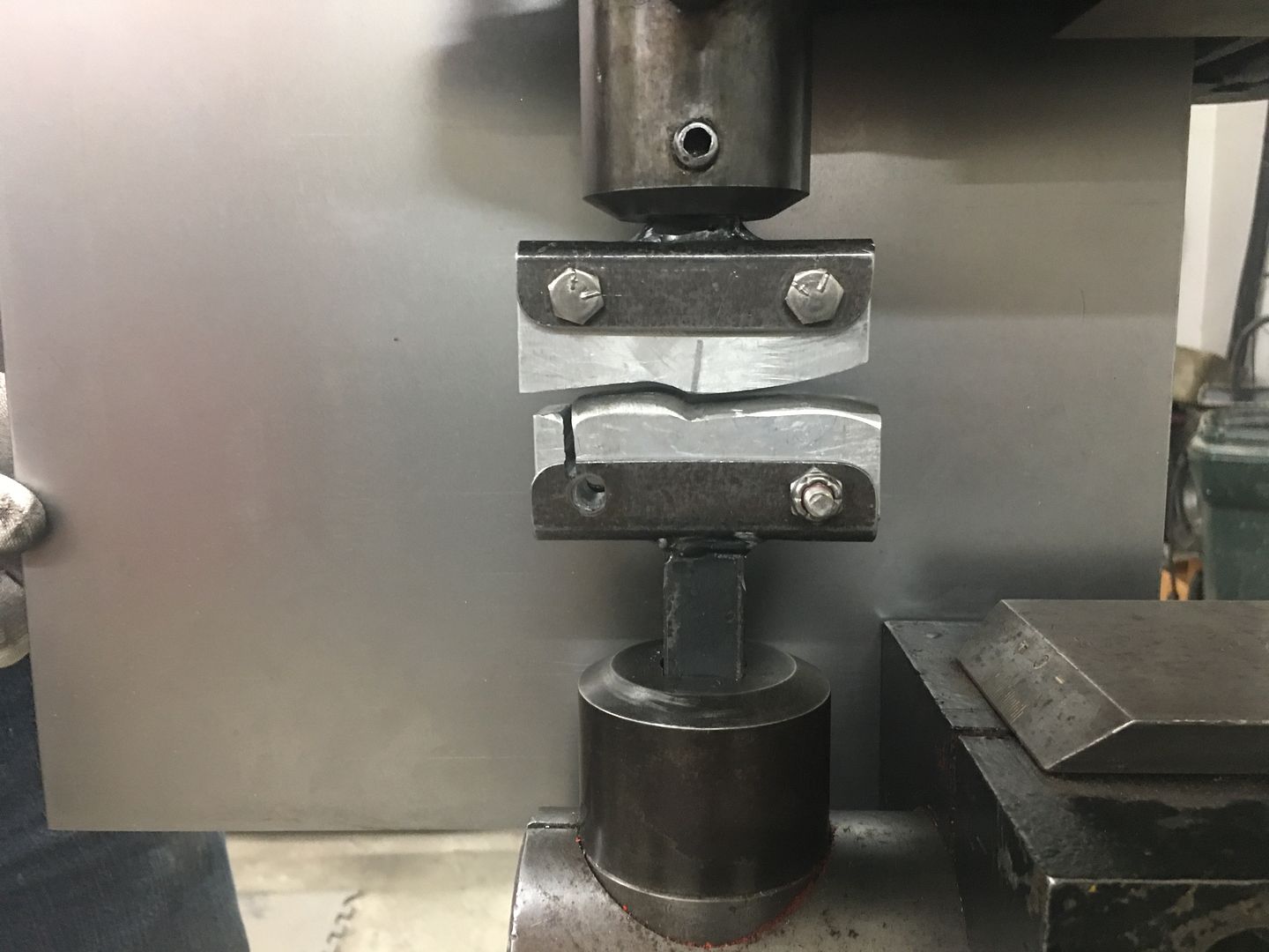

    Once we had our shape needed, the upper beltline bead was added using some aluminum dies we made for the Lennox nibbler.

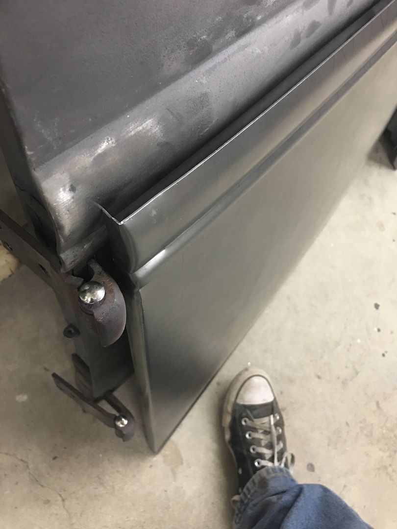

    For the lower bead detail, we wished to use the folded flange as a guide in the dies, so the tipping dies in the Lennox were used to fold the lower flange..
    Tipping the flange...
    Adding the lower bead detail
    the new skin was then test fit before we trimmed and folded the side flanges..
    The side flanges were folded over to 45* along the un-beaded area, then our dies for the Lennox clamped in their respective location by aligning the edge along the fold line and tightening in the bench vise. Then a body hammer folded the bead areas over to 90* and the remainder of the straight bends reinstalled into the tipping wheel and folded to 90*.
    Looks like these will make a much better job than trying to sort out the old skins..

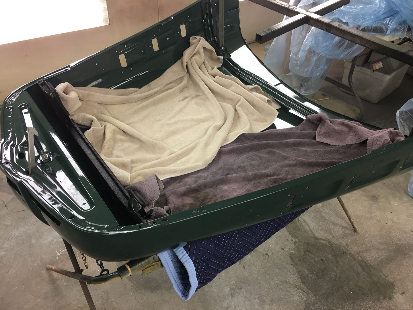

    Thought I'd do a progression of pictures to show the carnage we started with on the hood brace to where it was painted this past weekend....
    Note the wings left adjacent to the weld to act as heat sinks for welding to prevent the edge from burning back... They get trimmed off after welding is completed.
    No Body filler, just epoxy primer, basecoat, and clearcoat. Looks almost factory!!

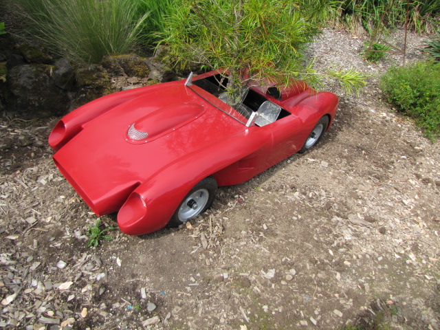

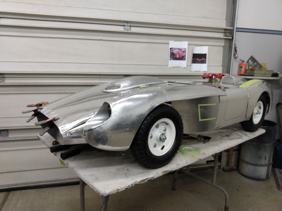

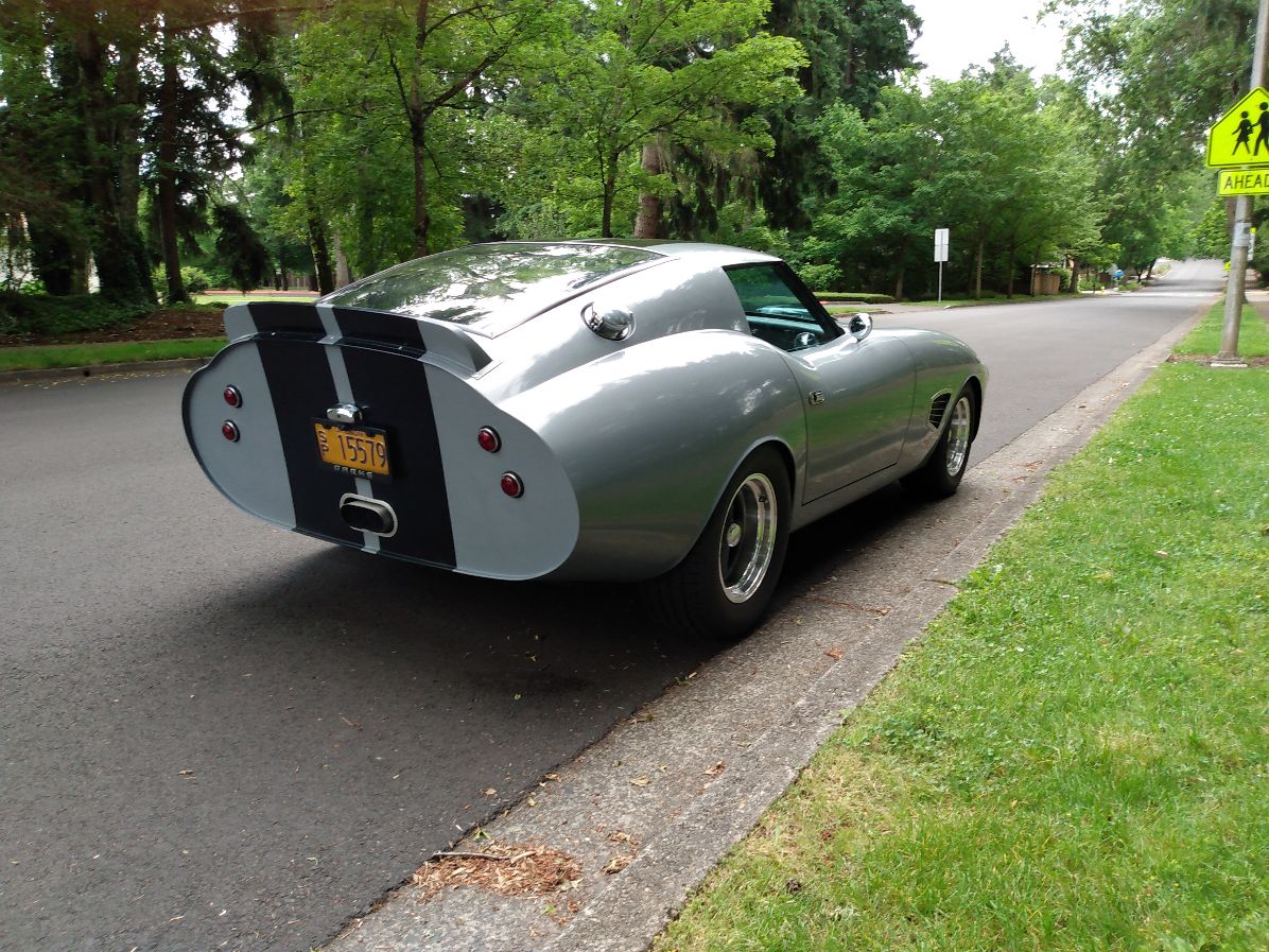

    Hey, Not been on here for a while. Finished a ferrari tr250 yard planter and finished my steel coupe.
    Still in lockdown but staying busy, Ray IMG_20200328_192109845_BURST000_COVER.jpg IMG_20200325_191241258_BURST000_COVER.jpg IMG_4753.jpg IMG_20200621_095401988_BURST000_COVER.jpg IMG_20200621_095546465_BURST001.jpg
    whtbaron, tb33anda3rd, 66gmc and 13 others like this.
  8. patsurf
    Joined: Jan 18, 2018
    Posts: 1,036
    patsurf
  9. frankinplymouth
    Joined: Sep 6, 2008
    Posts: 358
    frankinplymouth
    it's about 5 feet long. so about 3rd scale.

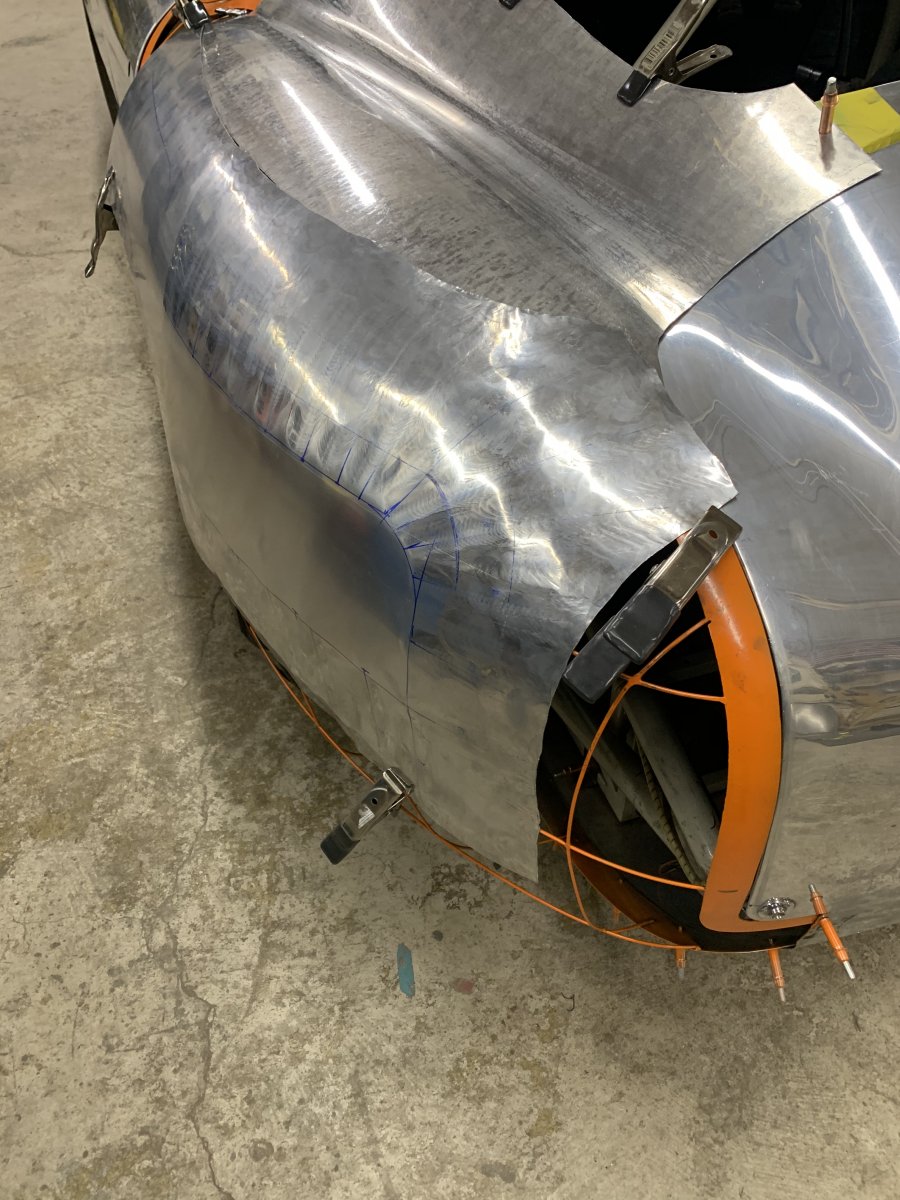

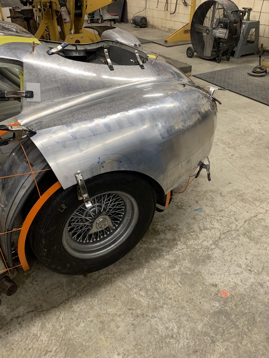

    I have been absent for a while. Just been covered up with work and trying to stay motivated.
    sticking with this thread here are some metal shaping projects I have been working on lately

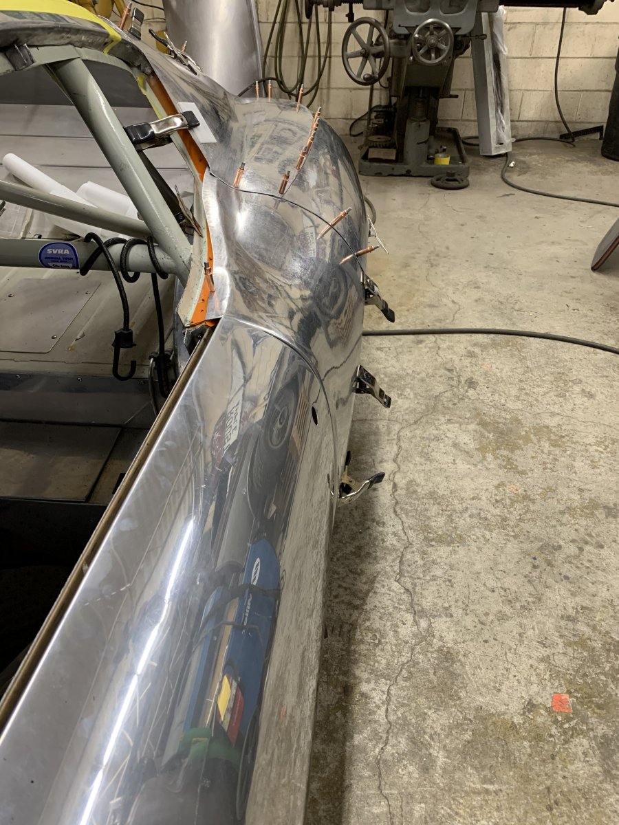

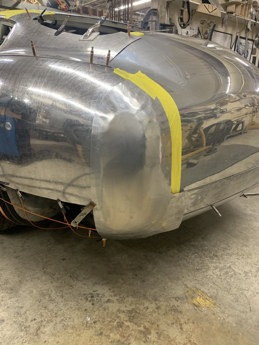

    61 Aston Martin Zagato quarter panel
    01FB416A-67C1-4744-B586-28ED5393EFF1.jpeg A64EB6E9-F6C4-4EE1-BDE5-4E1C70BE6F61.jpeg BBF74E96-249F-4766-AAE7-5C9EB8FBDA47.jpeg CF56E59E-56C4-4783-84A9-C937ABE2BA74.jpeg CD7AAD7D-9638-4C59-8FA0-4C6281BD276A.jpeg 1A823D1C-E83F-4133-8A23-13A2E81A4C37.jpeg 3F1909FB-47FB-4677-976A-F7D251D97DDF.jpeg D1DFC46F-03F4-4371-B7A8-706487DE11E0.jpeg EA2F4F95-6853-473D-B346-F8710D96B5C9.jpeg D210DCF7-EF0D-421B-9A71-0C9B2E477313.jpeg FF4437C4-56ED-4CD5-BF99-363462DE037A.jpeg 9CC00244-56B5-4C60-A9A0-2E52FE3ADC5A.jpeg 43ABD8F6-D0D6-40EA-BC77-01BE4325BF4F.jpeg BDE2DD10-3056-474C-AF5D-E693803F941E.jpeg 3B2127A7-EEDB-49A3-A210-6381B553A4E4.jpeg A0C505F3-FB59-4777-98A1-DD40629DBE2F.jpeg 852487AA-7844-43A6-A7ED-67FBC7055ABF.jpeg A0842FF4-0AA7-428B-9088-E916A3B2DB49.jpeg 3DEC04BC-CDAA-4111-B1C7-162C6AA5104C.jpeg 5780C134-96B0-4D87-A036-EB6837D0D975.jpeg 653DDBD4-9A8C-40AB-9777-168175736B12.jpeg A8EC1338-1603-4FED-99F1-1B880FE2E9D7.jpeg 3DC55A56-7008-4BBE-BDA6-0D2D59DFA785.jpeg 859F0B5D-8ACA-4FEA-8187-EA024825C5E5.jpeg
    TigerFan, BradinNC, chrisp and 18 others like this.

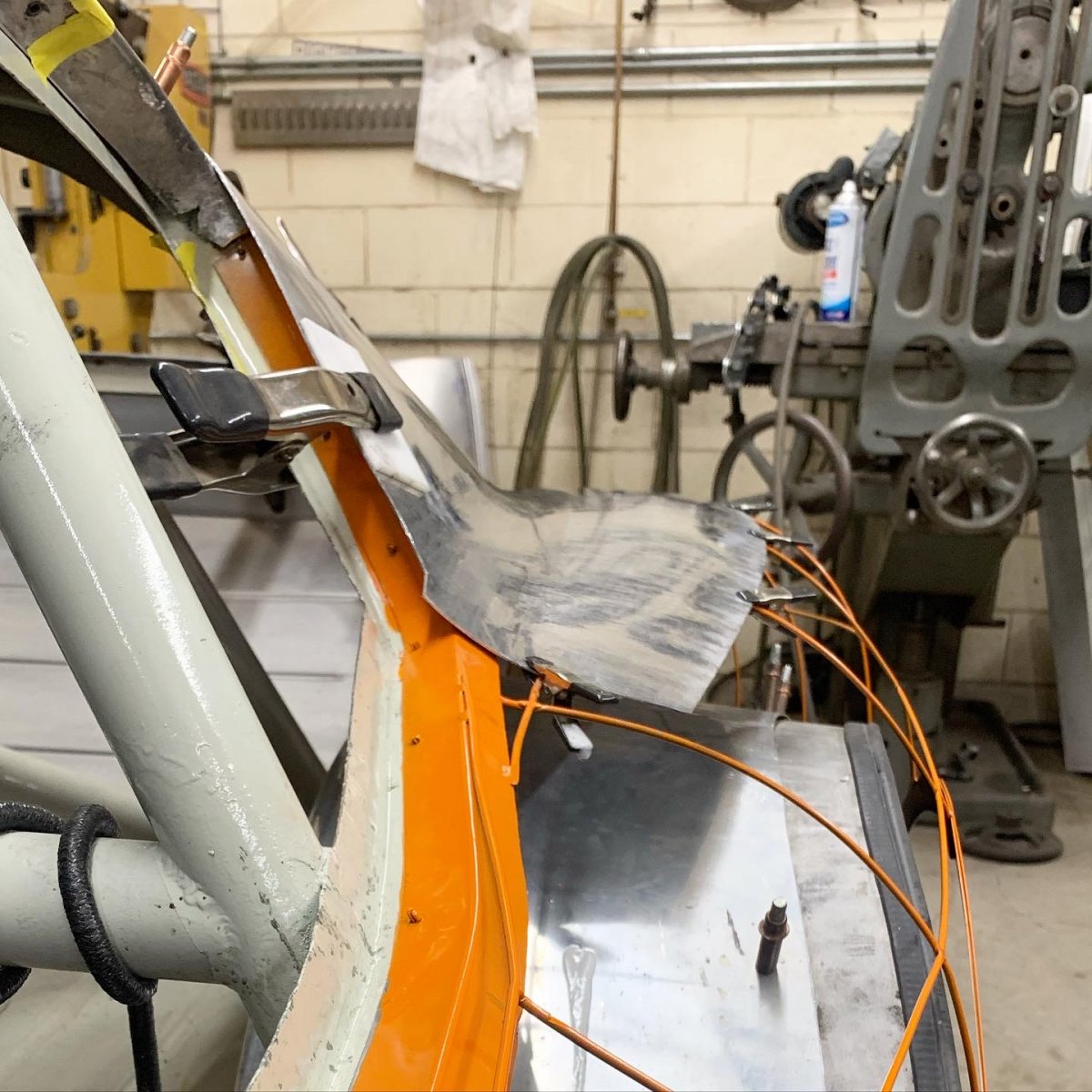

    Does the orange wireform stay in place forever or get removed when the quarter panel is finished? Does it need to be cut apart to be removed?

    It will be removed once all the panels are shaped and welded together. It can be removed in one piece with the quarter panel is not on the car.

    I see. I have never used that technique - only wooden bucks. Is it ever necessary that the wireform be a bolt-together affair (like for an entire rear end) so it can be removed without a "die lock" condition?

    I use a lot of wood bucks but a wire form made more sense for this application. You can bolt wire forms together if need be, but it would be a rare occasion. Since you are making the pieces individually then fitting and welding them together as one unit. Then installing on the car ( even a complete rear section. You will have access to remove wire form before sheet metal is permanently attached to the car

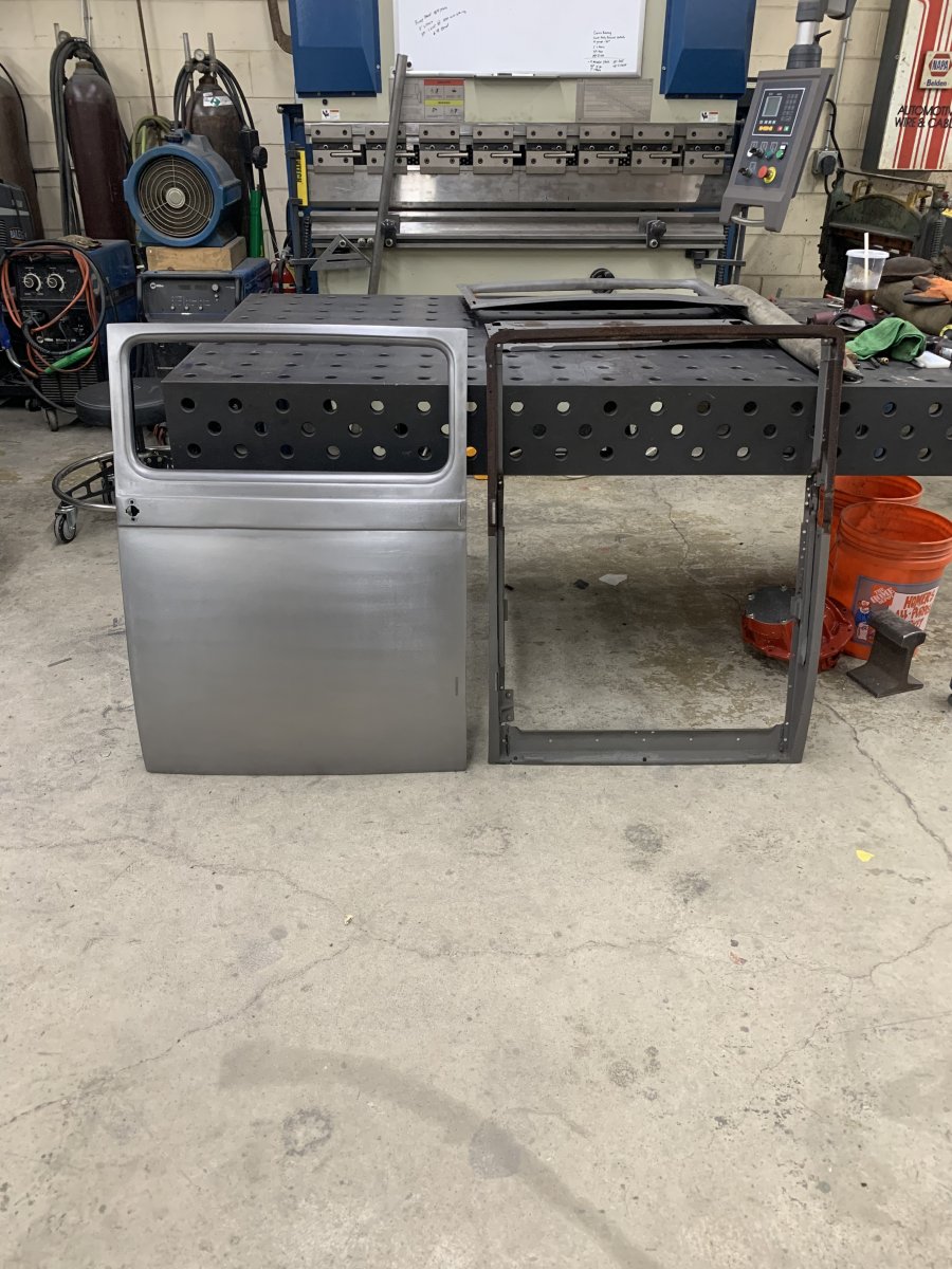

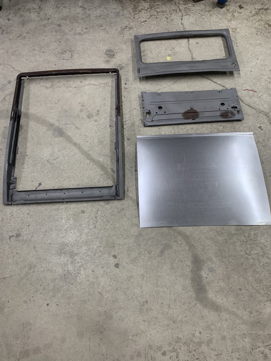

    A8A02B63-C133-4D03-870F-0928FB424A49.jpeg 71DBB0E0-870E-4F5D-8D85-F0CD7FBBF822.jpeg 6C956AD2-C7BD-4381-9B51-F79FB28D8B7F.jpeg 40F8973C-084F-47DA-A5D3-0E53BE9A581D.jpeg D18E09C0-3485-49C2-B73E-4D1659D39E84.jpeg 7957A42F-373F-43ED-9E44-27C728301E53.jpeg 158FEBD6-B836-42D7-82E7-F6A9E8D06109.jpeg Some model a door work. I take the doors all the way down the bare inner frame and repair and rebuild on my way back out
