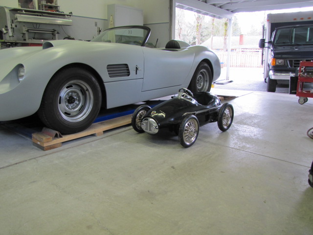

    Well it wasn't supposed to rain in the mid-Atlantic states today until later tonight, but wouldn't you know, loading something in the back of the truck just seems to coax the precipitation from the sky.
    And here we are, unloaded back in the shop, still needing to make the stand. I'll pick up some materials likely on Monday..
