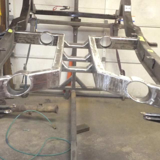

    I am in the process of rebuild the suspension on my 53 Bel Air and cleaning it up for paint.
    Rebuilding the original front with parts from Kanter and getting ready to install a notch to the rear.
    Been going back and forth with the idea of 60's truck arms for the rear setup.
    The other is the trans crossmember, to cut the original or install a tube one.
    So here are some pictures of mine.

    that looks great!! About to start on mine for my 51 chevy coupe.

    Chaddilac - Good Luck with the 51! Hope your frame doesn't have as much undercoating as mine did. Had to use a scaler, paint stripper, and glass media.

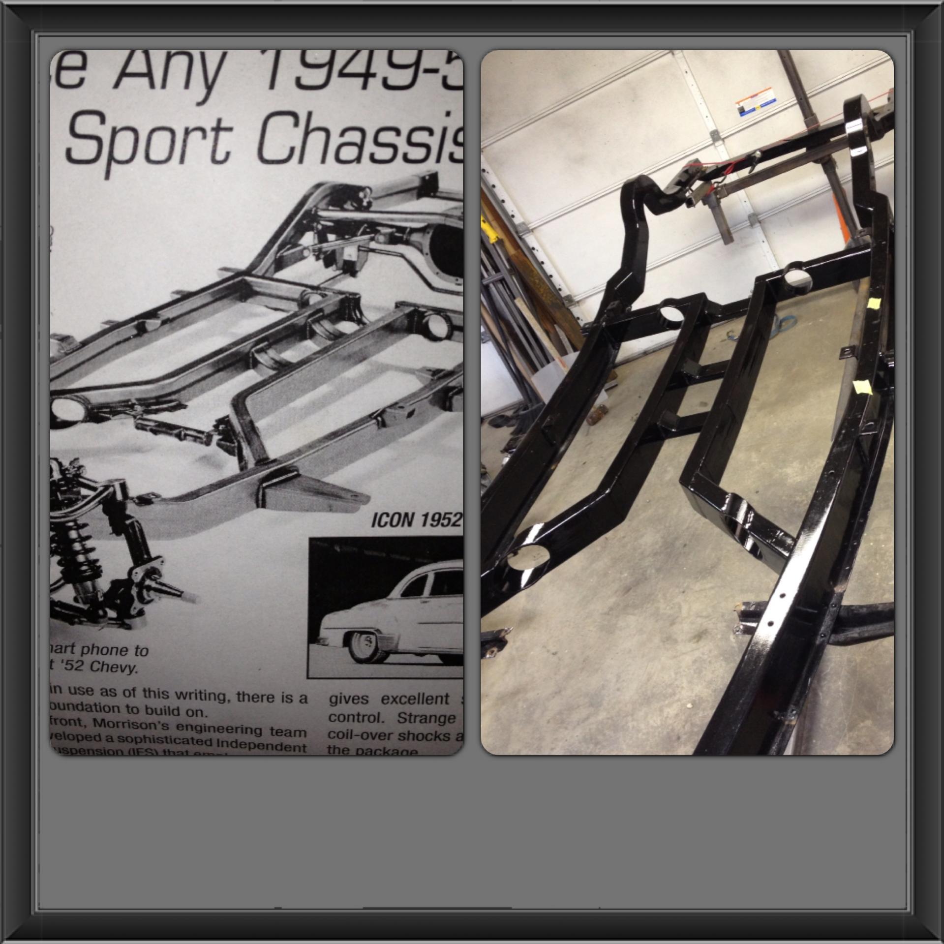

  6. This is one I have been working on for my 51 it almost done!

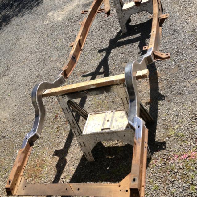

    Almost ready to start on the 55 f100 frame this one is gonna have a camaro front end and I'm torn between a notch or z the rear. The goal is as low as possible with no bags

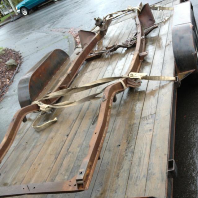

  12. Thought I'd lower the tone. Cleanin' up my '56 aussie front crossmember piece. Gets amazing how stuff was driven with parts missing, generally botched. New mount rubbers & bolts & paint it black- should be nice.

    If your going to bag it a truck arm set up would work and you could go with a two piece driveshaft so that you would not have to re work as much tunnel area at the back seat.I used a gambeano(spelling) step notch and it worked great.I went with 3 drop posies springs and 23/4 blocks so im right at the scrub line.The height of the rear wheel well lip is 18 1/2 off grade.
