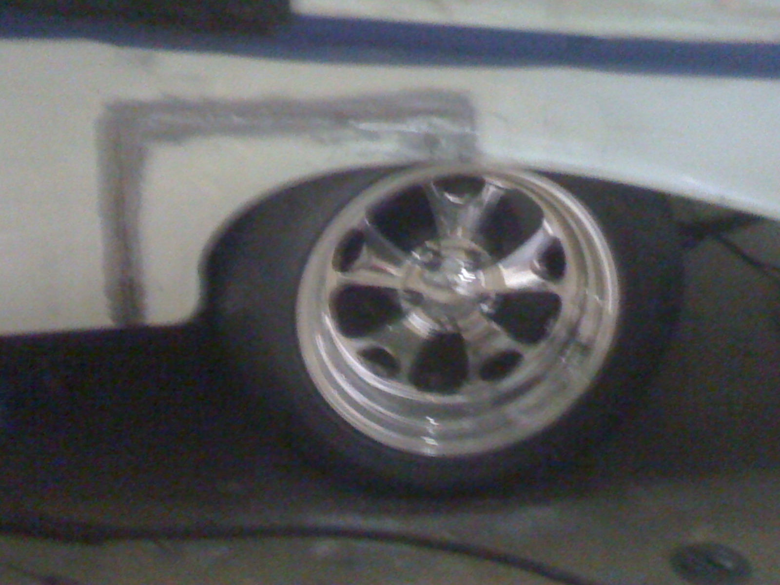

    too small of a side wall
    cut this section out
    I moved the section forward 2 inchs
    I cut a piece of sheet metal 2 inchs wide and a random length long and broke the piece at 3 degrees and tacked it at the bottom of the qaurter
    I worked the metal with a hammer and dolly as i tacked it in place, once tacked in I then cut off the the top at the cut
    now that everything fits nice I finished welding it out. Even if you take your time not to warp your metal with weld, you can still warp it with your grinder. Maybe someone can get some good out of this. And yea its got billet wheels, but it pays my bills. Check us out at streetrodspecialties.com

    Nice work but wouldn't be easier to just move the axle back a couple inches on the springs?

    probly so but it wouldnt be near as much fun. I guess sometimes you got to think outside the box, or have someone else look in the box
  6. Nope. Moving the rear back 2 inches means redrilling springs, longer brake line, and having another driveshaft made. I agree that moving that rear back would fit the tire, this way fits the tire AND changes the look of the quarter just enough to know that something is different.....

    I'm not seeing what the original problem was
  8. The owner changed his mind on the wheel and tire combo he had picked out a year ago. The taller tire didnt "fit" the opening. He didnt want the low profile look but didnt want the whole thing to look "full" of tire either......thats the best way I know to describe it, kinda reaching a happy medium if you will.

    So..... you think cutting up a car that looks to have pretty decent paint is easier than a brake line, driveshaft,and a half hour with a drill?

    six too one half a dozen to the other. By opening the wheel well it made it more proportional than moving the rearend back. Oh yea the paint is only 3 weeks oldand yea its decent 10k decent,but my clients want what they want, hell I thought someone on the HAMB would learn from this article, instead I being hammered for it

  13. So what is the OD of those rubber band tires ? I ask because i'm running 29" tall tires and moved rear forward 1" and I only lengthed my wheel opening 1".
  14. I don't think you're being hammered for it. You will find that HAMB'rs get pretty emotional with their opinions. You did a nice job and yeah people do that all the time on race cars for tire clearance. Looks way better than moving the axle back...

    theyre 29 tall but they didnt fit for shit, the whole problem was that I fitted the car for 26 inch in the rear when I was mocking everything up.

    Moving the axle back would give a more streched look. Good work but think the bigger wheel opening looks like crap.
    The owner belongs to the more money that brains club.
  21. I just recalled that Five Sevens ran 14s and not 15" wheels like the 55 and 56s. That could be why you had to go 2" on the stretch.
