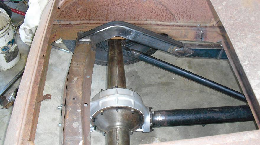

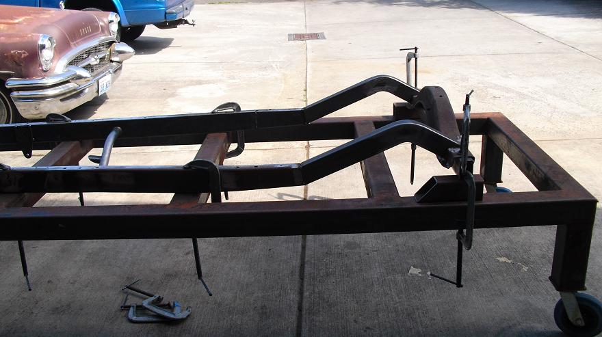

  4. Paul
    Joined: Aug 29, 2002
    Posts: 16,413
    Paul
    Editor
    yep, I moved mine back 7-3/8" too,
    here's an early build picture
    Cliff Ramsdell and sko_ford like this.

    Thanks a lot guys! Hey Paul, Looks like I'm doing something similar to your picture. Quick change and modified A spring. I don't really want a low car, and was thinking of trying no kick-up. How much is yours kicked-up and could you post a pic of how the car sat? I would really appreciate it.

    Mine isn't kicked up (sorry I'm old and don't know how to post pictures) The spring behind configuration will lower the car a bunch, maybe 5 inches or so. I became concerned about the distance between the axle and the frame in case of bottoming. I raised my chassis an inch by adding a piece of rectangular tubing between the crossmember and the rear spring. I took a couple leaves out of the rear spring to soften the ride, and that lowered it some too. I may put a snubber at the contact point between the axle and frame.

    rear cross member is two inches higher than stock.
    sko_ford likes this.
