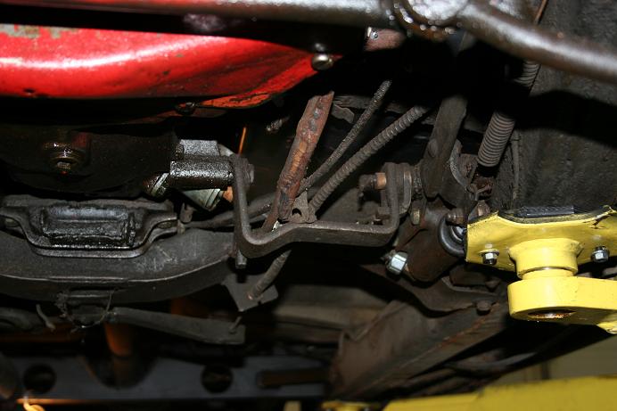

    im kind of curious to see where and how everybody is running the left down pipe for headers on a Flathead in a 49-51 Shoebox ford with all of this clutch linkage in the way. Ive thought about reworking it and possibly flipping it too. the cobbled up linkage the previous owner made is being replaced too. theres no damn room for a pipe. my car is airbagged and lays too low to just run it underneath. what have you or have you seen done?

    Posts: 109
    Stafford
    from N. Georgia
