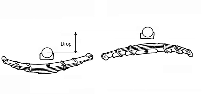

    Been thinking about different ways to static drop my '52 fleetline and I'm still tossing around ideas with the leaf springs. So today I come to ask the members of the HAMB what they think about an idea...
    What if you disassemble the leaf spring and flipped each spring upside down and put them back together.... then relocate the leaf springs inside the frame rails so they have clearance to flex upwards.
    My theory is that by flipping each spring it is acting in the same way except the spring's overall length would decrease as it flexes instead of getting longer as it would have before. The only problem I can forsee would be that the springs might try to "dig in" to each other since they are flipped. I think this could be solved by filing the ends smooth.
    Thoughts?
    I'll see if I can sketch something up to make it more clear...

    Here's what I'm thinking

    the best way to do it and still use the stock springs would be to just remove a few leaves. If that if still to high then you could take it to a spring shop and have them lower the arch. Just remember that once they lower it the arch can not be brought back up. Spring steel has a memory for arch. It will always fall back down to it's lowest arch eventually.

    Your individual leaves are designed to rub against each other causing friction to dampen natural frequency oscillations. What you have proposed will have the leaves pulling away from each other and losing the dampening effect. It would also put all the strain on the rebound clips that are designed only to keep the leaves in alignment and in contact with each other. The next problem is frame-to-axle housing clearance.
    As springer suggested, de-arch the spring. I would add that you could also reverse the eyes on the main leaf for a little more drop. FWIW the mid- 60s Mopars rear springs sat flat at factory ride height - they had no arch and had a decent ride.

    The stock springs are pretty small to begin with, I do not want to run less of them. I can de-arch them myself, but I was thinking about trying something new instead...
    If you look closer at my diagram and description I said I would re-stack the springs. I would not simply flip the spring over and re-mount it. Therefore, the individual leaves will still rub against each other and still have the dampening effect. I would also chamfer the ends of each spring to ensure that they do not dig into each other. As far as frame/axle clearance, I will be notching the frame for clearance.

    if you can re-arch the springs yourself, what is the purpose of the flipping thing? i don`t understand....

    I think i would go a different route, it is not "DESIGNED" to be put upside down....

    Same concept as de-arching the main leaf and flipping the eyes with even more drop. It would keep you from needing to remove springs or use blocks. Then you don't have to worry about scrub line either.

    Remove a leaf or two and/or reverse the rear eye from under to over the spring, provided there is clearance with shackles and chassis? May only be 1 1/2" - 2". is this sufficient?

    Because I would need 4" blocks and completely de-arched springs to even come close to getting it low enough.

    I've spent several years, off and on, lowering my '86 Dodge truck. I don't like bags, and I sure don't like lowering blocks or flipping springs, which, incidently, will not work well at all, and they won't last long when used in the fashion you suggest. (I thought about doing that once, but talked to some leaf spring mfg guys who advised against it).
