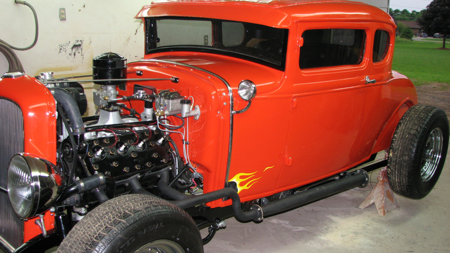

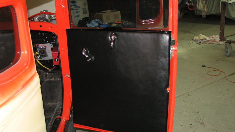

    Progress is being made. A few more pictures. The interior is in all except for the carpet. The seat is a Model A rumble seat that was modified to fit squarely over the torque tube hump. The interior panels are covered in the same material (black vinyl). Grille and radiator have been installed. The SW gauges are in the dash and the whole unit will be installed in a couple of days. No tach, but you can see the rev limiter on the ignition box.

    You gonna run a fan mounted on the alternator? If so, tell me about the pulley. If not, what fan set up will you use?

    Here is a picture of the electric fan between the radiator and grille. The alternator actually has the correct pulley to mount an original 1934 fan, but there is absolutely no room between the electronic distributor and the radiator. The guy that makes the alternator conversion for flatheads turns the armature shaft to fit the correct flathead pulley, that way it will work in an original flathead setup.

    Dash and steering went in today. Steering wheel is from a 1937 Ford stockcar that was raced locally. Used a modified 36 horn button. Dash is wired (95%) and all is systems are being tested. More to come.

    Something about a car in fresh clearcoat. The guys were ragging on me for putting the headers too close to the body. I don't think they are right, but that gave me an idea to "beat the heat". I had Carl from Cain's Hotrods come over and airbrush in some singed
    paint and small traditional flames. The black, grey ,white and yellow look good against the bright orange paint. Final assembly and testing start Monday. More to come.

    Exhaust work looks pretty cool..
