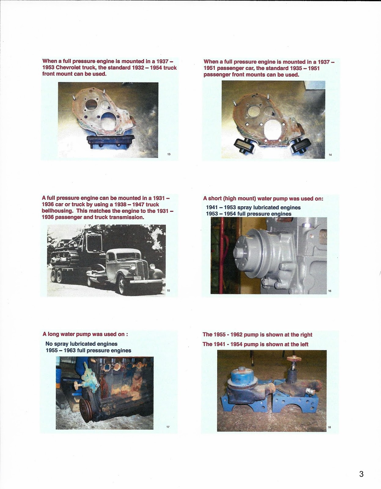

  28. mr.chevrolet
    Joined: Jul 19, 2006
    Posts: 8,897
    mr.chevrolet
    from an old Patricks catalogue, hope you can read it. swap1.jpg swap2.jpg swap3.jpg swap4.jpg swap5.jpg
    tb33anda3rd and mcsfabrication like this.

    Ok, so yes, 37 to 62 engines are very similar, but the original post was about a 33 with a 207. My first suggestion was a V-8 swap... not happening. My 2nd suggestion was a full oiler 235, but he has found a "deal" on a full babbit 216 with a tranny ( probably the one positive in this narrative) so that's where he's going. At least if he sorts out the motor mount and clutch linkages, he'll be set up for an easy swap to a 235 next time around.
