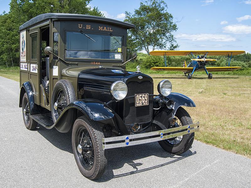

    The37Kid
    This would be a good place to post whatever info you have on "Commercial Cowls" I think I've had 4-5 over the years they all had three screws on the top piece, nothing like the one in the OP. Even if the sides are setup for hinges the top rail and top tin are different than Roadster/Touring. This is an original '31 Mail Truck with the Commercial Cowl. Bob dsc_0256_web__large.jpg

  7. cody1958
    Joined: Sep 19, 2006
    Posts: 828
    cody1958
    from wichita ks
    That mail truck is cool as hell
  8. The37Kid
    Joined: Apr 30, 2004
    Posts: 27,228
    The37Kid
    I saw it at Hershey last year it is far nicer in person than any photo. Bob
