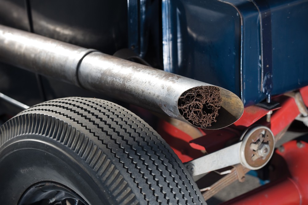

    Sound? I'm not sure what impact I will have... but, this is the plan... I contacted an Alliance Vendor - Cone Engineering and ordered 4 sections of 12" louver cores 1 3/4" and they custom lazer cut baffel rings for the driveshaft ID... they didn't recommend the way I'm utilizing thier components (they felt that the 12" louver core was sufficient) but Carey cut down the non louvered sections and welded two together for an extended length... the rings will be tack welded through the inlet port openings prior the welding the individual tubes to the collector... A to B will not have any packing.. B to C will have the top section cut out... C to D will be wrapped/packed with steel wool...
    Carey checking maximum length an baffel ring locations...
    Section removed from B to C

    Generally on these style of headers you want the muffling device to start after the last primary tube has come into the cone so that it is working with equal force on each of the primary tubes. Again, that is strictly based on standard practices and doesn't mean another way might not be better. So much in the exhaust world is trial and error that you can't really know for sure what is going to work until you try it.
    It is even more difficult when you cross over from performance into sound quality. What sounds great to one person might sound awful to the next. It's almost as bad as telling someone what the best color would be to paint their car.
    I'm really anxious to hear how this turns out! It's definitely unique!

    Would you wrap between A & B ?
    Any concerns with welding it in ? I'm concerned with how well the stainless steel wool will hold up over time
    Any recommendations or thoughts on additional modification?
    Side note: These guys have a quality product and even with the custom lazer rings the delivery was fast... I guess thats why we rely on Alliance Members!
  15. coneeng
    Joined: Jul 29, 2008
    Posts: 19
    coneeng
    Stainless steel wool is almost as indestructible as the stainless itself. It takes a lot to destroy it. As opposed to mild steel wool that can become flammable once it starts rusting.
    But again that is based on the way we normally position the cores where the material is being subjected to outward exhaust pressure and return pressure. I don't know that it would make much difference overall but when in doubt I would wrap.
    If you can avoid welding it in until tested, I would probably wait. Once you find you like it then would go ahead and weld in place.

    Tube & baffles completed... stainless steel wool will be wrapped full length except for blocked section for forth port

    i tried the very same method about 12 years ago, It didn't make much difference to be honest, its my opinion that they are so close to the primaries that the gases don't get a chance to lose some of the velocity.

    I think the baffling ends up being too close to the source of the sound you are trying to mute somewhat.
    Part of an exhaust systems efficiency in silencing some of the sound comes from the length of the pipes, location and type of mufflers etc.
