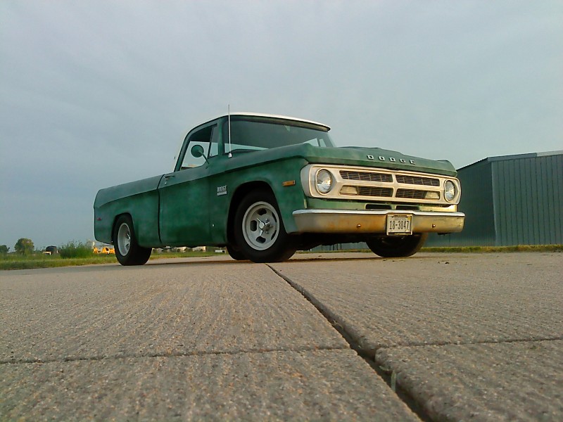

    I am going to shoot some lace on the top of my old pickup.
    My question is;
    Do you shoot some type of spray tack on the lace to get it to lay nice and flat ? Or do you pull it super tight and use low pressure ?
    I need advice for sure before I screw it up.
    My test panel has fuzzy edges because the lace lifted.
    Any help would be appreciated.
